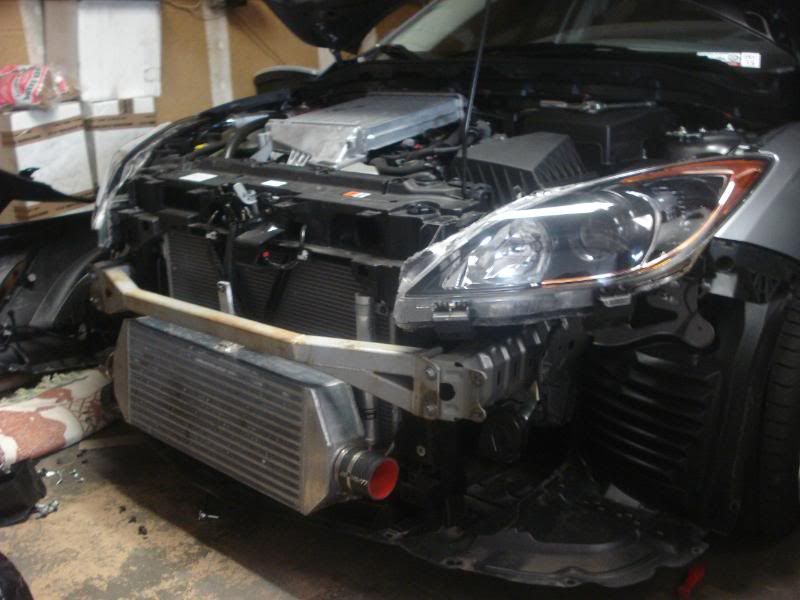

Ultimate Racing FMIC

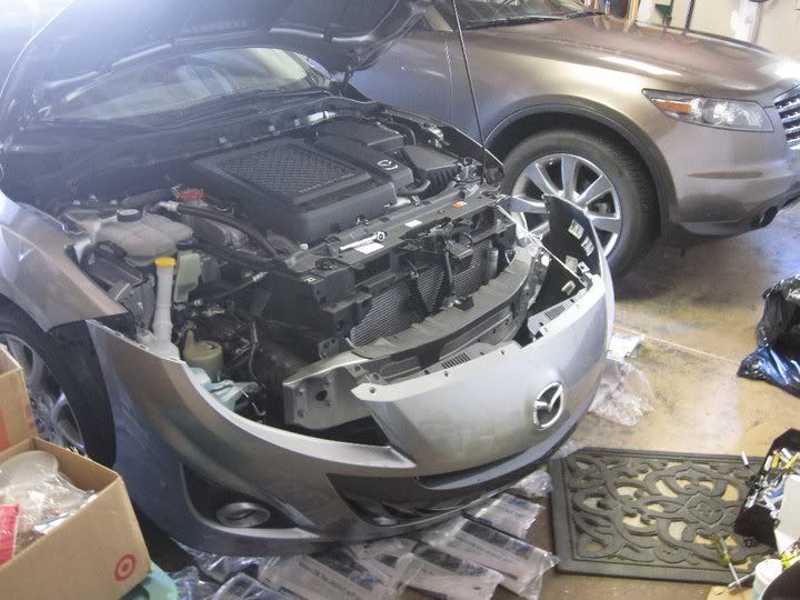

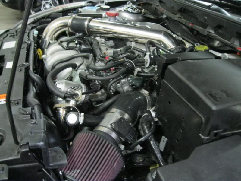

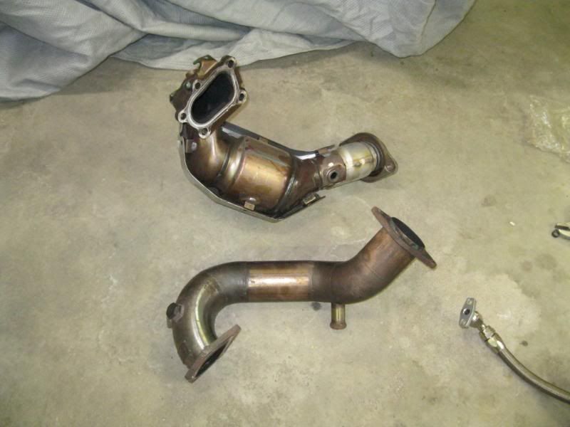

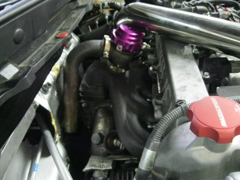

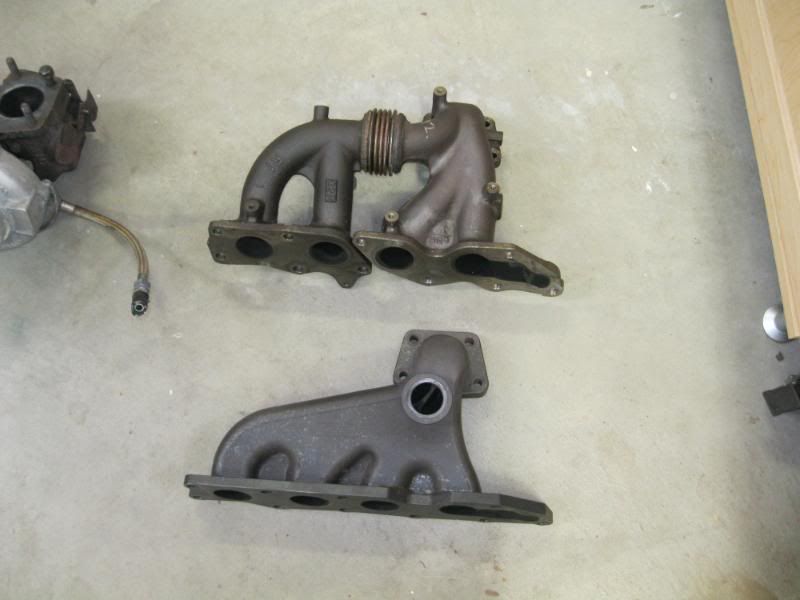

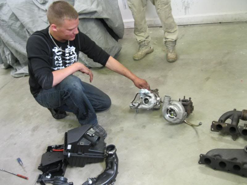

The turbo build took much longer than it probably should have - about 15 hours for the manifold, turbo, downpipe, EWG, and TIP/Intake. I consider myself a pretty good bolt turner, but I was much more careful than I normally am with my cars to ensure each of the stock parts maintained its pristine condition.
It ended up having an oil leak with the stock banjo bolt. Got that taken care of, and now I'm waiting for my tune on the 31st. I will be having it tuned by Revolutions Performance in Colorado Springs.
I haven't gotten on it very hard, but hard enough to open the external wastegate. It sounds very mean! I can't wait to see what it puts down at the wheels, and maybe even see what it does at the 1/4 mile at Bandimere.

Postby erod550 » Wed May 25, 2011 9:14
Aren't screamer pipes usually a bit longer than that? That might melt some shit being that short.

A friend has this same modification setup in his Gen 1 (however, with mostly CP-e parts), minus the upgraded manifold and external wastegate. He was disappointed when it only put down ~320whp, but this same setup I have has been making mid 400whp at lower elevations. I'm hoping the manifold was the big bottleneck; we will find out shortly!
