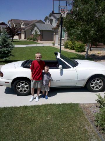

Hi all-
I am back after a couple of years hiatus from owning a Mazda (although I still lurk here frequently!).
I just picked up a little Miata this past weekend- she was very cheap but needs some love.
Stats:
91 "A" Package
Faded white
torn roof/ window
175k
new clutch- yay!!
newer tires
hail damage
left front fender needs replaced d/t an ugly pole hit
nice Alpine HU with Ipod cable- woo-hoo!
Although it does not sound that great, it drives beautifully and does its job as designed.
I am looking for a fender and roof if ya'll have any leads- that would be great!
My boys are really excited about the car- here is a quick picture after our arrival home Sunday...
Happy to be back- looking forward to be back in the group again!
