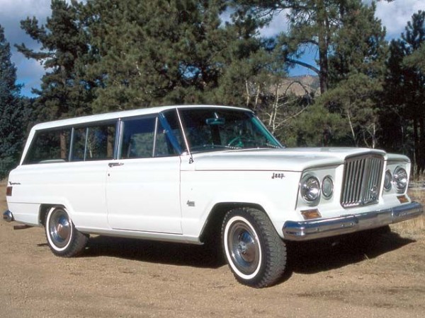

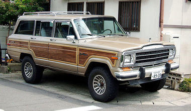

Oh.. one more thing that will put the design in perspective.
Mine looks like the attached photo with a modern grill and woodgrain sides.
BUT the old nose for this grill and lights sits behind it as when updates were made they were low buck overlays. Look ath the attached photo of the older White Jeep with the Rhino nose.
The engineers were probably hurting to budget dollars.
Good Luck on the Skiing and Camping Wagon!
