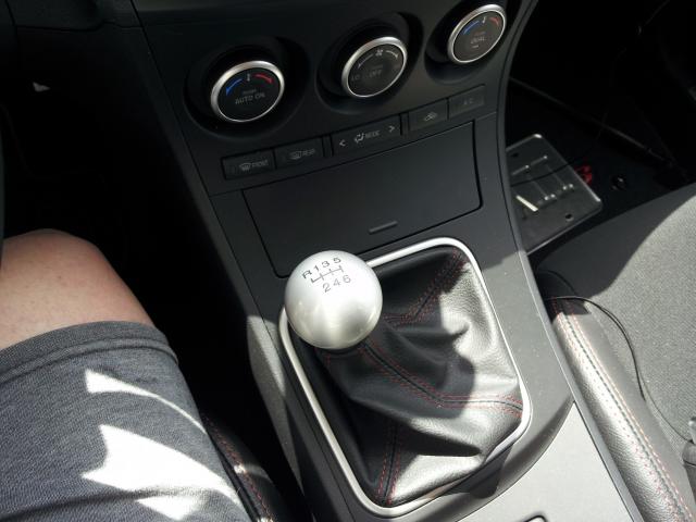

Oh, and here's the first "mod". Engraved Voodoo shift knob. :)

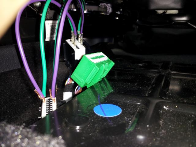

Well, the bypass test worked. I unplugged all the harnesses from the Bose amp, and jumped first the front drivers side speaker and tested it...got sound (seemingly clean sound). Then I decided to add the front passenger speaker and got sound there also. So, in theory, the bypass should work.
However, I will lose the AUX-IN as the bose aux-in plug and the non-bose aux-in plug are different. Unless I can figure out a work around for that as well.
Here's a video of it working...don't mind the narration. lol.
And a pic of the jumped harnesses below.
