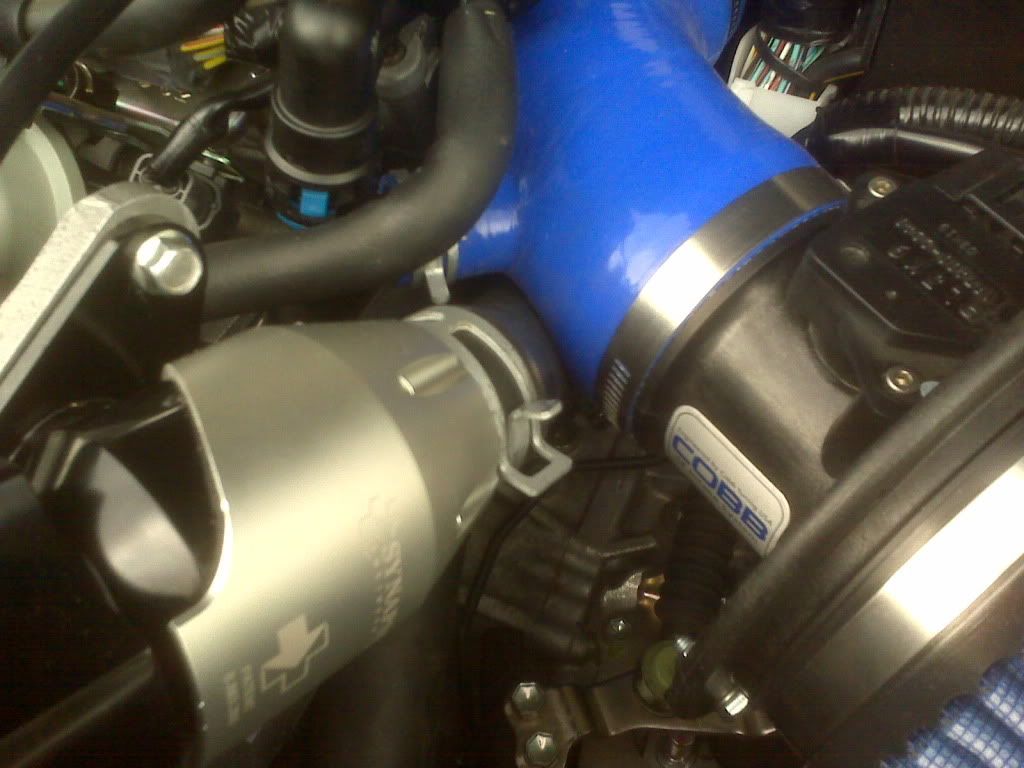

^^ side view. You can see how the recirc hose slides just under the intake hose. I noticed that once the hose gets hot, it does bend a bit...maybe cutting off 20% of the diameter of the hose. I plan on adjusting the mounting bracket for the SRI, and seeing if this will fix it.

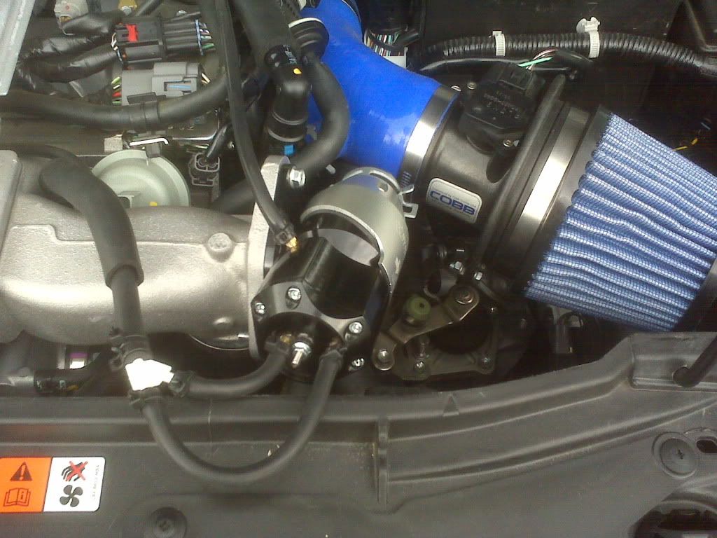

^^ another view of the close proximity of the Synapse to the intake:eek:

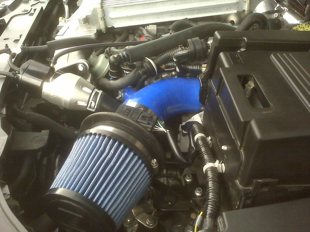

^^ Lastly, a horid picture of the lines going to the two ports on the end. They were better when I left Eric's, but since then I needed to cut and readjust them. However, they don't seem to be getting crimped by the hood, or having any ill effect on the BOV. I have some larger (5mm) hoses on order and will see if I can run the lines to stay within the weatherstripping on the hood.
^^ Lastly, a horid picture of the lines going to the two ports on the end. They were better when I left Eric's, but since then I needed to cut and readjust them. However, they don't seem to be getting crimped by the hood, or having any ill effect on the BOV. I have some larger (5mm) hoses on order and will see if I can run the lines to stay within the weatherstripping on the hood. As of now, I have the TMIC cover completely off. I'm going to either shim it up, so it doesn't touch the third line on the side...or remove some of the cover's material.
