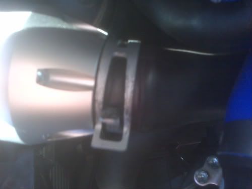

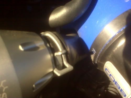

As you can tell from the earlier pictures, there's downward pressure being put on the recirc hose from the SRI, as well as there being a pretty decent decline coming off of the Synapse. I opened up my hood today, getting ready to shave the TMIC cover (finally) and I found one small tear beginning. I don't think it's gone all the way through the hose yet. Upon a closer look, I found a second tear in the tube...this one's pretty severe.
It's apparent that there's just two much pressure on the recirc tube. I'm not sure how well you can see the tear/s, but here's a few phone pics:
In addition to the hose problem, the Synapse is rubbing against my hood. So here's (what I think) the solution is:
1.) I need to adjust the Synapse from its current angled position, to being horizontal. This will clear the hood.
2.) Then I would need to use (2) 90 degree silicone elbows. That way, the hose would come out of the Synapse and go directly down. Then add another elbow going the other way; basically forming a backwards "S". Would this be okay or cause any problems?

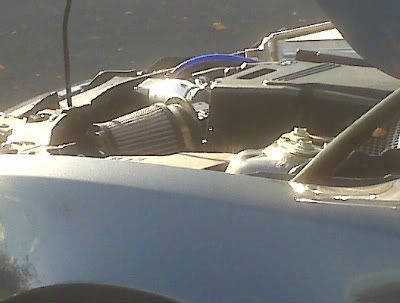

Here's a picture from yesterday. I got everything where I wanted it, but of course the SRI got in the way when fastening everything back in.
I've got another hose with a longer 90 on it...so hopefully this will go under the SRI. I'll give it a go after work-

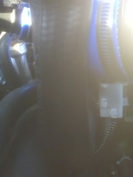

After cutting up the first hose (shown above) I went with the second one; with the longer section after the 90. After the bend, it's about 6+"
You can see just how much of a bend I needed. The hose runs right up against the intake and straight down. I basically pushed the SRI down and it nestles almost perfectly into the curve of the hose.
Here's a view from under the Synapse:
Hopefully the seal will fix the boost issues, because I have everything sitting perfectly!
