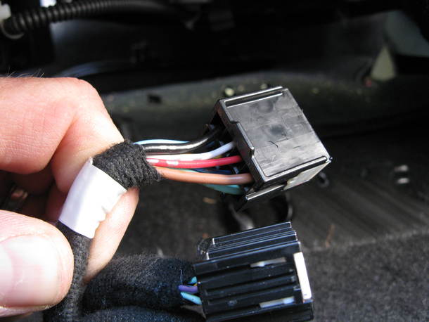

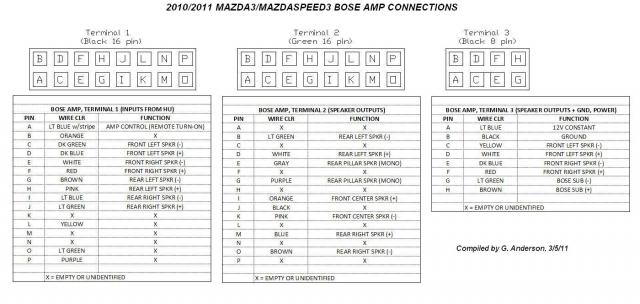

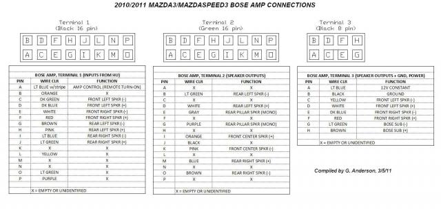

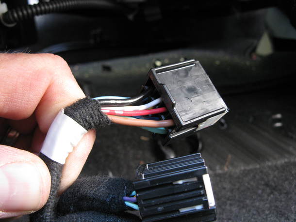

Ok. So I couldn't find a module to work around the Bose (I did find one for GM vehicles, but not for Mazda). However, I did do some searching for a wiring schematic for the Bose system (I will attach below). Depending on how the HU is powered (hopefully NOT from one of the amp harnesses), I should be able to buy reverse harnesses for the amp harnesses and wire them together so it's plug and play and easily reversible.
I have a guy (his SN is svxDC on numerous forums), that I will ask what the harness numbers are so I can order some reverse harnesses and get to work. It may take a few weeks to get it straightened out, but it looks like this might be doable (this is exactly how I worked around the McIntosh system in my old Outback).
I will keep people posted.
