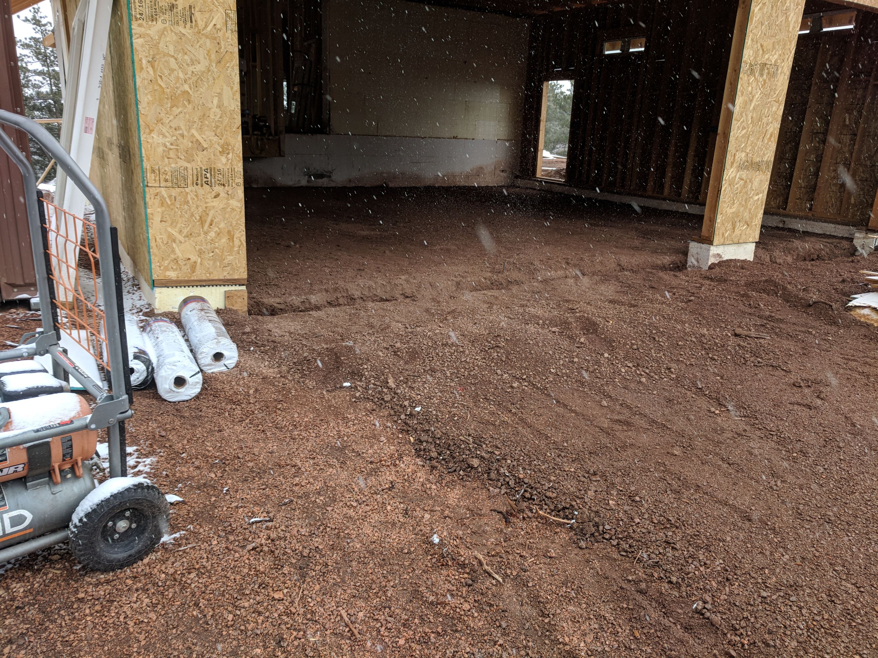

Posted: Fri Apr 06, 2018 9:14
by Dwduc
Its all coming together slowly. Garage slab will be poured on 4/13. Then I can start door shopping. looking for highlift doors and the only thing I can find is conversions for existing doors. I'm not sure if you can buy a setup already designed that way.

Re: A new garage, hope I do it right.
Posted: Mon Apr 09, 2018 9:14
by RX-7 Chris
You can buy the doors setup that way.
