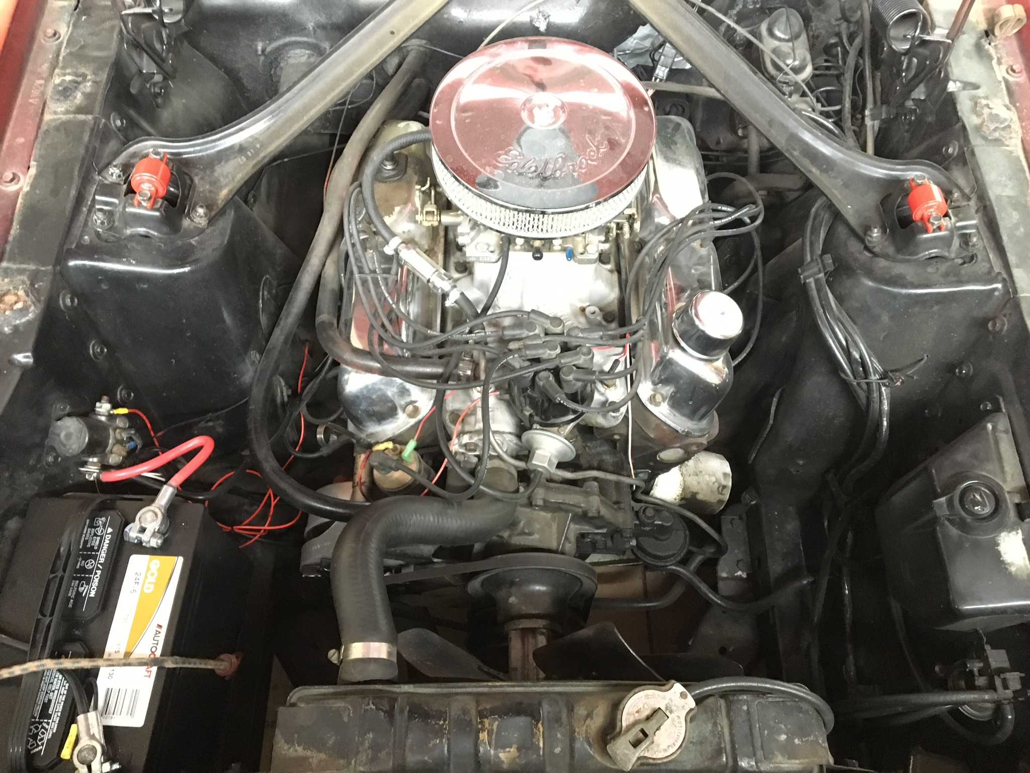

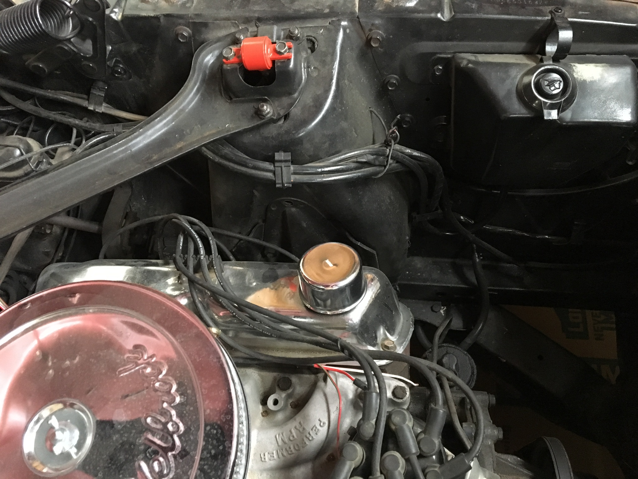

Postby Huzer » Fri Feb 03, 2017 9:14
Chris wanted some engine bay pics. Here they are.

Postby Shadowden » Thu Mar 09, 2017 9:14
Nice. Need to wire tuck that engine bay when it's time!

Postby Huzer » Fri Mar 10, 2017 9:14
All the vacuum hoses on the right side of the engine bay will be gone when I do the electric conversion on the doors. Once I heat wrap the starter wires, it'll be all nice and neat under there.
