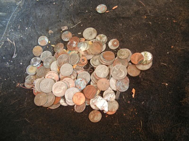

Today, I took the driver's seat out and noticed a metal crunching type sound under the carpet. Ugh, so I pushed on the spot through the carpet, and sure enough...more crunching and definitely some metal moving around. I put my hand under the carpet by the parking brake, and voila! Hundreds of little metal chunks. Probably at least $10 in coins.

This isn't all of them, there are still a bunch under there that I won't get to until I pull the nasty carpet.

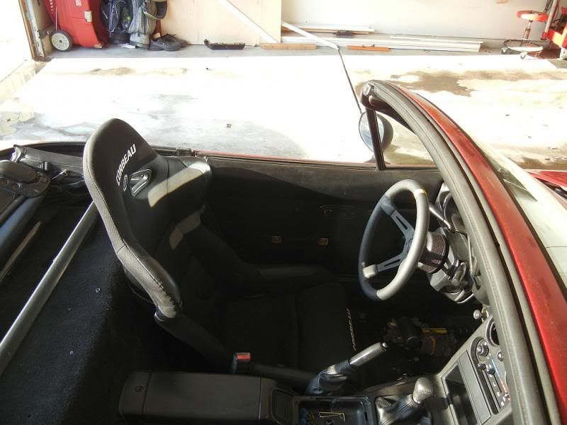

Seat just sitting in there, not mounting until I replace the carpet. The bar behind the seat is the cockpit brace I picked up at the junkyard. It's not mounted. I still haven't decided if I'll mount it or not. I haven't sold myself on a roll bar yet until I get the seat mounted and see what kind of clearance my head will have if a bar is installed.

The foamectomy definitely helped. With the top up, I still have to duck to see stop lights. The Corbeau seat seems to be a good fit. I'm still trying to figure out the best angle to mount it. I really like how much taller the seatback is on the Corbeau. I'll mount the stock passenger seat and snap some pics eventually to show the seat/height differences.
Today, I had to move things around in the garage, so I drove it with no seats. That felt almost perfect, haha! One thing I've done in most of my smaller cars is sacrifice a little legroom for the sake of headroom, and reclined the seat a little. I found also doing the foamectomy on the seatback helped a lot in that regard, too.

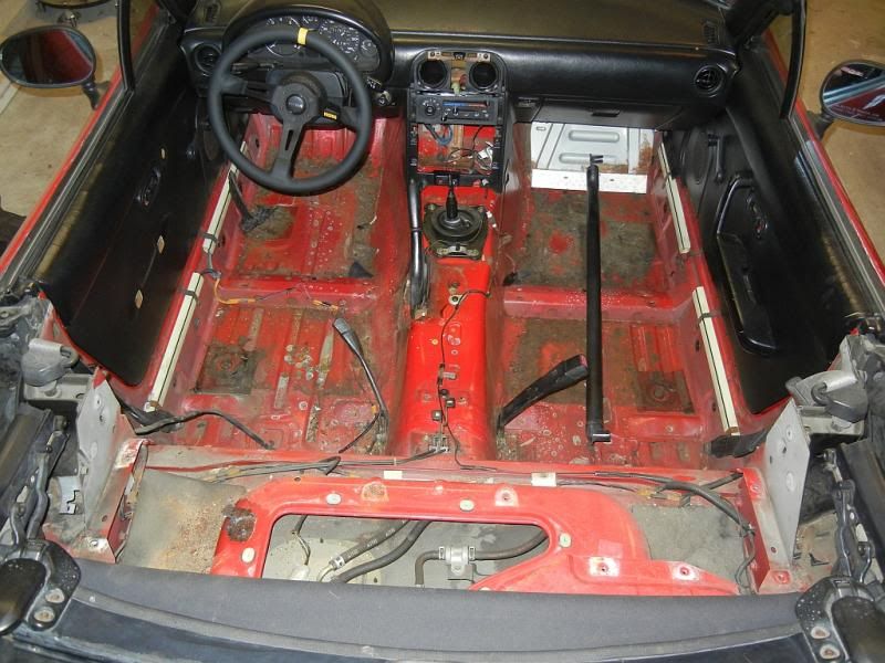

Pulled out the carpet today. Not much more in terms of coins (a couple of bucks) and no rust...other than the parcel shelf that I pulled out. Should be able to find one at a yard somewhere. The crap left is some of the soundproofing attached to the carpets that I just need to vacuum/clean up.
Seats on floor + rollbar = good to go. Test fitted the seat on the mount last night and I was good. For good measure, I'll be putting the seat on the floor, which will give a little bit extra clearance. I'll be going with the Boss Frog Clearview Maxx single hoop bar, as it sits a little further back and retains a little more height than the Hard Dog bars that sit further back. Every inch helps. I prefer not to small my head on the bar.

I mounted my FX1Pros to the floor in the back with front through a small bracket I built that mounted to the stock location. When your done your going to have a FN Race Car. Get that baby out on the track.

That's my plan. I have the PCI bracket that I'll use, since it came with the seat. Front of the mount to the stock location, rears through the floor.
Huzer wrote:This isn't all of them, there are still a bunch under there that I won't get to until I pull the nasty carpet.
$10 dolla holla! wow that's a lot of change

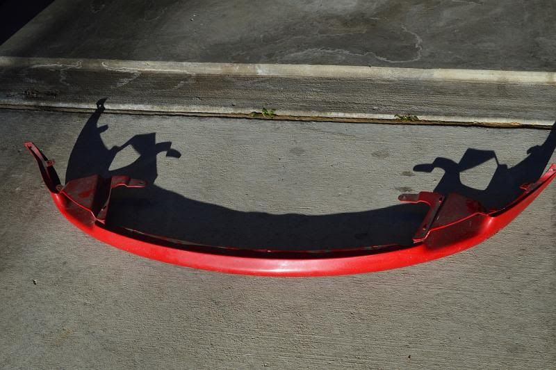

So today I drove up to Erie and picked up:
Two complete doors (mirrors, interior pieces, etc)
Hood and headlight covers
Trunk with "R" Spoiler (OEM)
R front spoiler/lip
Rear Bumper

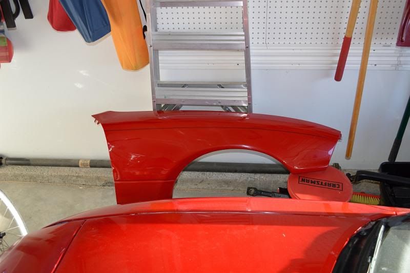

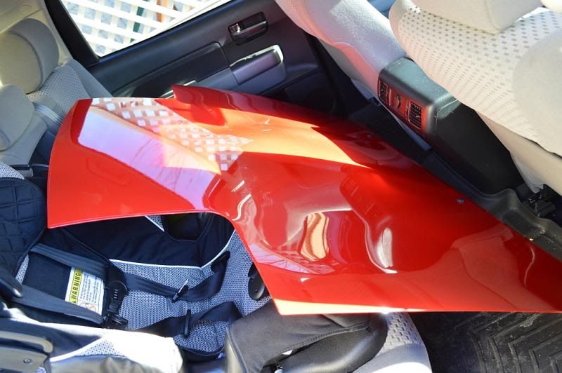

Passenger side fender

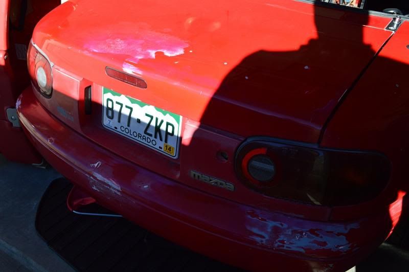

He didn't have a driver's side fender, otherwise I pretty much would've replaced nearly all the exterior. The color match is great, I just need to start polishing the rear fenders again and have some PDR done. Front bumper will need a respray as well. So far, I'll call it the easy man's partial paint job.

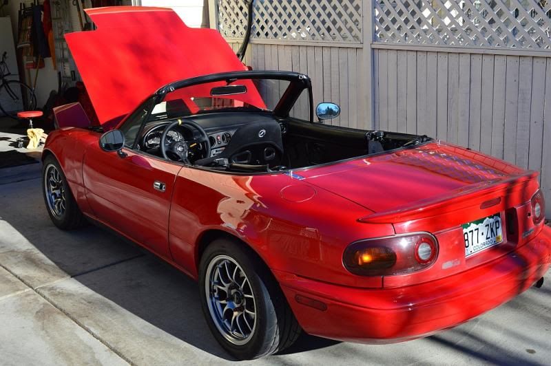

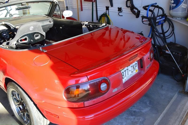

So far I've installed the trunk, bumper, hood, and headlight covers. The latter still need alignment. No pics of the hood until I have it aligned. The hood, covers, mirrors, and fender have a clear bra.

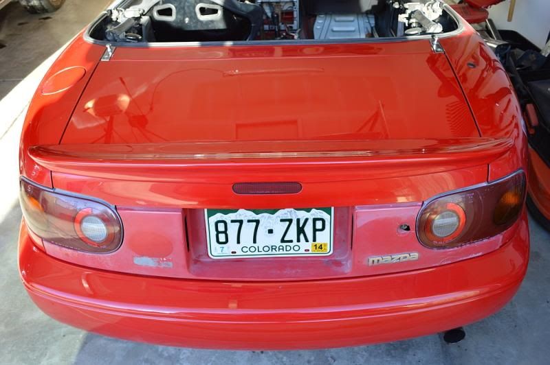

Before:
After:

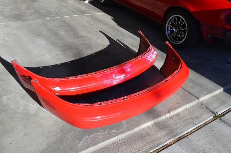

Bumpers:
Other parts:

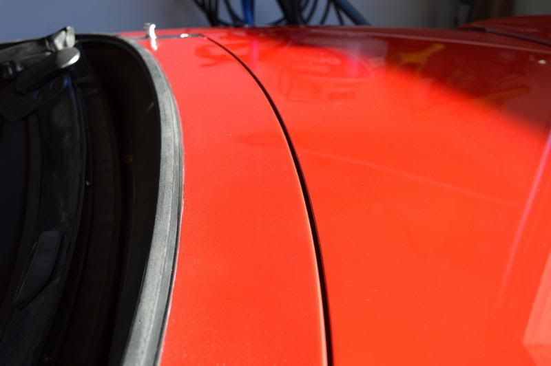

Before:
After:
(I have different plans for the tail lights, so I didn't buy the finish panel and tail lights that he had. The other tails should be here the end of next month, early March.)

A few more pictures...just because I feel like it. Doors/fender still not replaced.
You can kinda see the seat final fitment here. It's bolted in. At first, I found it a little uncomfortable, but I've warmed up to it and like it now. It definitely takes getting used to if you haven't ridden in a race style seat before.
The R front spoiler, obviously not bolted on yet. I like that it's painted, actually. Hard to find OEM front R spoilers, especially for the price I paid. The rear trunk spoiler is OEM R as well. He had the rear lip spoiler available, but it had been cut for a trailer hitch. I have no plans to install a hitch. The front bumper, I scraped off the crappy respray with a razor blade. The bumper will still need paint at some point, but it looks a million times better than what was on there. The single stage paint on the bumper had faded, and the previous owner decided that instead of polishing, they'd just spray over it with clear coat without doing any prep, thinking it would look better. Idiots.
