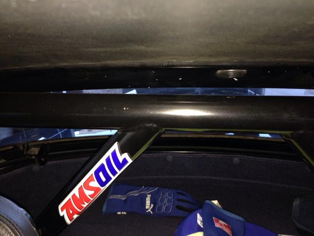

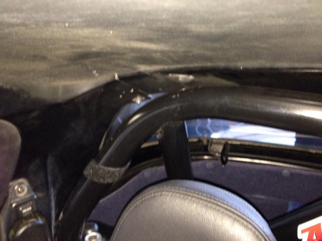

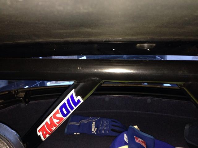

In case you were curious, this is how much clearance you'll have with a HT and/or SoftTop with the Bossfrog Rollbar.
Postby erod550 » Sun Mar 16, 2014 9:14
Pics no worky :\
Saul_Good
Posts: 480
Joined: Sun Jul 22, 2012 9:14
Postby Saul_Good » Mon Mar 17, 2014 9:14
I don't know why it worked but here's another one. I also added one to the original.
