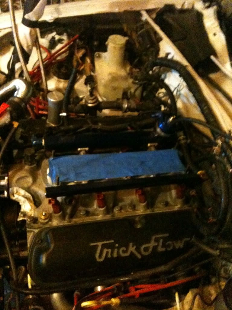

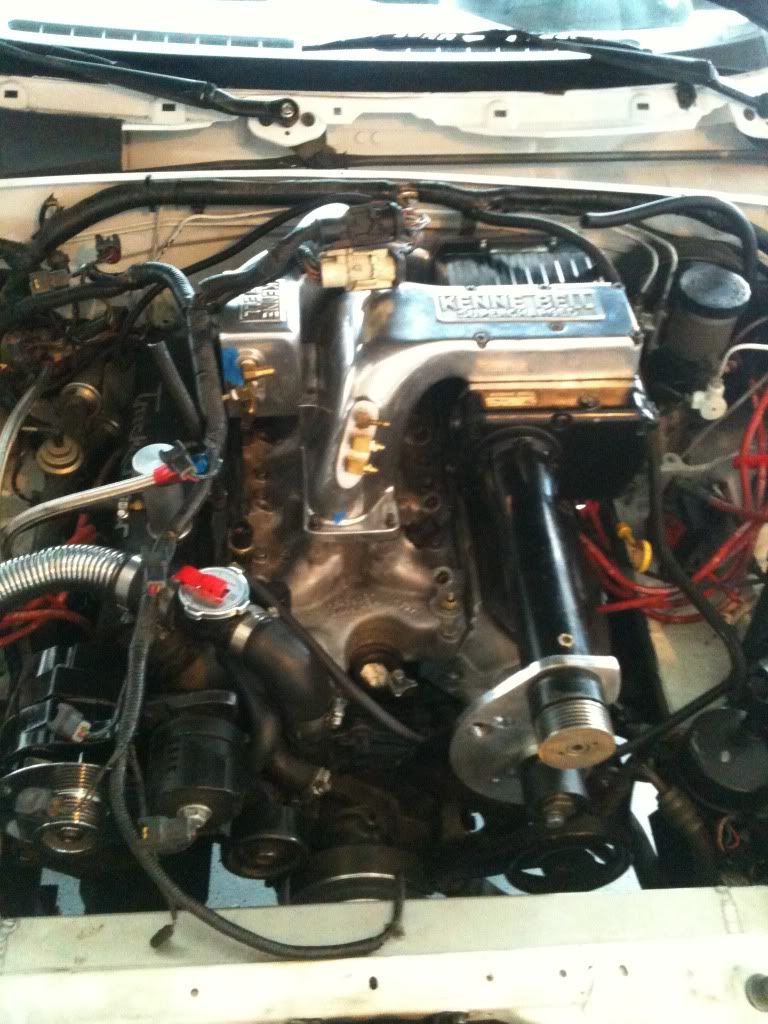

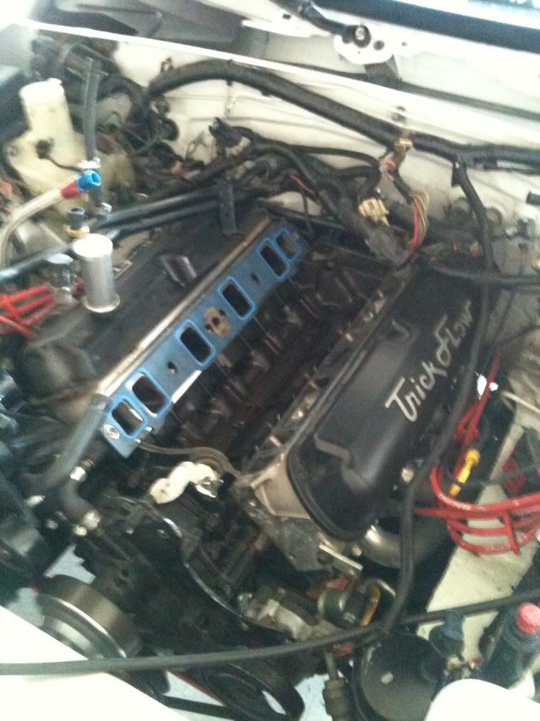

Well I fell like I bit off a bit more than expected. I have ended up needing to buy more parts than expected and will have to cut the hood to install a cowl for everything to fit. I also had to drill and tap two NPT holes for a sensor and coolant return into the lower intake manifold. The GT-40 manifold I had was older and did not have them. The drill bit was a 37/64 bit that cost $27 from Napa and is more for a drill press but did it by hand (what a pain in the a$$).
I then realized that I better upgrade the fuel pump so I don't blow the thing up. I got a DeatschWerks 300lph intake pump made for the Miata and should have no problem feeding the beast.

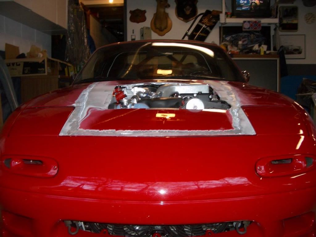

I finished up the intake, got the lower intake cleaned up, installed then did a test fit to see where everything sat. It was very apparent that the stock hood was not going to fit. I could have swore that I saw a fie of the SC V8 Miata's online that were still running the stock hood but that does not look to be the case for me. The front pulley sits up about 1"-1.5 inches higher than the hood and about 2" in the rear. I talked to a guy at V8Miat.net forums and he confirmed you need a cowl (see his pics below).
So now it is time to do the final assembly, get all everything installed and connected to the lower manifold and go to bolt the SC on and have clearance issued with the aftermarket fuel rails and regulator. The Kenne Bell is designed for the stock fuel rails and the only way to go to bigger rails is to go with a 1/2" spacer. I really want to stay with the larger rails 1) because the look bad A$$ but 2) i plan on getting an E85 tune and will need them for the flow. This means that I will know need a larger cowl and am concerned about how it will look. If I go with stock rails, they will not flow enough to run E85. I ended up buying a spacer just to see how high it will sit up and if it is too high will forgo the E85 for the lower cowl.

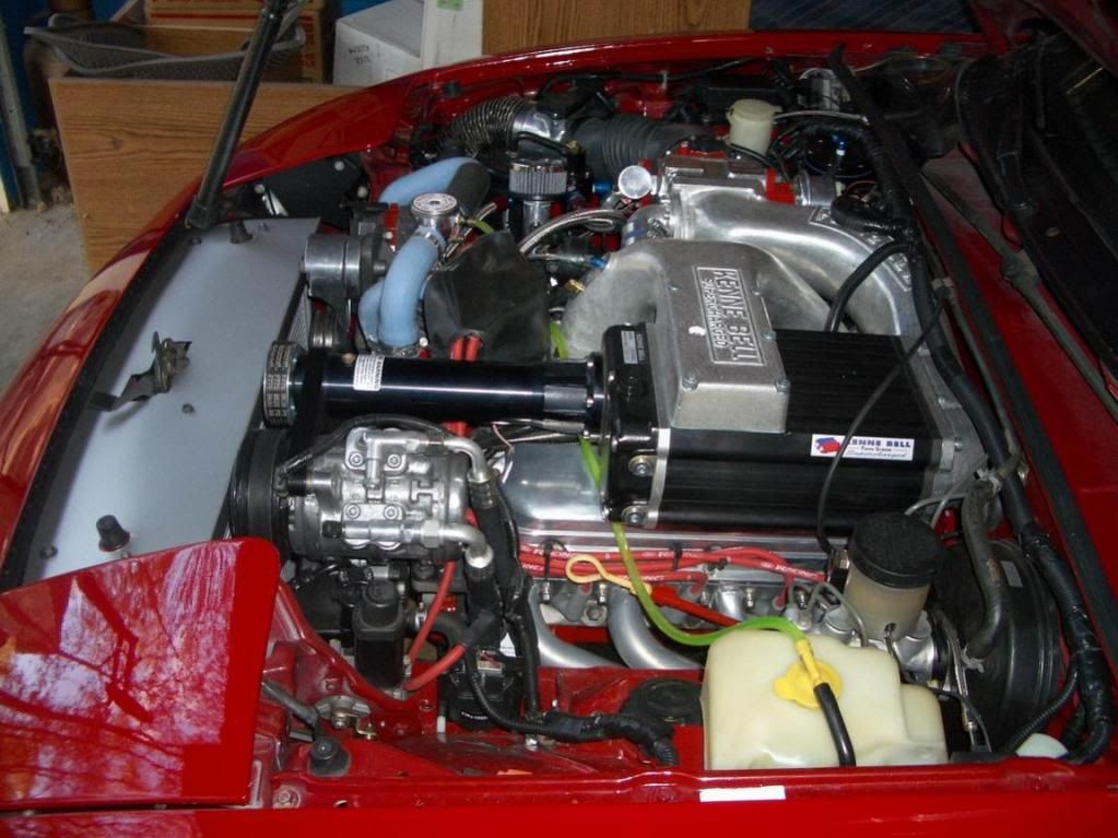

Here are some pics from a similar car and what he did.

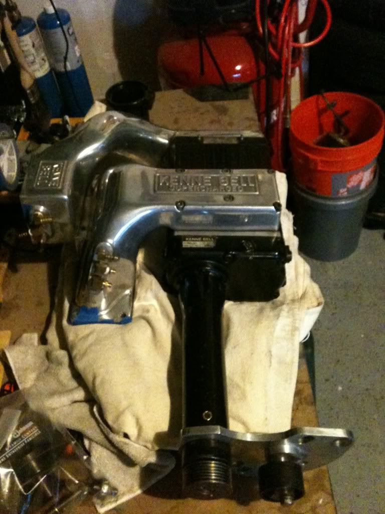

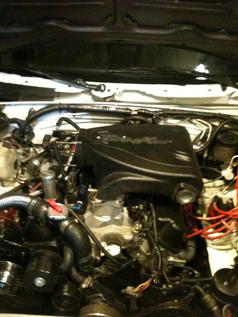

Here are some pics of my progress so far taken on my phone.

I am not quite sure what hood I will go with and will need to see how high it actually sits once the hood is cut. I am toying with maybe not going with a CTS-V or ZR-1 type of hood bulge rather than a cowl but need to see what is out there.
I tried to post up some pics on a prior post of a similar car and what he did but it looks like they didn't show up. I will re-post them to see what everyone thinks.
