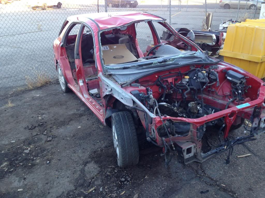

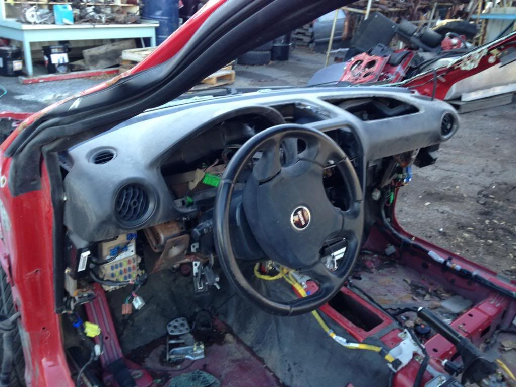

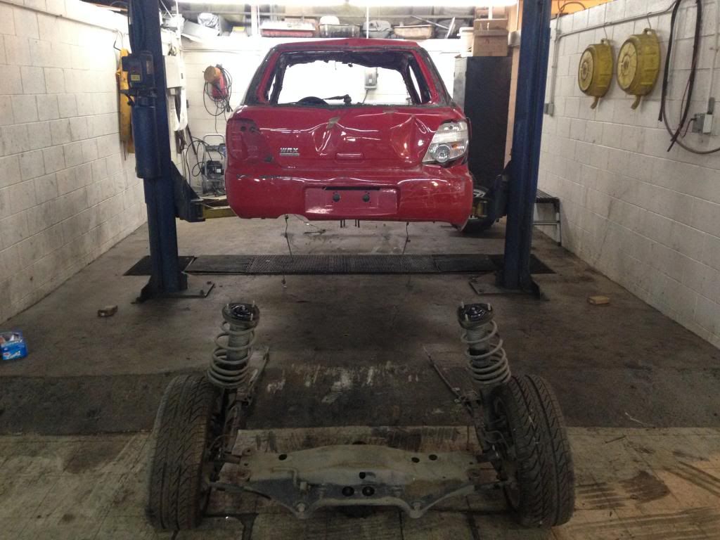

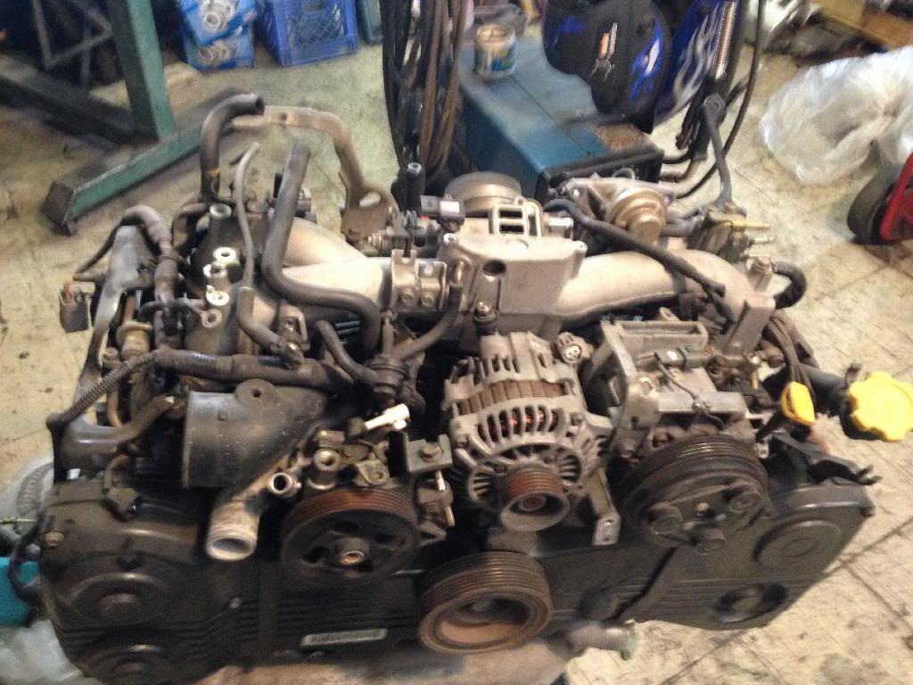

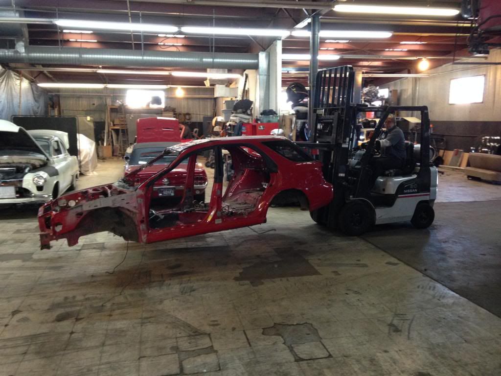

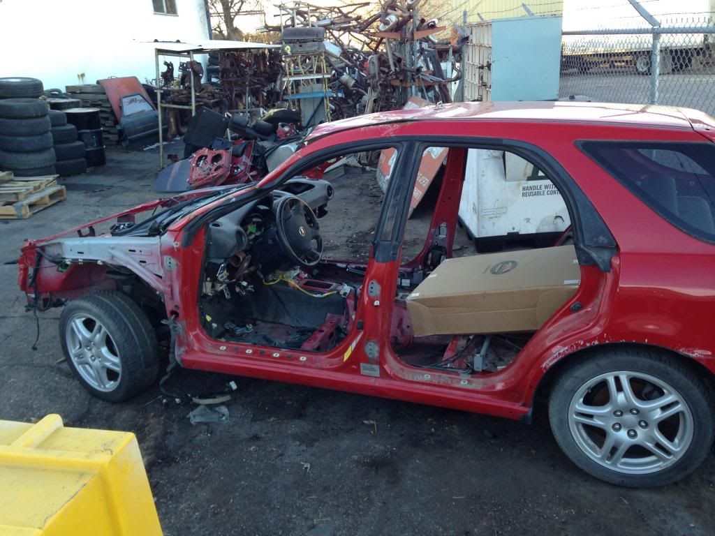

The donor car is completely disassembled. I had a few days off and decited to take advange of them and get'er done. I am always amazed at how much you there is to take apart when you tear down a car. I think I took out every nut and bolt in that car. Now that the parts are removed it is on to getting them cleaned up and painted to go into the 818. After that, it is on to the engine and trans build. Here are some pics.

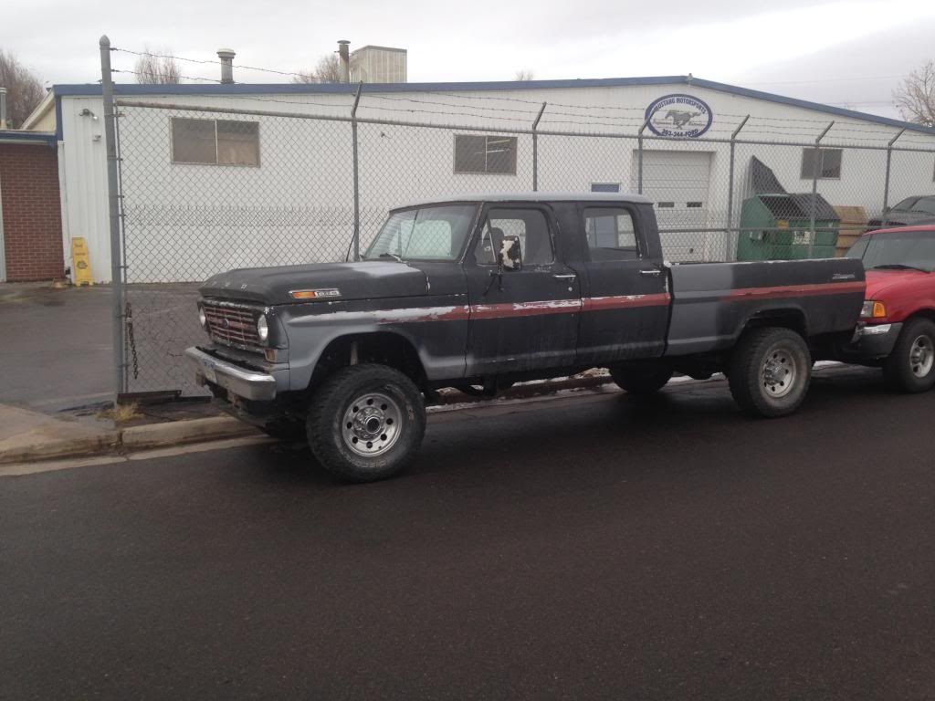

Let me see if the wheels are available. That frame is an early 70's F250 4 door Ranger addition that they did a Cummins swap into. They found a 2002 F 250 that caught on fire and transferred everything to the new frame. The new frame was lifted, 4x4 and upgraded axels. I will take a pic if I get a chance, it is a sweet truck. I love it when old meets new.
If you look in the background of one of the pics you will see the twin turbo LS3 in the 63 Olds.

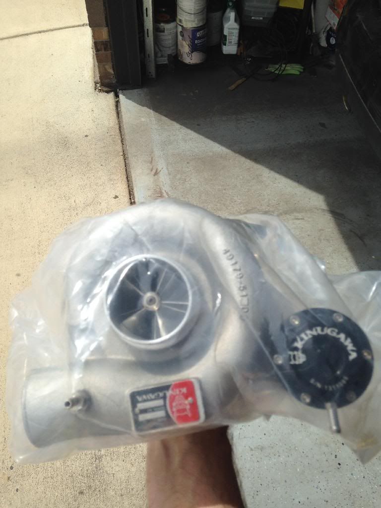

Two weeks ago I tore the old engine down so I could get the heads pulled and shipped out for machining. I dropped the transmission off today to be gone through and to have a Legacy GT gear set and Cusco 1.5 LSD installed. The brake kit, Mishimoto radiator/fan assembly, Clutch, 1000cc injectors, 255lph fuel pump, brand new 2.5L STI short block from Subaru, master gasket set, equal length ceramic coated header/up pipe and turbo are all in. The heads should be back in about a week and then to engine will be ready to come together.
Image\Image
The new 2.5L short block is so small in its little box.
Does this turbo make my hand look small?
