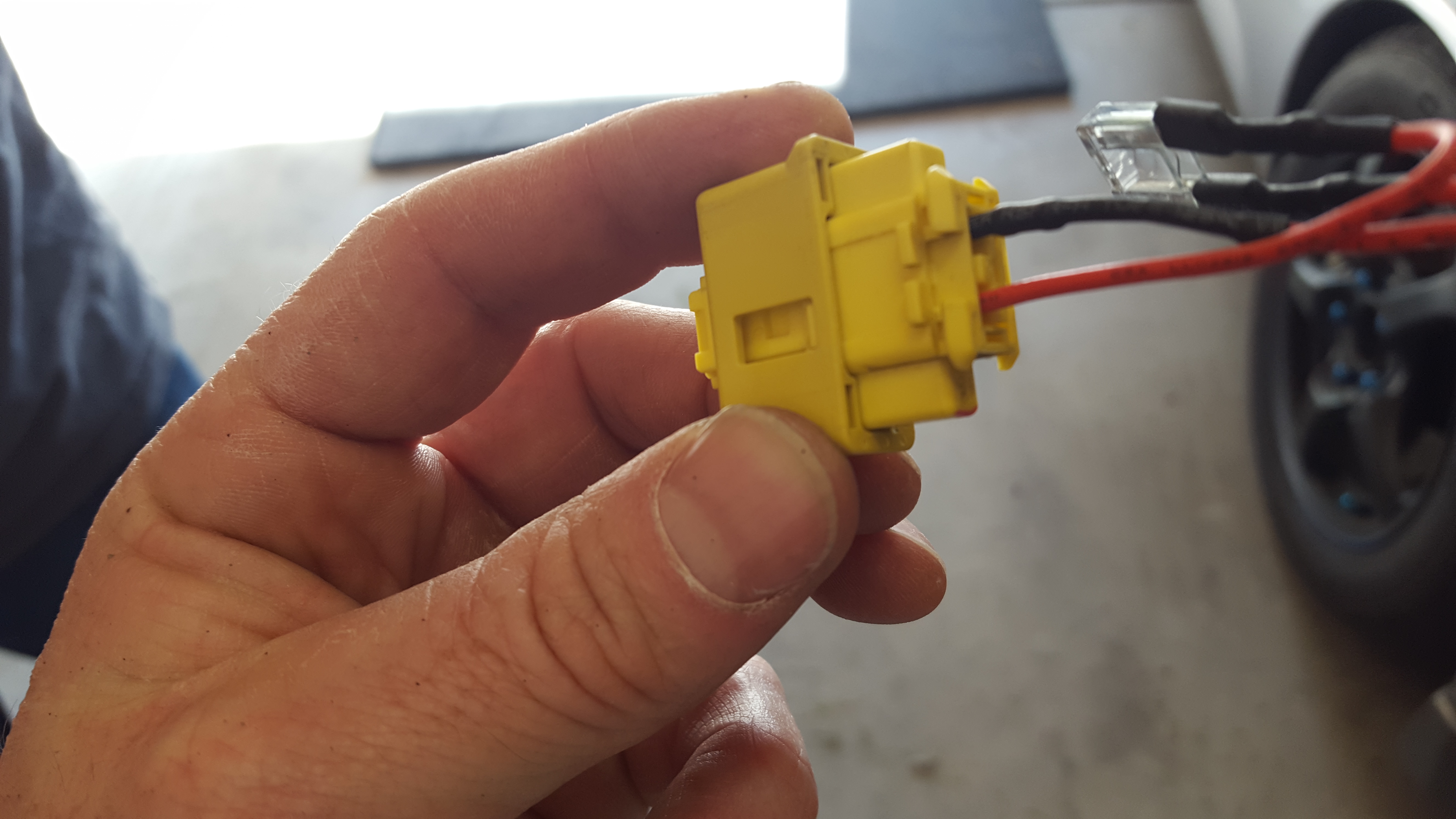

DW is going to upullandpay and grabbing the female half of the connector from another honda. He will solder the NRG supplied resistors to the pigtail of that part. I had forgotten to reconnect a plug, so my SRS light was on until this morning anyway when I finally got the reset sequence correct.
IF that doesn't work, I'll buy a female u-turn from works bell. at 28.00 from evasive, it is a bit spendy for a couple of resistors, but if it connects tightly, I'd be happy.
Re: The S2000
dw successfully created a plug and play solution to "trick" the s2000 into thinking there was an airbag in place. he obtained a female pigtail from a Honda of similar vintage (1997-2000 civic or accord) and re-pinned it using the NRG supplied resistor/fuse. s2000 forum reports say a standard 2.2 ohms 5 watt resistor will do the trick as well, but since we had the resistor from NRG, it made sense to use it.

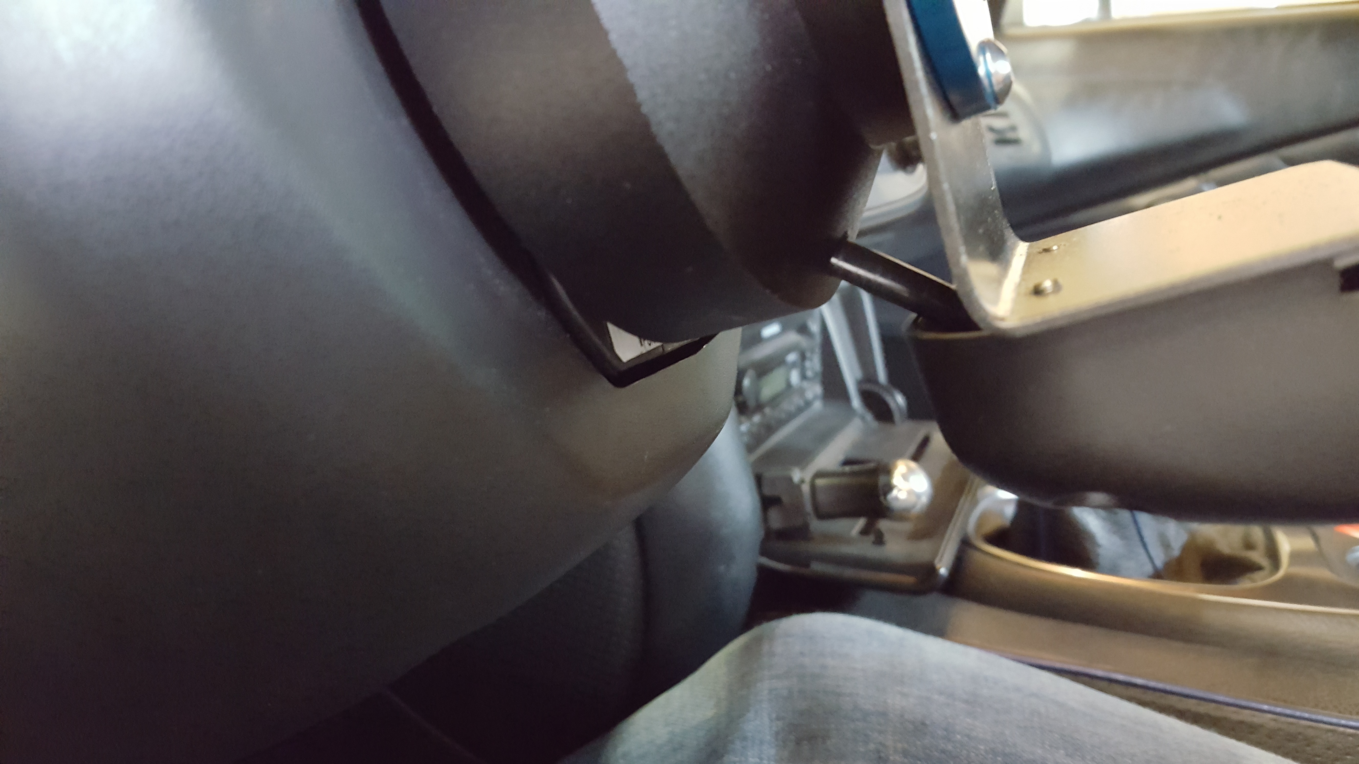

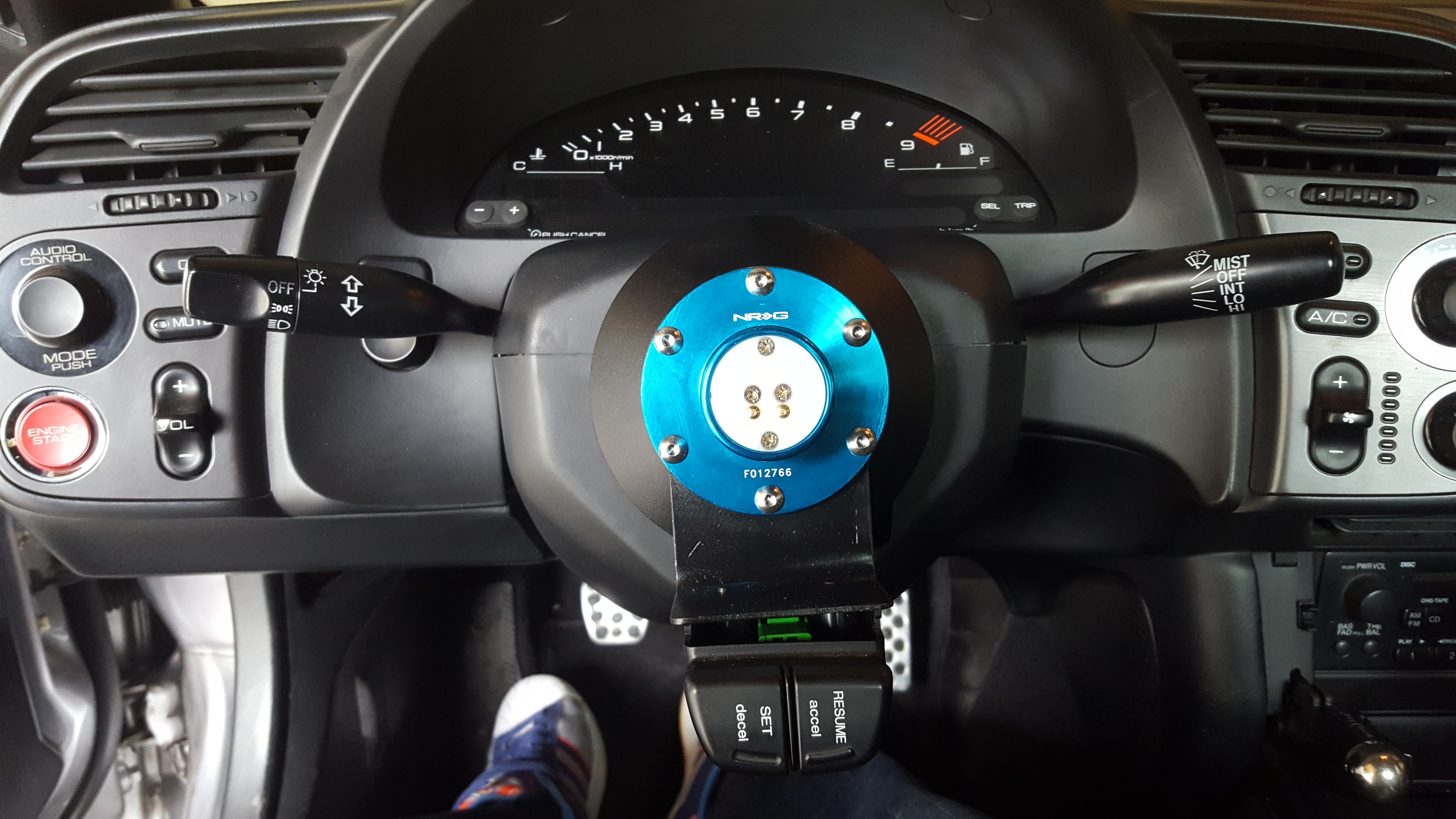

I built a bracket for cruise control that hides the buttons behind the bottom spoke of the steering wheel. it is good for the first attempt and gets everything functions, but I plan to build another one when I have a little more time. to keep the cruise control wire from getting hung up between the short hub and plastics I had to drill a hole through the short hub. using a step drill kept the hole nice and clean. If anyone is curious, the stock screws for the cruise control switch mounting bracket are 4mn 24 tpi.
horn works, cruise control works, and srs light does not come on. draw back is that the stalks are a little further away from the wheel.

The wings on the quick release blocked putting them where they were at. I could pull the wings off, but I only usedid cruise control on one trip when I was driving to Lincoln, NE to swap my transmission out.
I like them hidden there personally. The other bracket I want to make would close off the opening under the buttons more. Realistically, I could really simplify things by just running a couple of momentary switches and wiring them correctly. I like the stock buttons well enough though.

Can you install it so it isn't straight down and maybe 45deg to the right so it can be seen?
Re: The S2000
Not really. It fits perfectly between the wings of the quick release at the 6 or 12 position. The buttons are a little more accessible then they appear in his pic, enough so they are easy to push. I kinda like the stealth look of it other then the cruise buttons now being the biggest obstacle to getting in and out.
