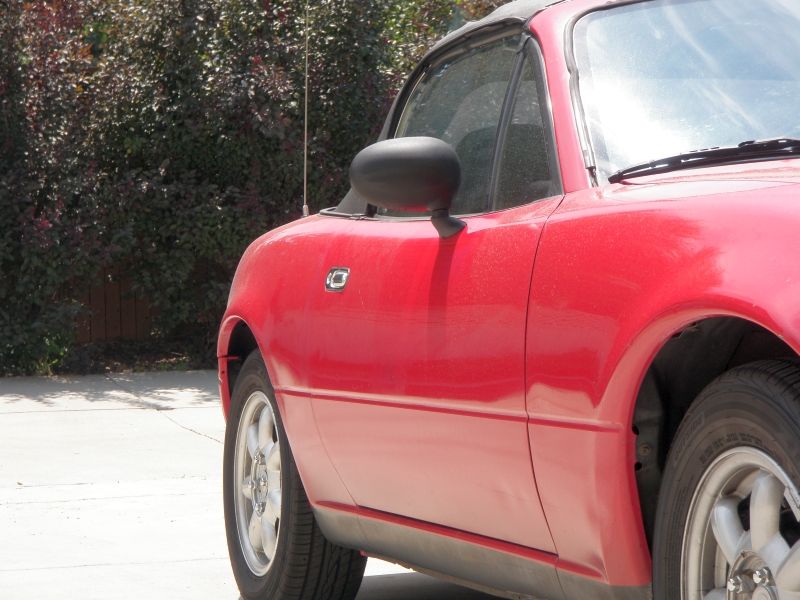

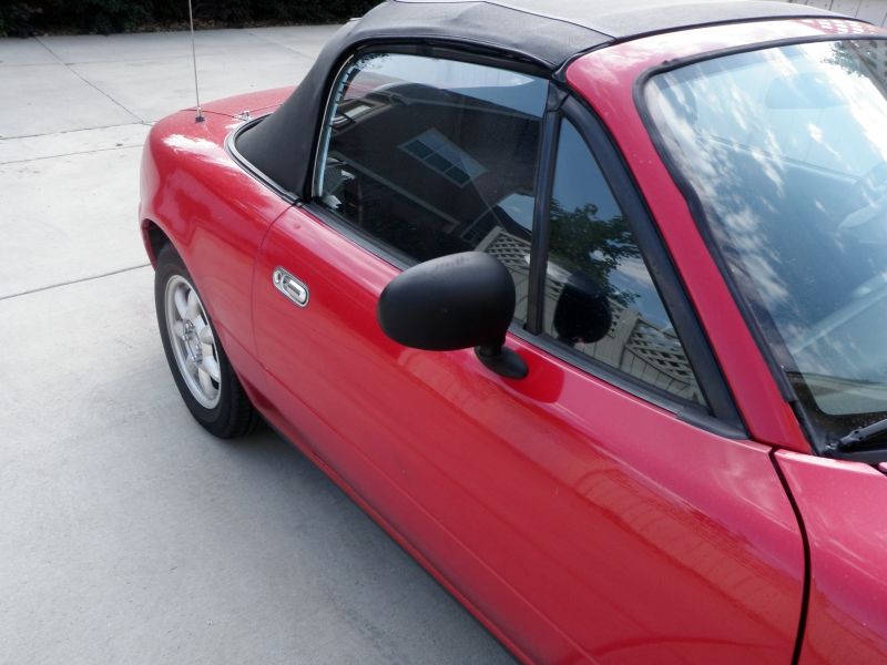

The mirrors looked like crap, so I dipped them today. They look better-ish than the mirrors did, but I'm not a giant fan. They'll get painted body color when I get the car painted. Pics when the blinding sun sets a little bit.
Before:
