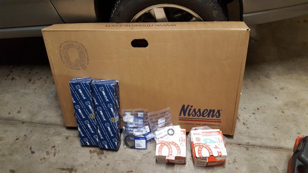

My parts came in early, I got them on Saturday. Now I need to find the time to install them.
Front Wheel Hub Assemblies - FAG 274378
Sway Bar Link - Meyle HD 31212730
Transfer Case Input Shaft Seal - Genuine Volvo 30735126
Fuel Pump Tank Seal - Genuine Volvo 9447179
Drive Axle Seal - Genuine Volvo 9143885
Turbocharger Oil Line Gasket Lower - Genuine Volvo 31251439
Turbocharger Oil Line Gasket - Genuine Volvo 31251456OE
Radiator - Nissens 8601356
Spark Plug Set - Genuine Volvo 8692071
