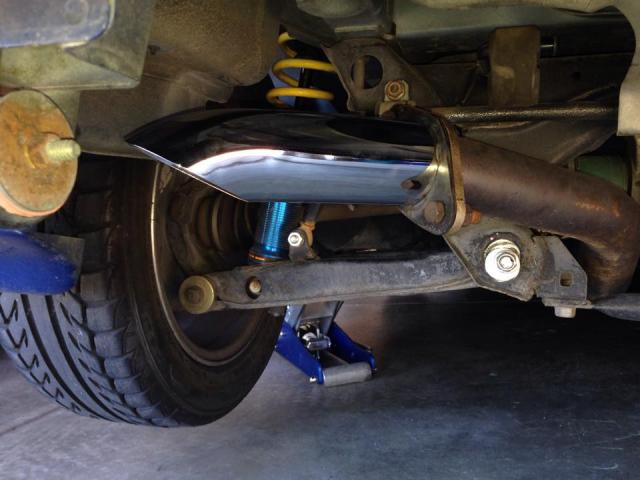

Little project for Saul.
Started with some plate and cut out a thin flange:
Cut a hole in it big enough for the exhaust tip Saul provided (he bought one way too big cuz he wanted that aggressive look).
Put the pipe thru the hole with a slight down angle to prevent bumper melting and welded the backside. Ground the weld smooth so it should seat up well. This step was a little difficult, the pipe tip was very very thin and almost all chrome, the weld puddle was a little hard to control.
Weight of his old stock muffler 16.6 lbs according to my bathroom scale:
Weight of the delete tip <1 lbs:

Nice work! You did a great job getting that flange opening smoothed out and clean. What wire are you running in your mig? I'm running 0.023 so it is supposed to work a little better on thin material. The chrome finish is definitely a hurdle to overcome.
Great functional piece completed.

Postby Saul_Good » Wed Nov 05, 2014 9:14
Can't wait to try this out! 15lbs weight savings, whut!?
Postby Shadowden » Wed Nov 05, 2014 9:14
Saul_Good wrote:Can't wait to try this out! 15lbs weight savings, whut!?
And less exhaust restriction!

Got this thing on today. It's friggin loud.
http://vimeo.com/112577428

Chris, It's ok if it's loud. I will only have this on when at the track -- gotta shave that weight! :P I've already got the muffler back on the car. It's a pretty quick swap.
I was unable to get recordings going 4500+ rpm but it actually sounds better (still loud) at the higher end of the tach.
Postby Shadowden » Mon Nov 24, 2014 9:14
Saul_Good wrote:Chris, It's ok if it's loud. I will only have this on when at the track -- gotta shave that weight! :P I've already got the muffler back on the car. It's a pretty quick swap.
That is how my T1R cat back is. It's pretty in vtec.
You had mentioned lugs before, but those look like through bolts. Can you exchange with the car on the ground? Probably doesn't matter since you will have it up changing wheels/tires anyway.
