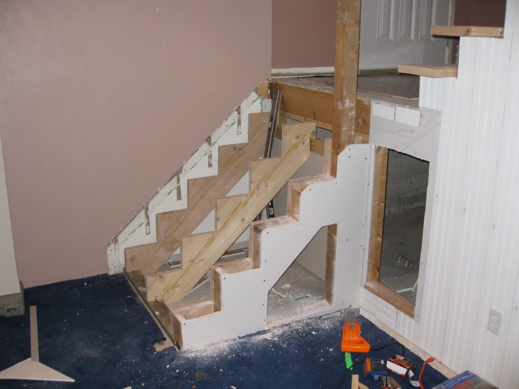

Made some good progress. We removed the one set of stairs. I installed the new stringers, rebuilt the wall under the stair, reinstalled the electrical, and did a bunch of cleanup. Installing the new stringers was a nightmare because they didn't have anything to hook to. I will post some pics this week. We also started to paint the risers and finished stringers.
This week I will start installing the sheetrock, than the beadboard.

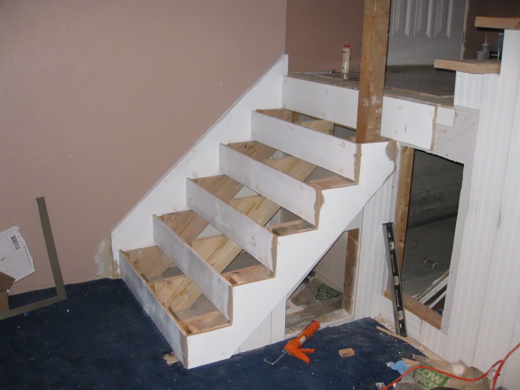

Here are the next two steps I took:
The next step is to paint everything I have installed. Then I will install the newel post and treads.

Postby RX-7 Chris » Thu Jan 20, 2011 9:14
I am moving slow but that's what it takes when I only work on it one day a week. The risers are pine risers from home depot. The decorative stringers are masonite. I figured pine would be better than something like masonite for the risers since it has the posibility of being kicked.
Postby kingtut » Thu Jan 20, 2011 9:14
You going to paint the pine then?
What are the treads going to be?
The pine will be painted white. The treads will be oak stained early american and finished with a high traffic floor finish. The newel posts and hand rails will be natural oak with a tinted finish to make the grain pop. the balusters are square and are painted white.

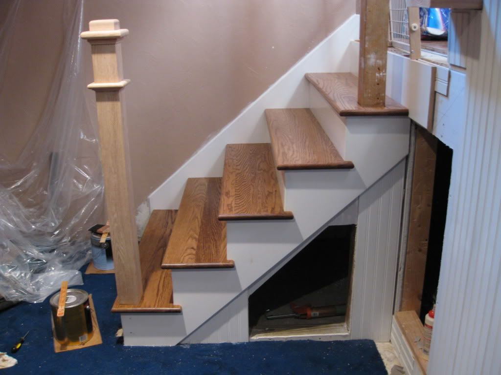

Postby RX-7 Chris » Mon Feb 14, 2011 9:14
Here is my updated Picture:
I have a light sanding and one more coat of sealer to do on the treads. Than I have some painted cove molding to install under the front and side edges of the treads once they are cured. I have to wait a minimum of 3 days before I can use the stairs. I will get the tread santed and sealed tonight.
