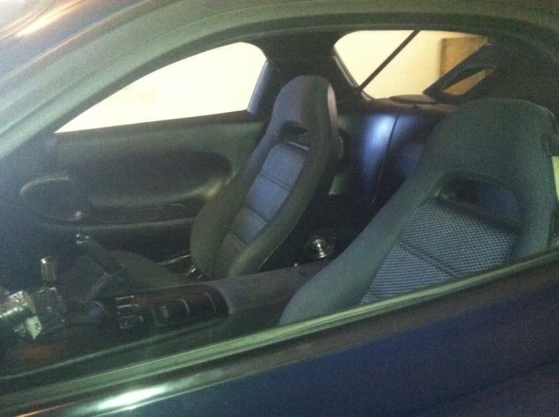

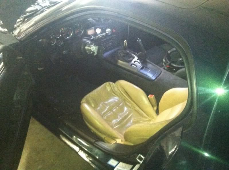

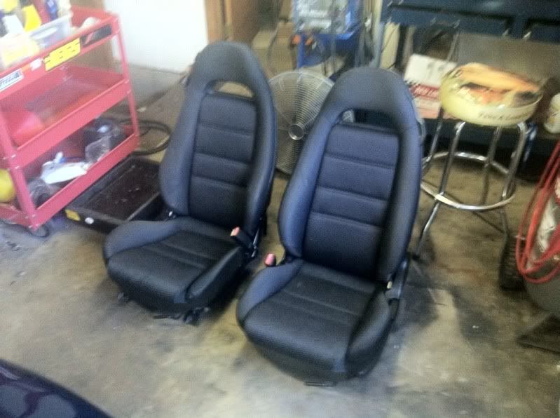

New seats, courtesy of Ryan95 (thanks again bud!). They are from a JDM FD, so they are a little different. Mostly the US driver side (JDM Passenger side) has a level near the top of the seat so the JDM driver could flip it forward. It's rather pointless for US cars put I found it nice to use it instead of the standard lever on the side to adjust the recline of the seat. Anyways, on to pics:
Threw 'em in the car today:
I LOVE LOVE LOVE cloth seats over leather in a car without air conditioning!! I felt so much cooler when I took the FD for a spin...no more "peeling" myself off the leather. The cloth seats were a great addition, plus they are black so my interior is now 99.9% converted to black, only missing black seat belts, which I plan to pick some up soon.

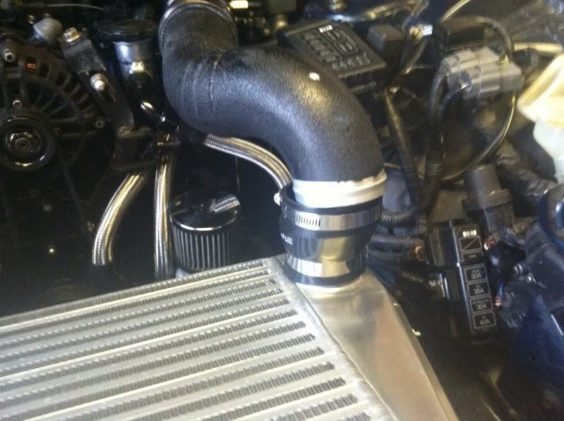

Speaking on boost, I also cranked up the manual boost controller to get a solid 15psi to redline. After driving today and quite a few boosted pulls to ensure everything was good, I was headed home and did a quick 2nd gear spurt and I heard on odd noise and power dropped off dramatically. GREEEEEEAAAAT. I clutch in and it idles perfectly at 1000rpm pulling 14" of vacuum, so it's not blown. I drive the rest of the way home, car refuses to boost anymore...
And yup! Blown coupler. Apparently this connection wasn't 15psi ready. Damn I need to get some t-bolt clamps!
Postby speedjunkie » Mon Sep 10, 2012 9:14
With the lip on the pipe I'm really surprised its popping off.
Postby chickenwafer » Mon Sep 10, 2012 9:14
Yeah, I was too. The pipe is beaded, I must of not had the clamp tight enough.

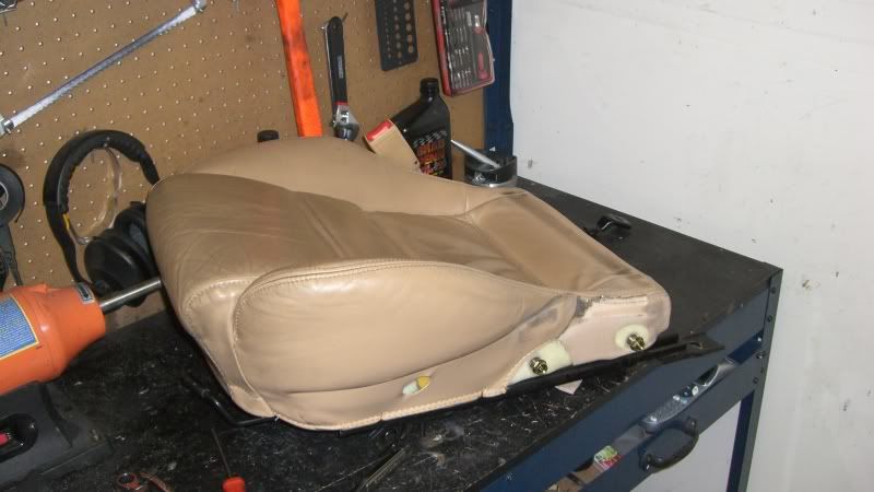

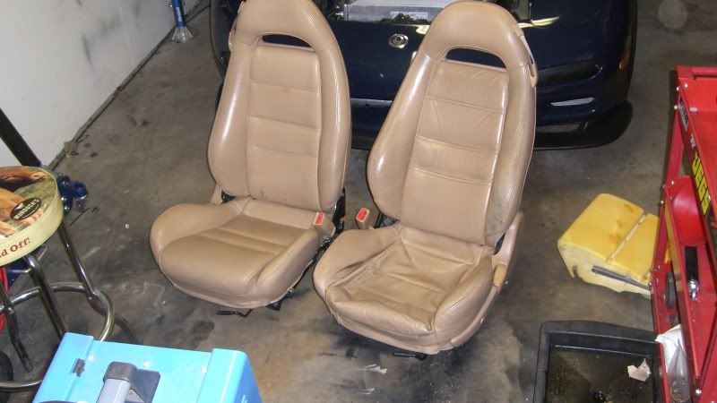

Postby chickenwafer » Tue Sep 11, 2012 9:14

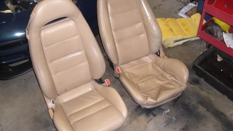

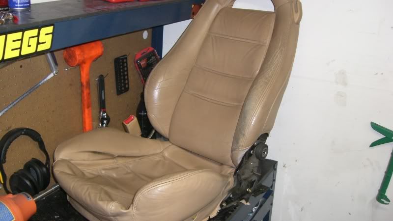

So, with my stock tan leather seats out of the car, I decided to cannibalize/modify the drivers seat to see if I can eek some more headroom out of it. My first thought was to see if I could lower the rails any...um, nope. The bottom of the seat already sits on the floor. Literally zero room to lower the seat.
Next option is to remove foam off the chair bottom...I measured it and there is plenty. For reference here is what I'm starting with:

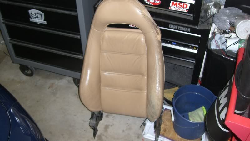

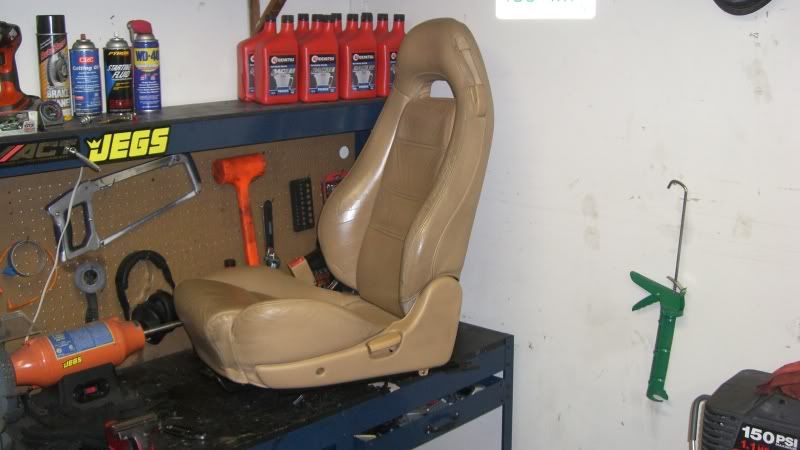

Stock chair:

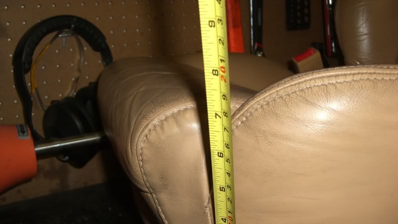

And measuring the foam:
You can see just a little over 7 inches of foam up front. Then, I sat in the chair and measured from the floor to the top of my dome. 40.5 inches for a starting head height.

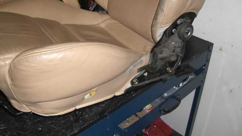

Okay, time to get to work. I first removed the side plastic piece:

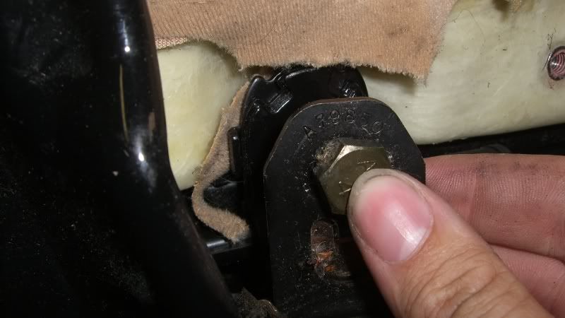

Next are four bolts, two per side (those two gold colored bolts in the picture above). The outside are 14mm and the inside bolts are 12mm. I also removed the seat belt clip bolt, which for some reason is a 5/8" or some weird metric size I don't have haha.
What you end up with is this:

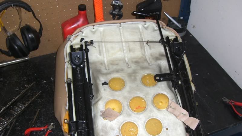

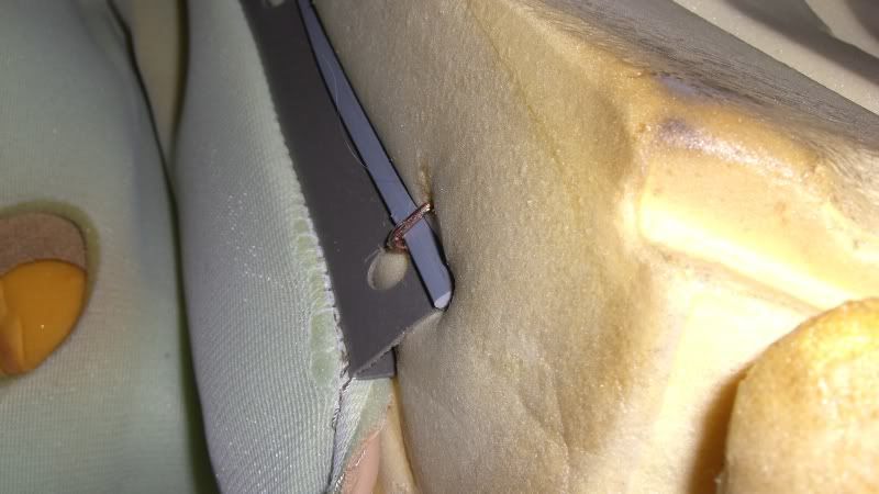

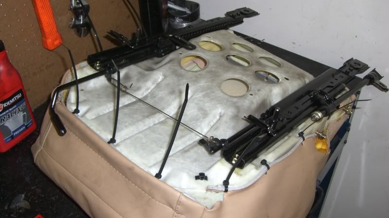

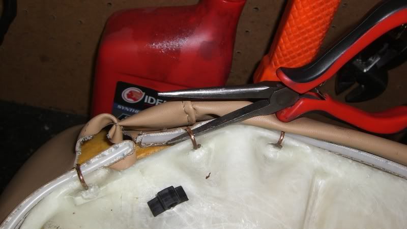

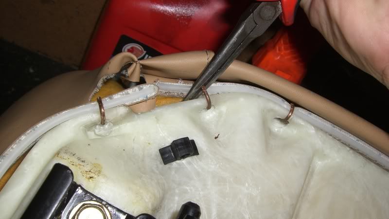

Then flipped the seat over to remove the hog rings that hold the leather skin in place:
I first tried cut them with some dykes, but this didn't work well. They are quite tough. I found out using a pair of needle nose pliers and rocking them under the hog ring and pulling up removes the rings apart and out, like so:

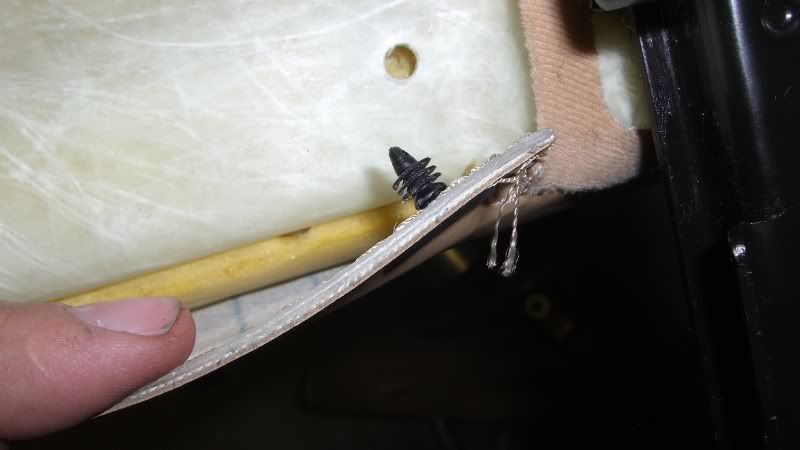

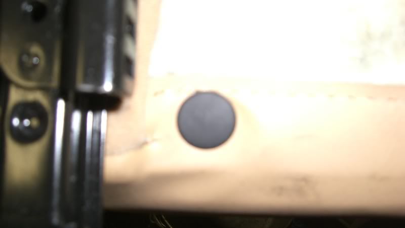

Then there are also some black plastic rivets in the back of the seat securing the rear of the leather skin. I used the needle nose and rocked them under and up to remove these as well:

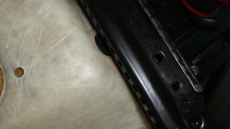

There are also two hidden rivets under the seat rails, which are impossible to remove without removing the rails, so I cut the fabric that secured them with my razor:

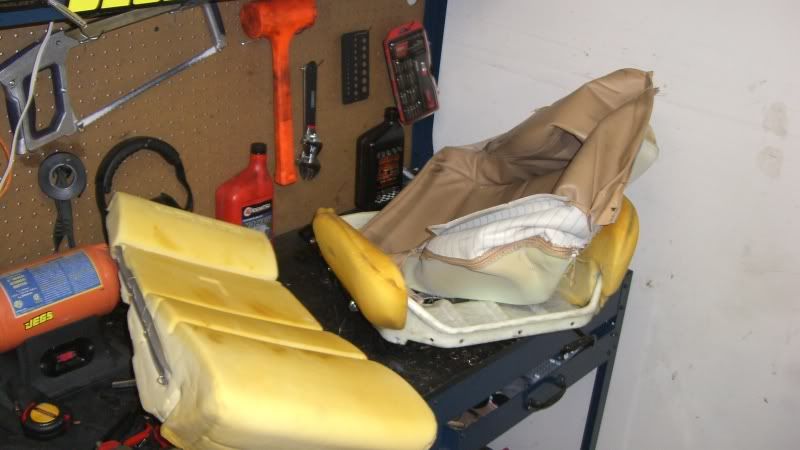

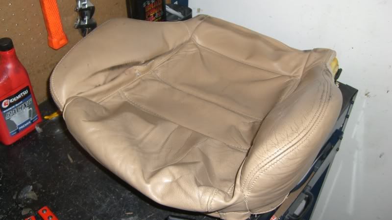

Then start peeling the leather off the foam:
And the bottom of the seat:

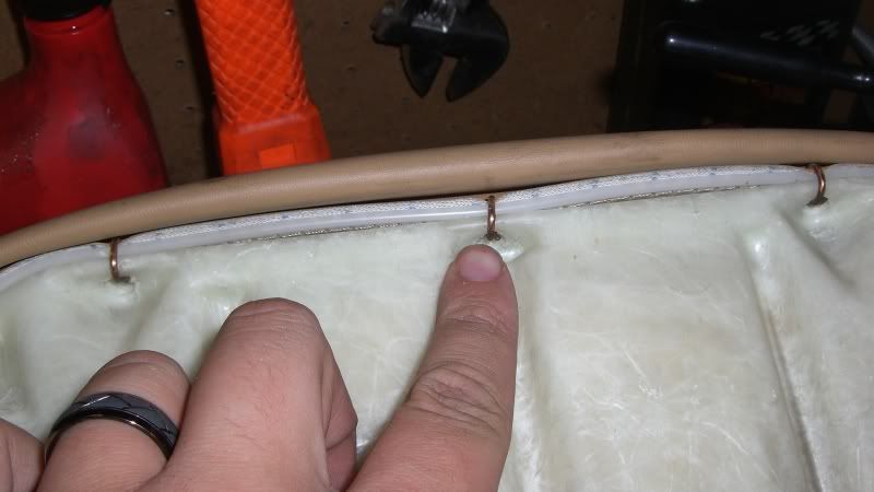

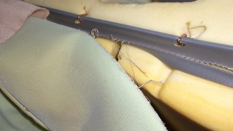

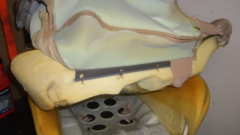

The leather is then secured to the foam with more hog rings;
These are much more tricky to remove since you can push against anything, so I just ripped the piece off at the seam since I no longer need the foam:

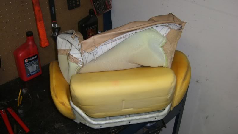

And separated:

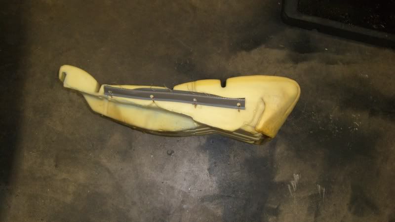

This is the foam piece that gets removed, hellllloooo headroom!

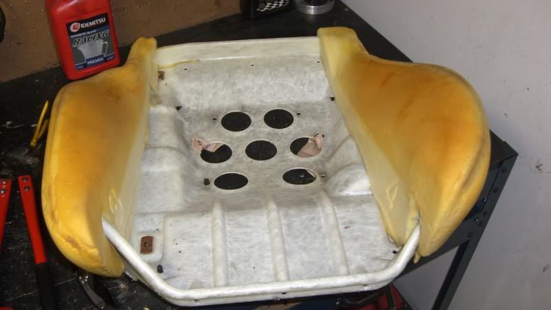

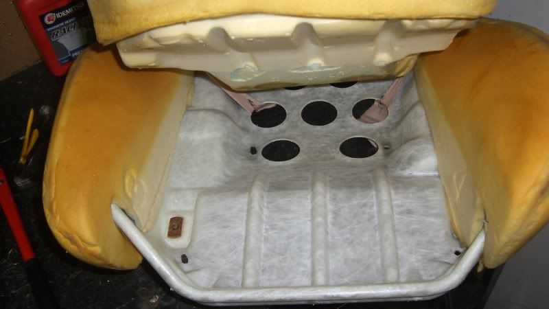

And the bottom of the chair you're left with:

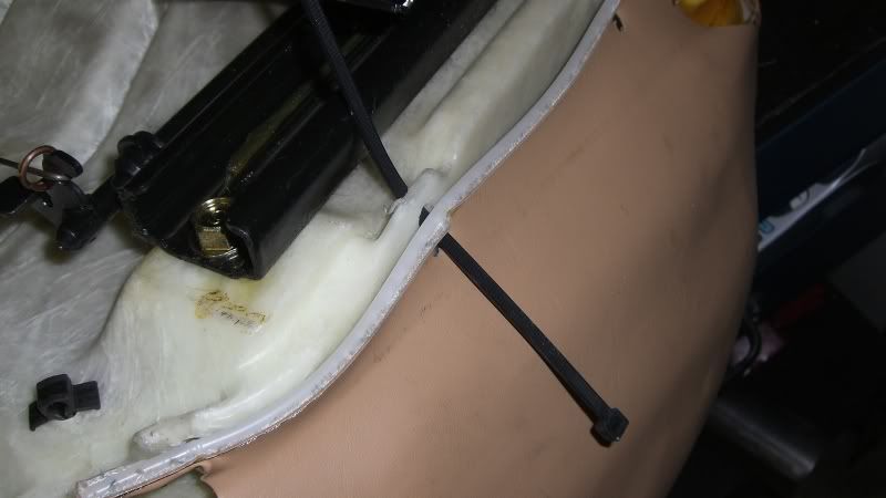

Now this isn't too comfortable to sit on just by itself (yes I tried it) so I elected to put the leather skin back on:
I didn't have any hog rings, so I used, what else? Zip ties!
All the zips on ready to be cut:
Then it's time to but it all back together. Don't forget the seat belt clip bolt:

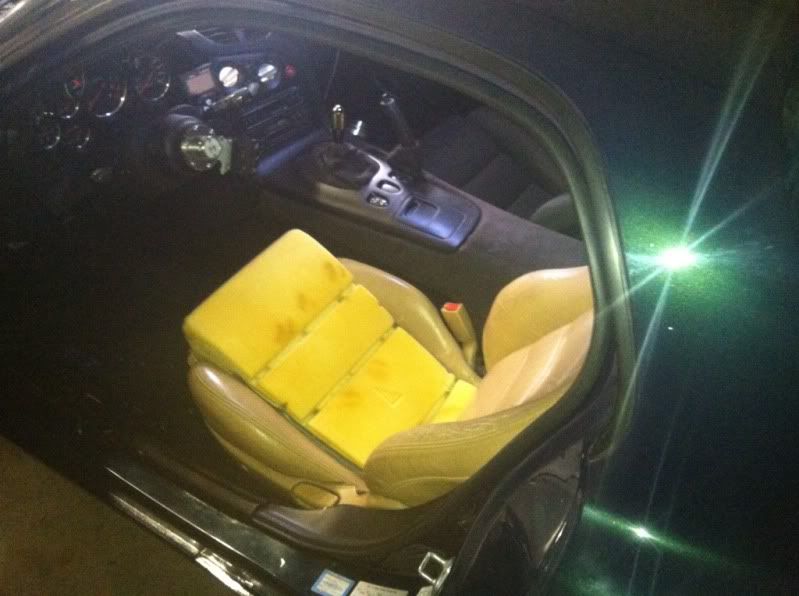

Got home a little early today so I tossed the seat in:
First impression; getting in and out of the car is real difficult now haha. But I sit very noticeably lower. I can actually see the entire tach and speedo without moving my head around (normally the 4-6k rpm and 80-130mph part of the speedo I can't see due to the steering wheel blockage). I had about the width of my hand in-between my head and the headliner...roughly 4 to 4.5 inches. MUCH more than ever before.
So, do I fit with a helmet? YES!! Just barely, but I do, and more importantly, I am sitting in a more optimal driving position with a clear view of the gauges and not leaned way back and/or hunched over.
I will say, without a doubt, the seat is uncomfortable compared to the stock seat, but for a track only solution, I think it will work. My backside may be a little sore after an hour + on the track, but it's either this or don't track the car. Small sacrifice IMO.
I think swapping seats at the track would be a PITA even though I can get the seats in and out in under 5 minutes now, it still won't be fun to lug around an extra seat and risk potential damage to my minty condition new cloth seats, and I'd have to leave them in the pits. So I came up with this super easy idea to give the modified seat stock comfort, on the fly:
Duh! I just put the piece of foam I removed back on top of the seat. When I sit on it, it's comfortable like a stock seat, then I just simply pull the foam out and boom! Helmet clearance! I'm happy with this solution. So I can swap in this modified seat at my house before I head out to the track, throw the foam in the seat, roll out comfortably to the track, remove the foam when it's helmet time, and throw the foam back in for the drive home. I think it will work out well.
