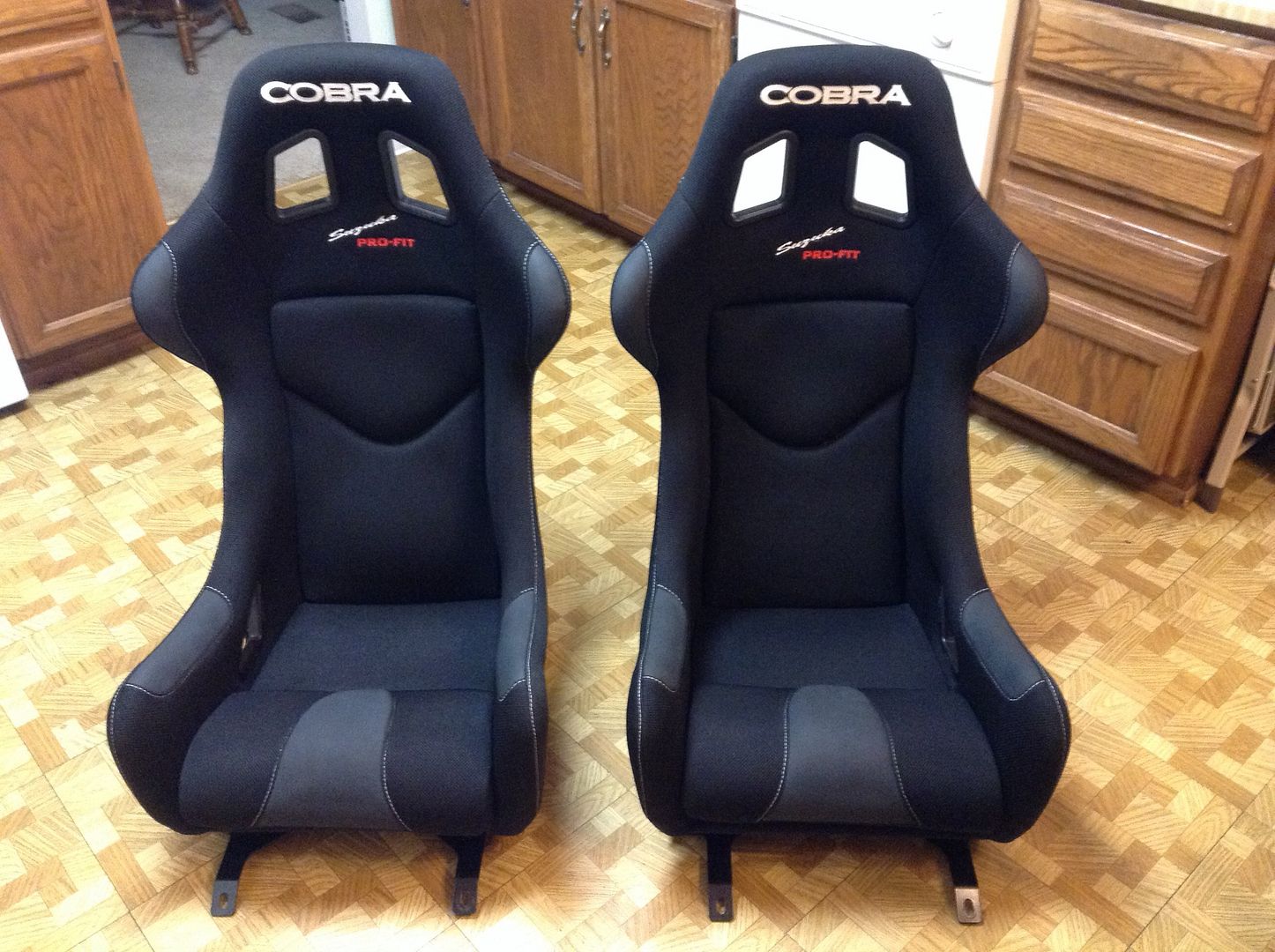

In other news, I'm getting my seats tomorrow, WOOHOO!!!

I got these today too. Obviously I can't test fit them in the car yet, but our new friend Joe stopped by last night and I told him he should stop by tonight since he wants to see the seats and he has his passenger seat out already haha, but he didn't stop by tonight. These things fit me perfectly though. The width is perfect and everything.
Oh I forgot to mention the seat weighed in at about 20lbs, and the rails weighed about 5lbs. I don't remember what the stock seat weighs, but 25lbs isn't too bad.

Joe brought his car over and I tried one of the seats in his passenger side. Man, this thing doesn't fit haha. I'm going to try dropping the seat to the lowest point in the front (it's already the lowest in the back) and all the way back. Right now the leg bolsters hit on the tranny tunnel and the door, to the point where the door won't even come close to closing. Not to mention the outer shoulder bolsters on each side might need to be trimmed down too. And the top of the seat is pretty close to the roof of the car.

The seat issues sound like miata issues. You will have to modify your panels (ie smash them in) as for the trans tunnel, the Miata guys lift the carpet and use a mallet to 'mold' space for the leg bolsters. You might need to do both since the FD is basically a bigger Miata.

These seats fit in another guy's car though. He said he didn't have to even trim anything. I can't even imagine trying to fit seats into a Miata haha, not seats that fit ME anyway.
