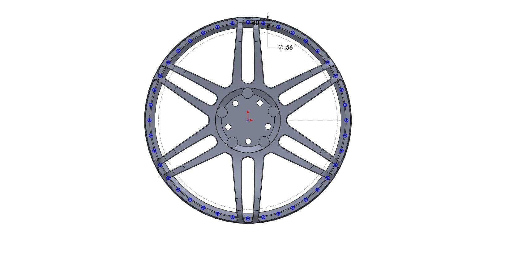

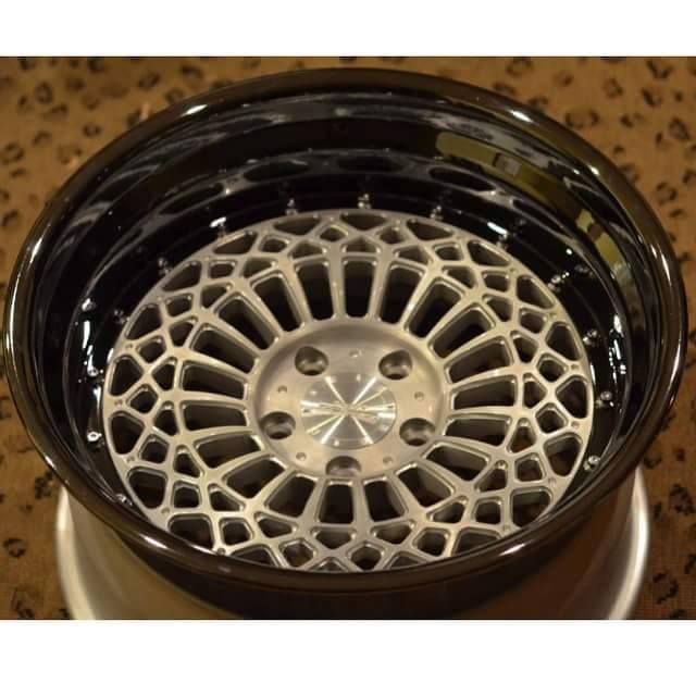

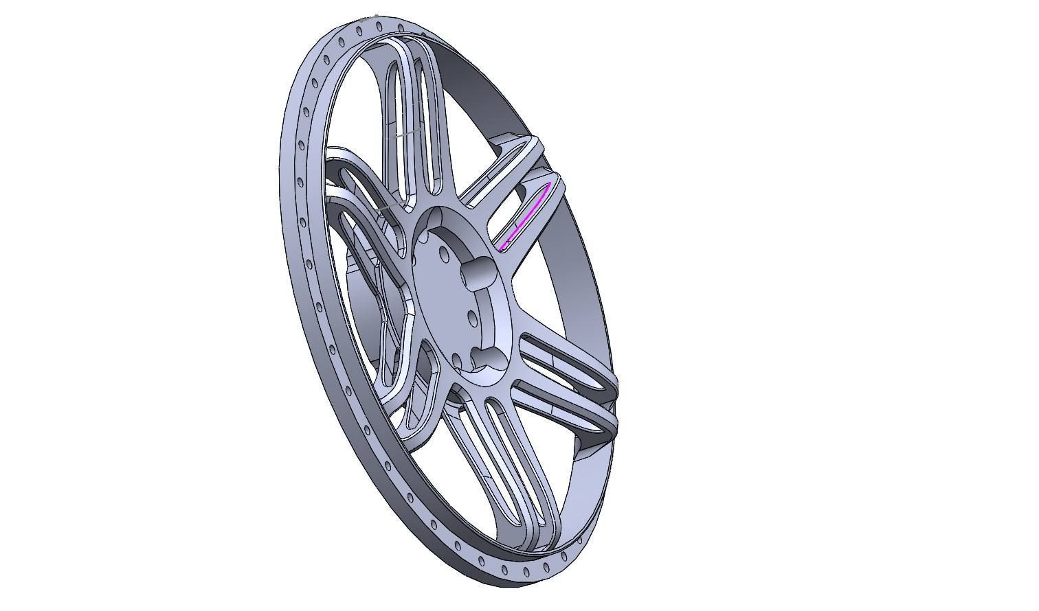

Now, to switch gears a bit. I've been talking to Alvin again about the wheel design. He sent me this pic and said he thought of cutting out the middle of the spokes altogether, but he's not sure if a machinist can cut that and he's not sure how much strength would be lost. The strength would be my main concern, but it reminded me that I wanted to look into making this wheel a little more custom. Otherwise it's just a 3pc TM02. Anyway, I'm thinking of how Mazda took technology from the Japanese Zeros of WWII, cutting holes in it to lighten it, but it also gained strength. I'm wondering if I can do something like that with the wheels.
This is the first wheel he designed, for Sergey, the guy that put me in touch with him. Pretty awesome. I love how original it is and how much detail there is. I'd like to go for something like this as far as detail and originality, but I also want to keep weight down and strength up as much as possible, and something not far off from the double six design.

I talked to Alvin on the phone for the first time last night about ideas on the wheels. I told him about how Mazda used technology from the A6M Zero to make the car lighter and make the structure stronger (using holes in the chassis) and thought about using this idea on the spokes, and we're looking into engineering used on bridges for ideas lol. But I'm probably most excited about how we're going to shape the mounting flange and how the bolts will go through it to hold the wheel pieces together. Should be pretty sweet. I'd love to learn how to use CAD so I can do this stuff myself.

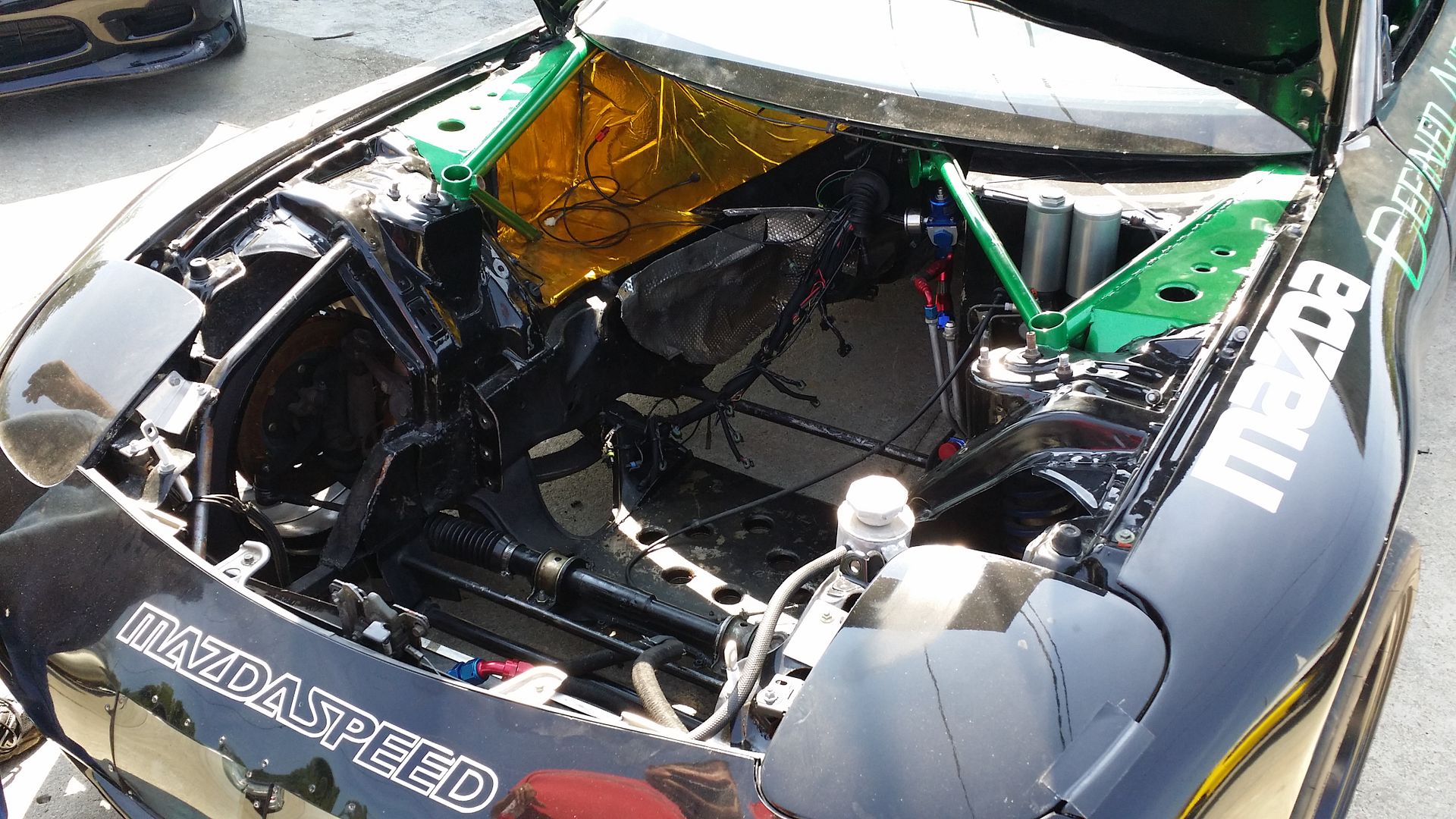

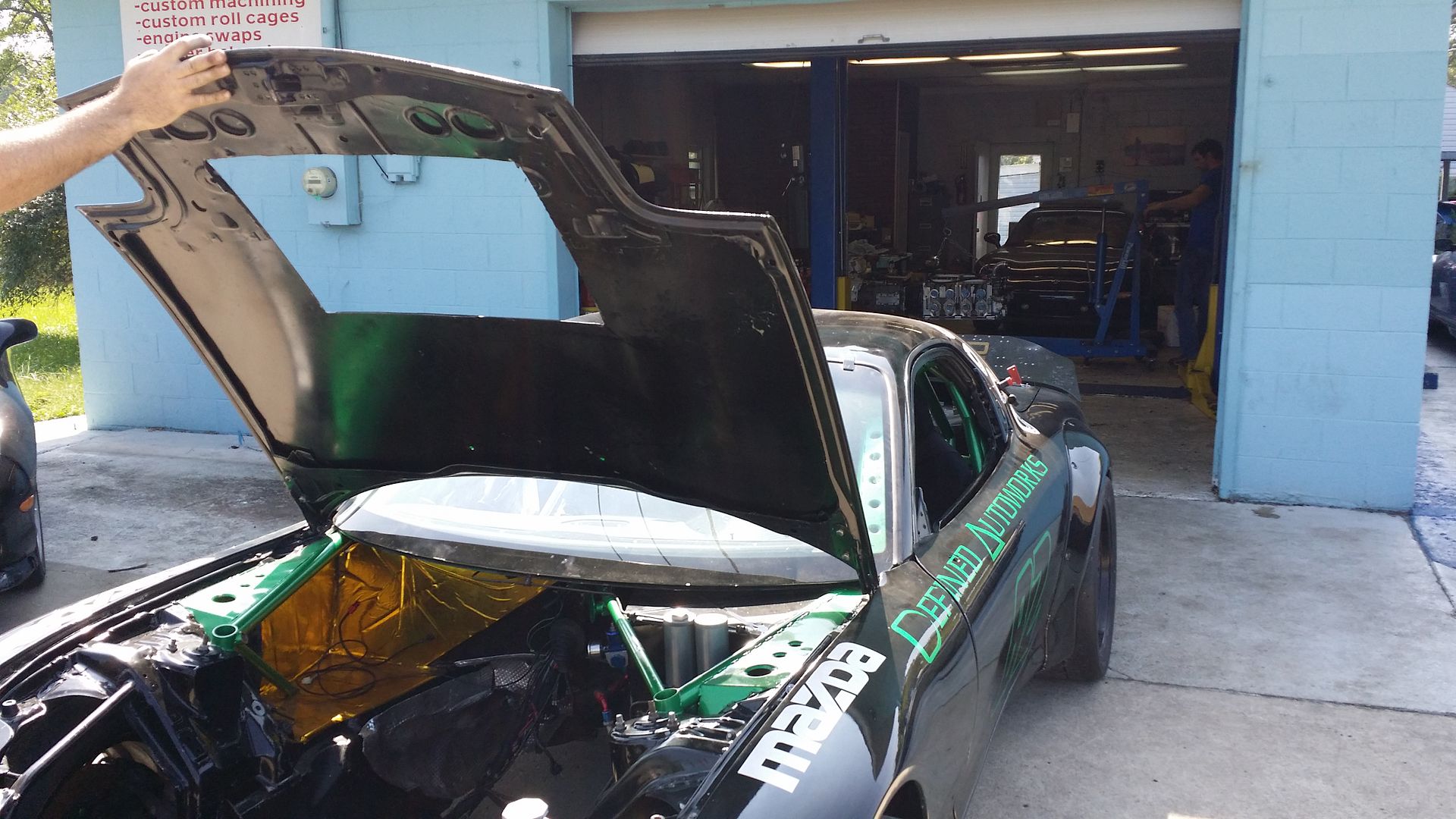

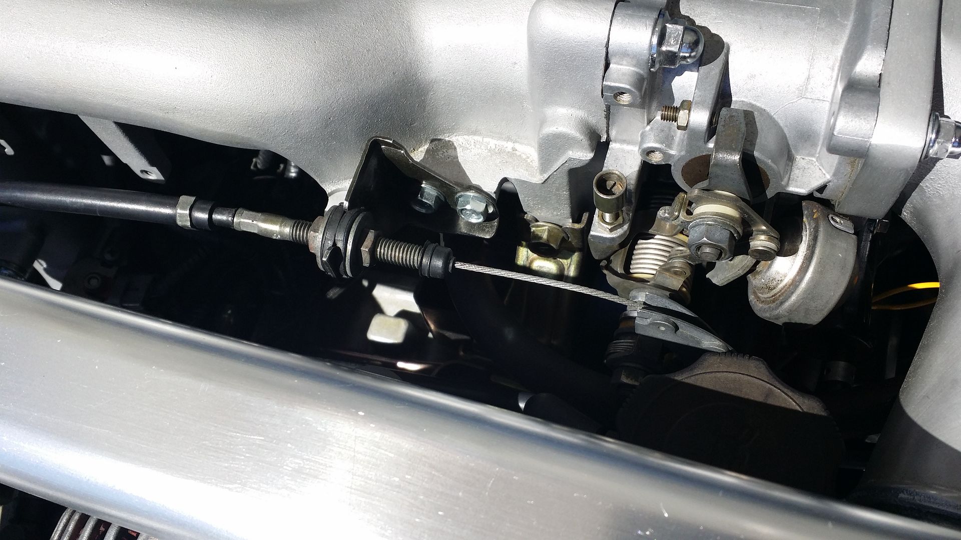

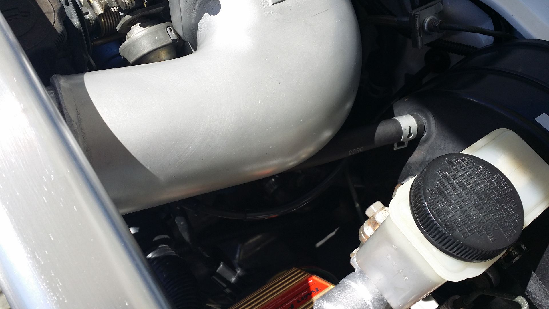

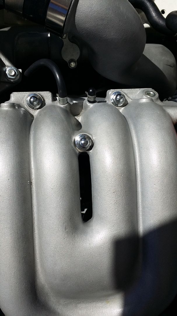

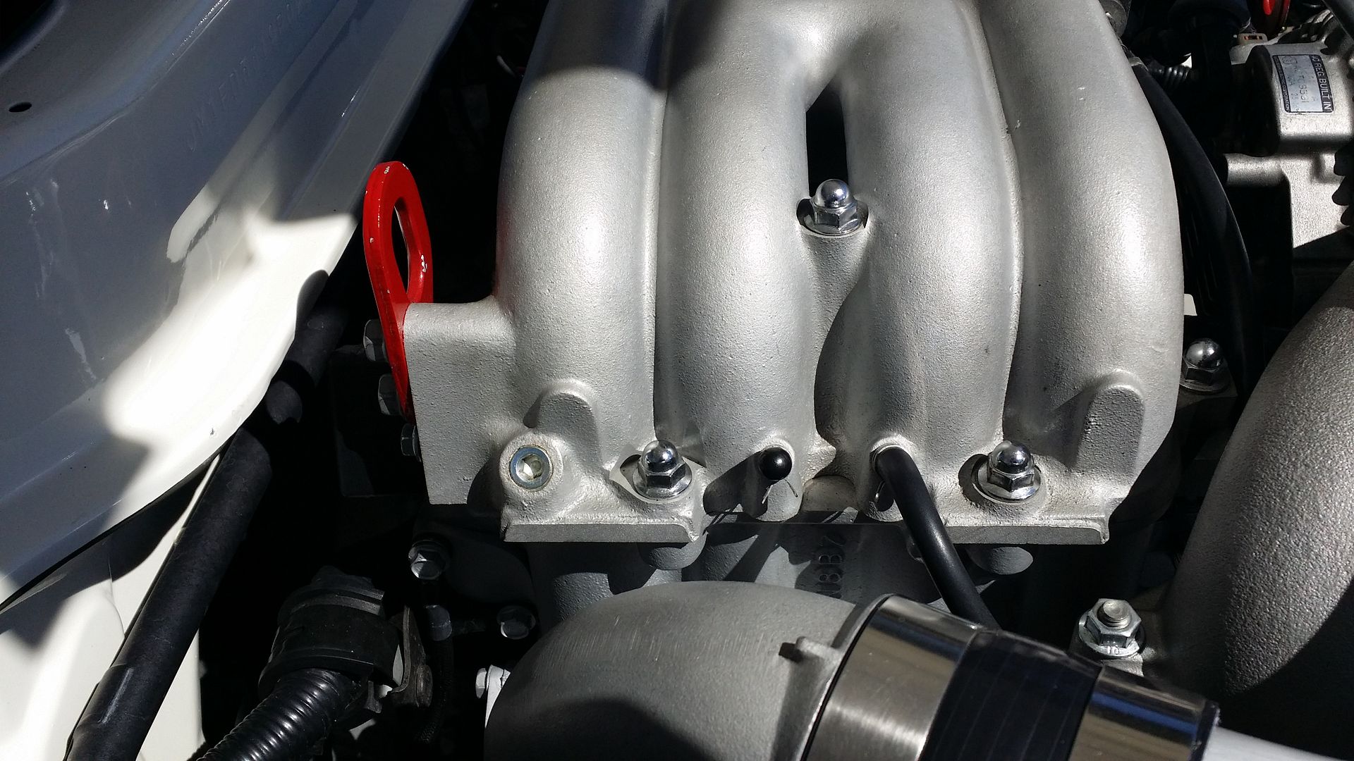

He cut the center out of the UIM, I think it looks pretty good.

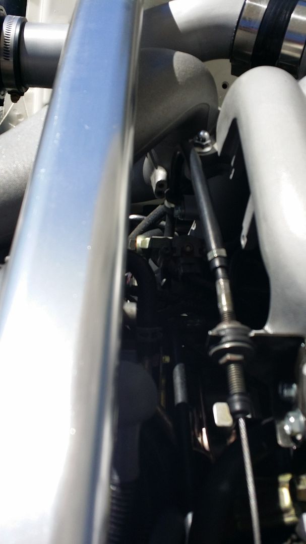

My favorite, he routed the throttle cable to where it would be somewhat hidden. I'm definitely doing this.

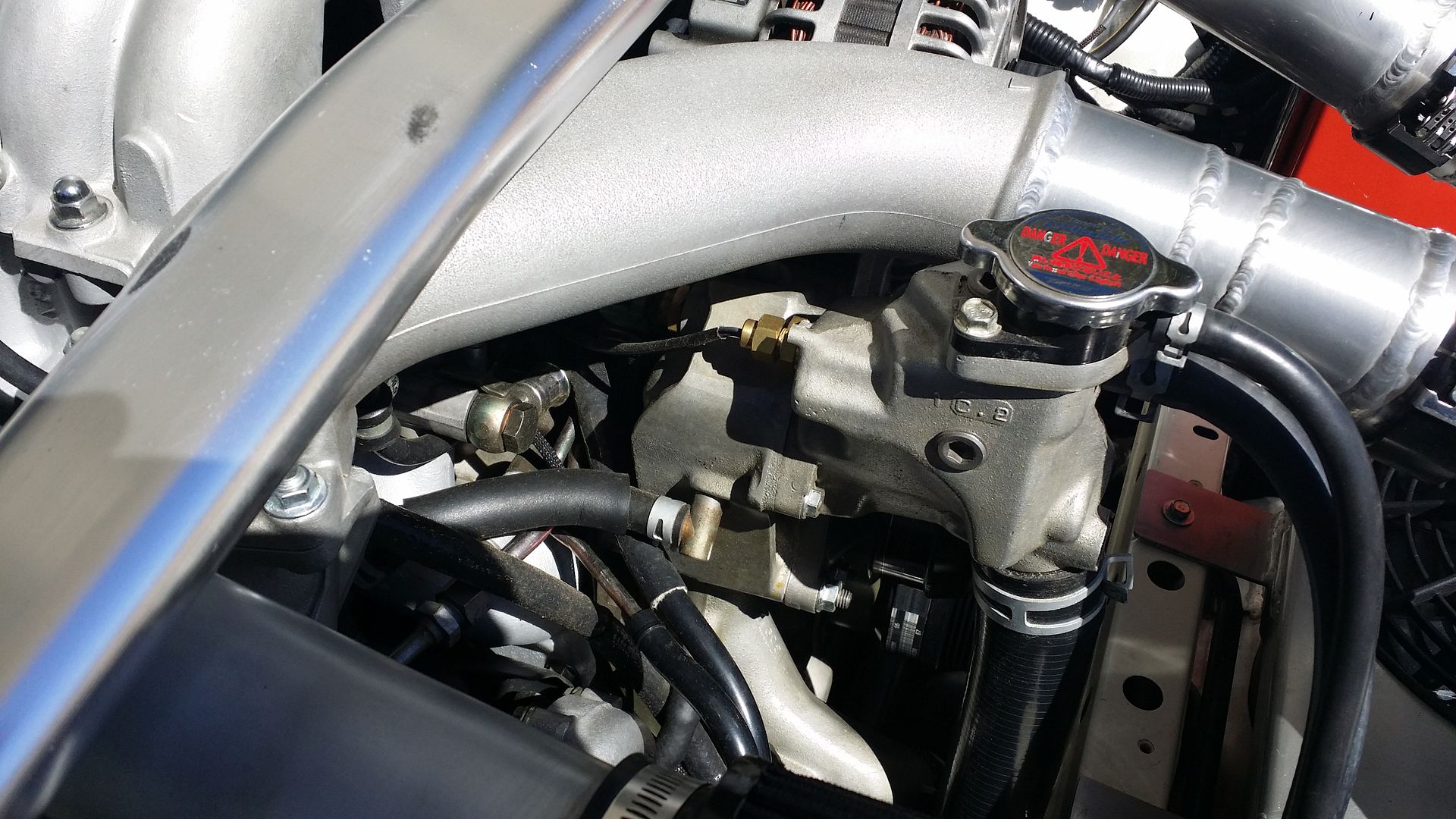

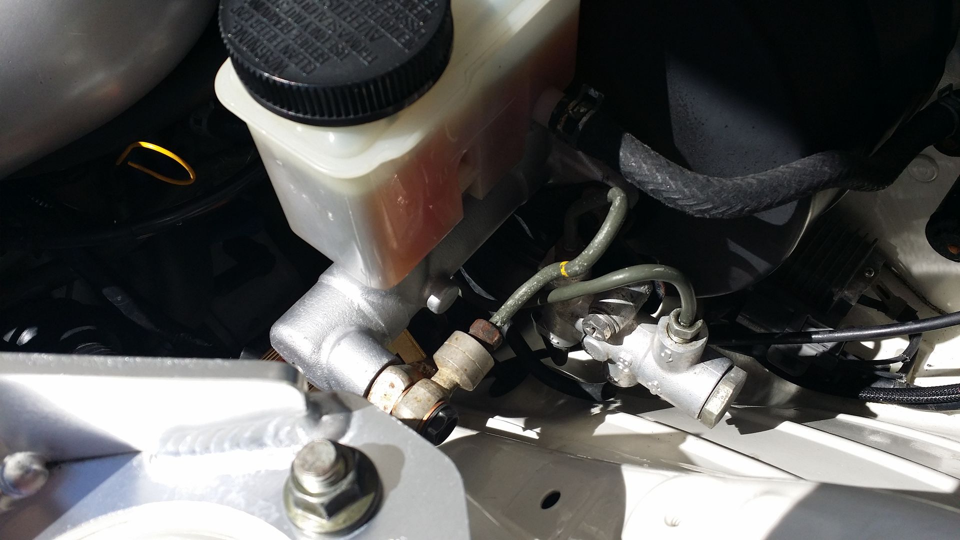

It's kinda hard to see in the first pic, but a little better in the second pic...he removed the brake booster pipe and used a hose to run it to the front of the UIM. I've deleted that nipple but I should be able to find a nipple to thread into the hole I tapped and plugged. I like how clean the back wall of the engine bay is, but if I can't do this one, no big deal I guess.
And in this pic you can see where he drilled, tapped, and plugged the old brake booster port with a set screw. Super clean. I've used this method on a few things myself.
He cut off the part that the air pump bolts to. I love the look of this, but I don't know if I have the balls to cut that off, I'm not sure why lol. I doubt I'll use it for anything anymore, but you never know.
When he deleted his ABS, he used the stock bracket that held the proportioning valve and just flipped it around, cut off the excess, and re-bent the stock lines. He also tucked the brake line under the rail at the back of the engine bay, the same way I did, but his came out cleaner. I don't think I have any pics of that.

Also, Alvin told me that the 40 hole lips and barrels won't work with my wheels the way he's designing them, which makes sense because 40 is not divisible by 6, but 36 is, so I'll probably have to buy some blank lips and barrels and have them drilled with 36 holes.
