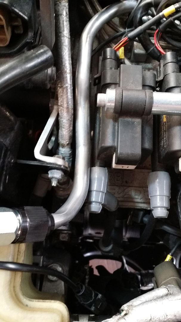

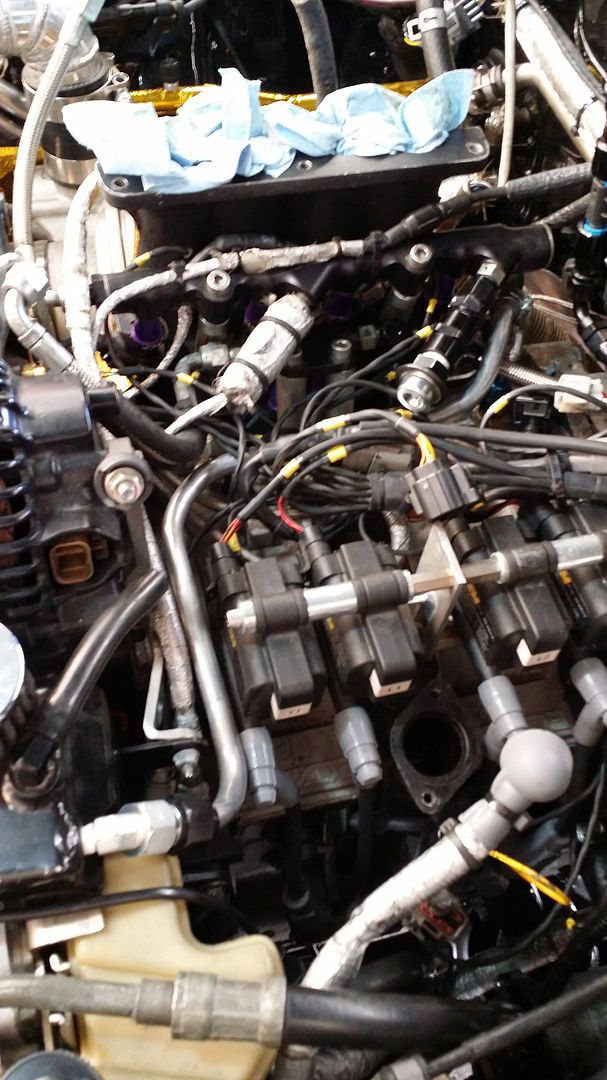

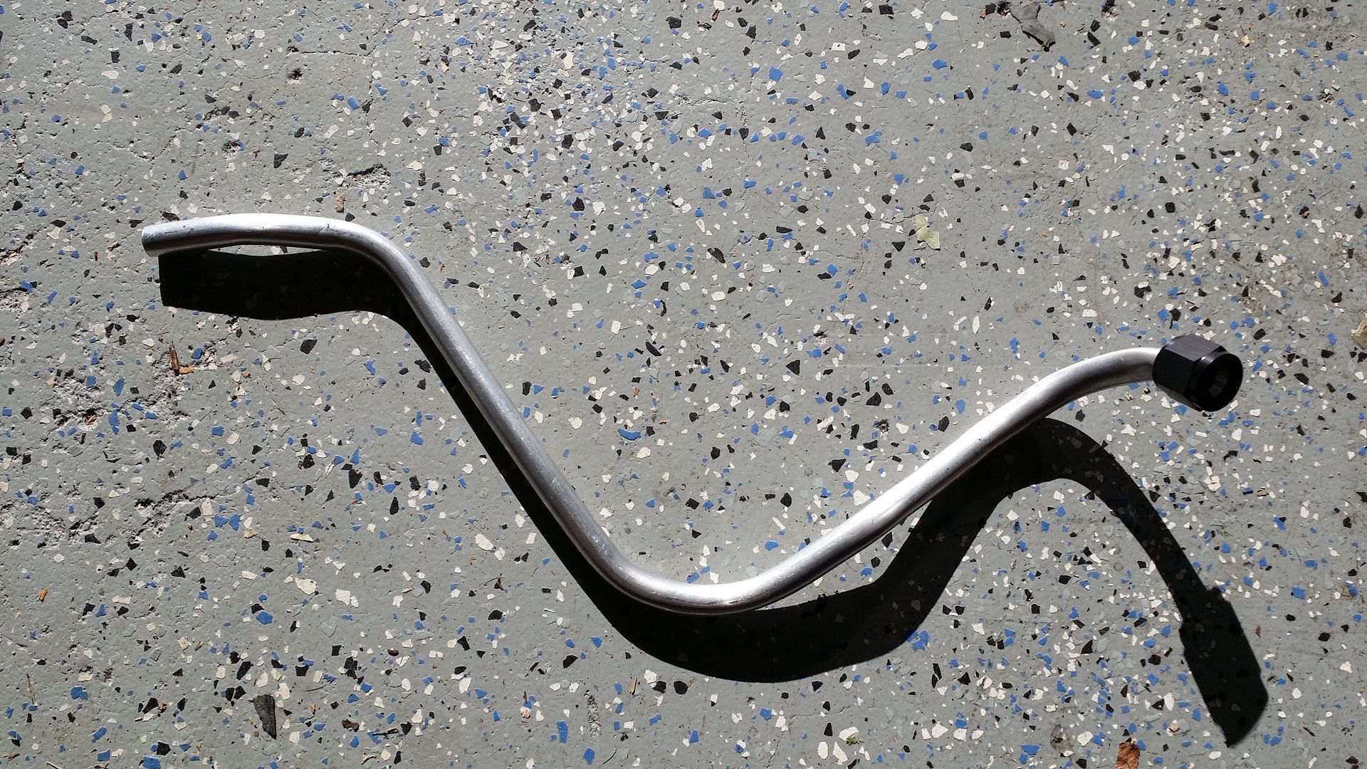

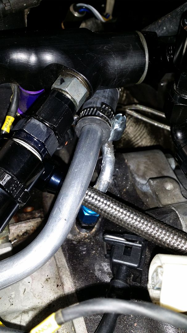

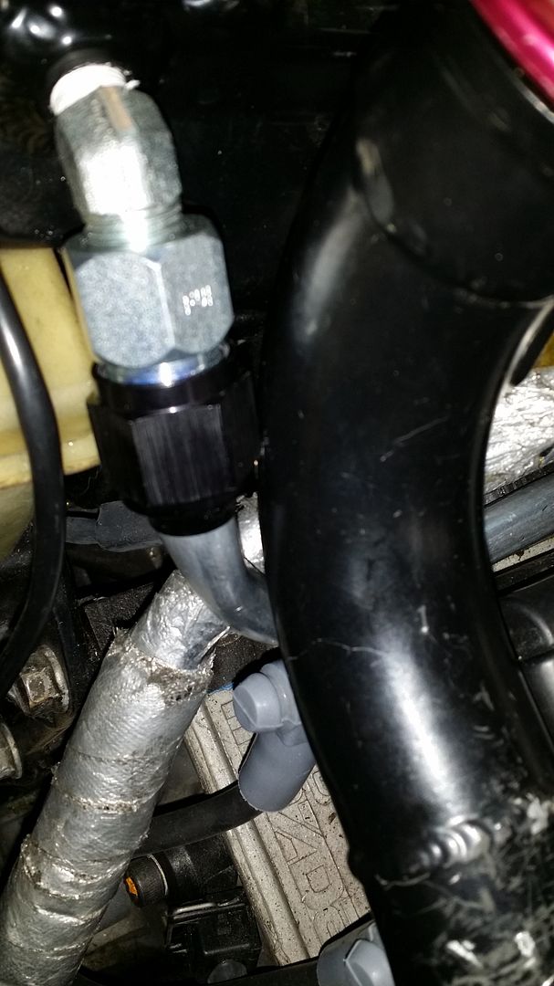

I got some fittings from Whisler Bearing that would work on the hard line and I made two more lines before I finally got one that worked. I NEVER want to do that again. This one is a little kinked by the fitting, but there really isn't much I can do about that. I was able to get it to fit pretty much perfectly between some tight gaps, and I had some clearance issues with the pulsation damper that Chris had installed and the wastegate coolant line where it connects to the rear iron and the fuel line going to the primary rail, but I massaged the lines and adjusted things until it all cooperated. It's super close to the oil filler neck too, and the top of the engine, and the coil pack...lol. What I ended up with for the fittings isn't quite as polished looking as I'd like, but it'll have to do.

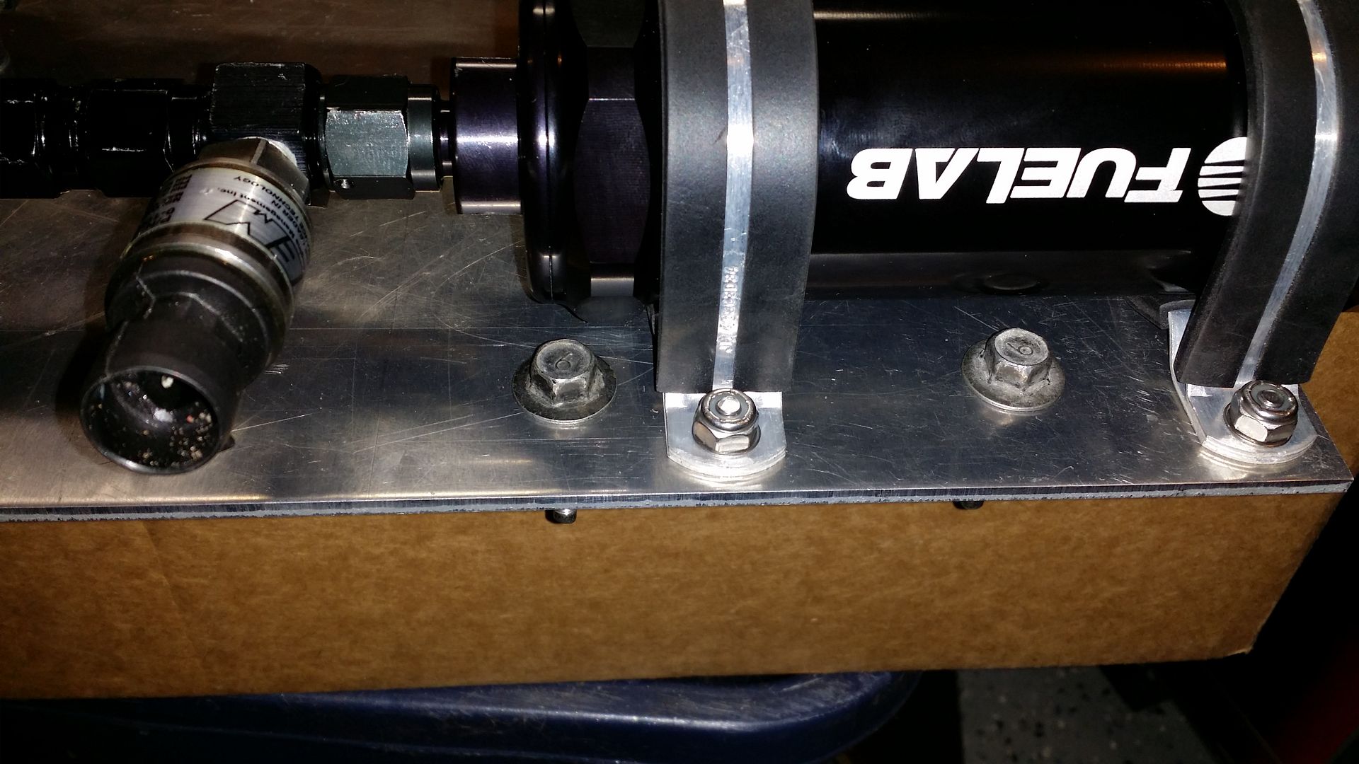

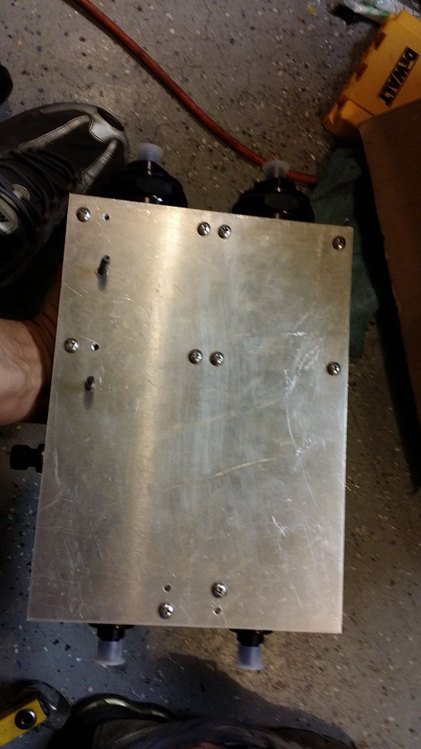

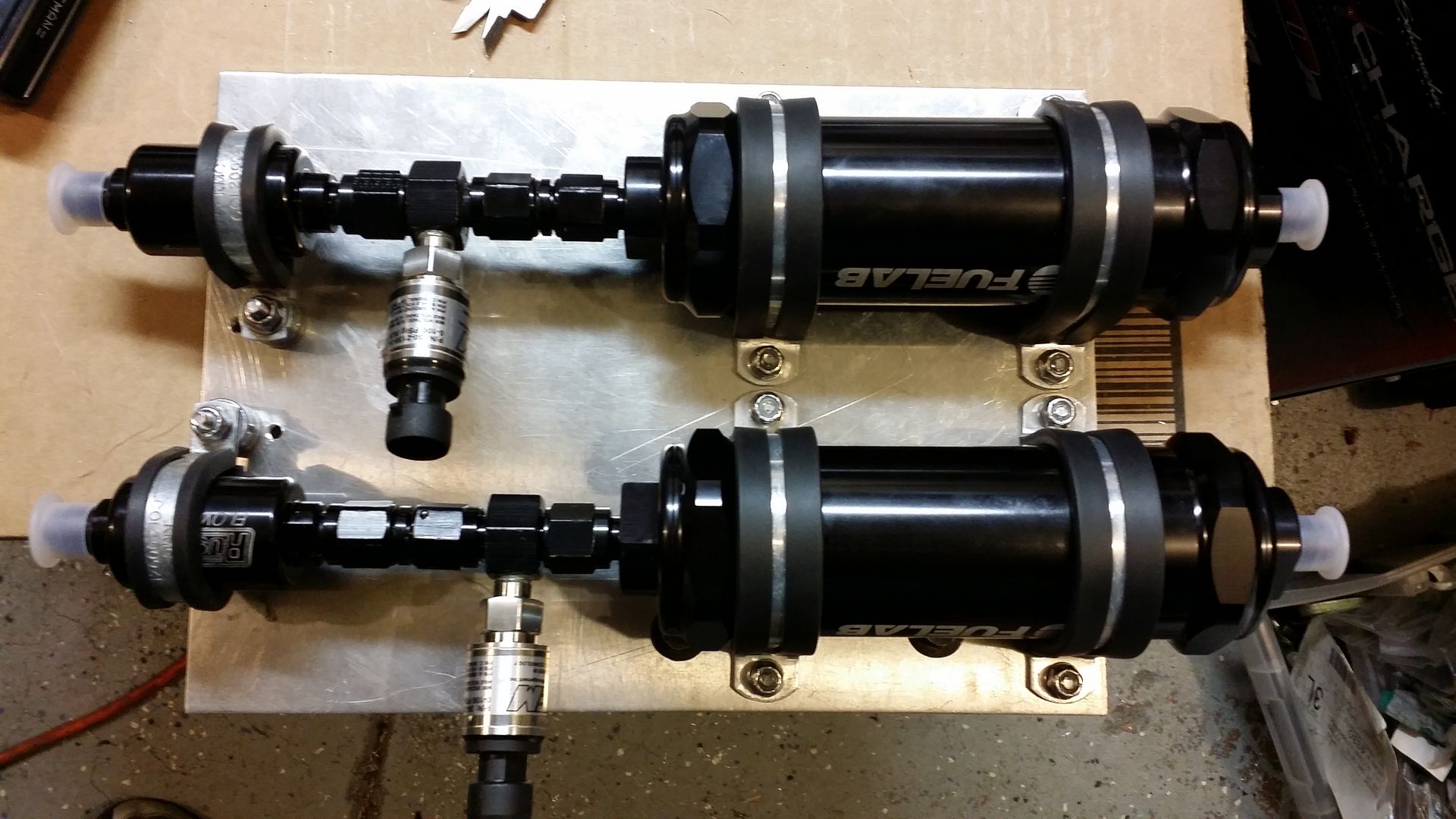

I finished the fuel filter mounting plate and installed it. I didn't think to check them before installation to make sure the filters are actually inside the bodies already, so I broke out the inspection camera that Mom got me for Christmas last year and used it for the first time. I love that thing, thanks Mom! I was going to use the chop saw on the plate to cut it down, but I asked Mitch (the guy that welded the IC end tanks and piping) to cut it for me with his machine and it came out much nicer. It's only held on by two 10mm bolts, which makes me really nervous and I want to put at least one more bolt in on the top someday, but it seems pretty sturdy.

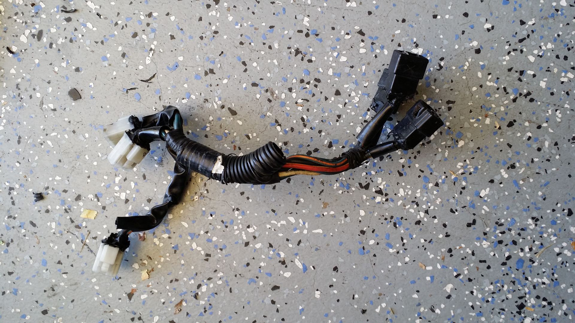

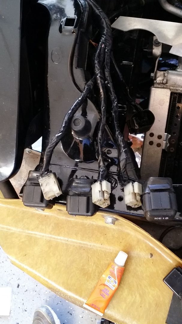

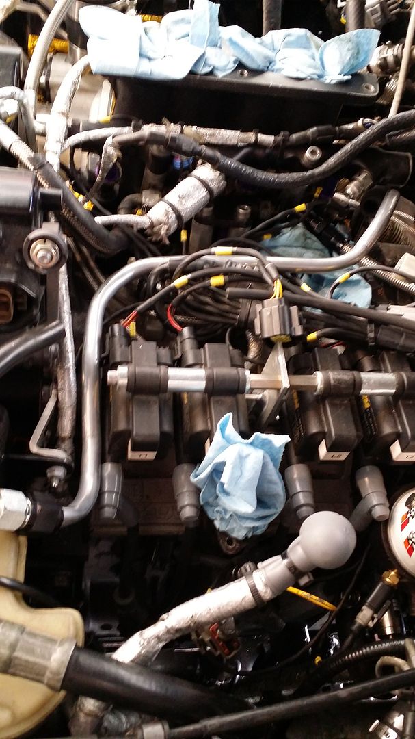

I had RTV'd the coolant fan relays and connectors already, but then I realized I didn't necessarily need the extra harness in there anymore, so I deleted that part. It was part of a recall by Mazda to run the fans after shutdown, but part of that fix was a little black box inside by the ECU that Chris removed when he installed the new ECU, so I didn't really need this harness either.
What I removed...
Normally the little harness connects to these, but I just put the relays right on the ends of these and crammed them into the front of the frame near the air filter.
There were other little things too, but nothing really worth mentioning. Or I just don't remember lol. That's more likely actually.
What I removed...

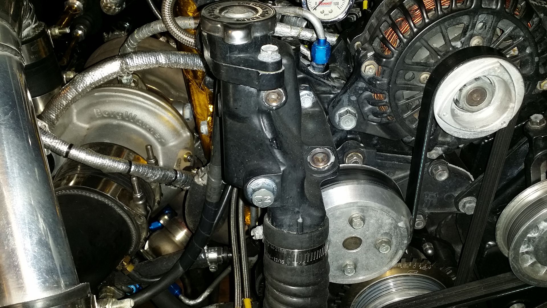

I haven't done a whole lot over the last week or so. I installed a bolt into the coolant filler neck to replace the OEM level sensor that isn't being used anymore. I bought a black oxide set screw from Fastenal for it, but I felt it was too long and would protrude too far into the neck and disrupt coolant flow, so I ended up just using the bolt I had bought at ACE hardware already.

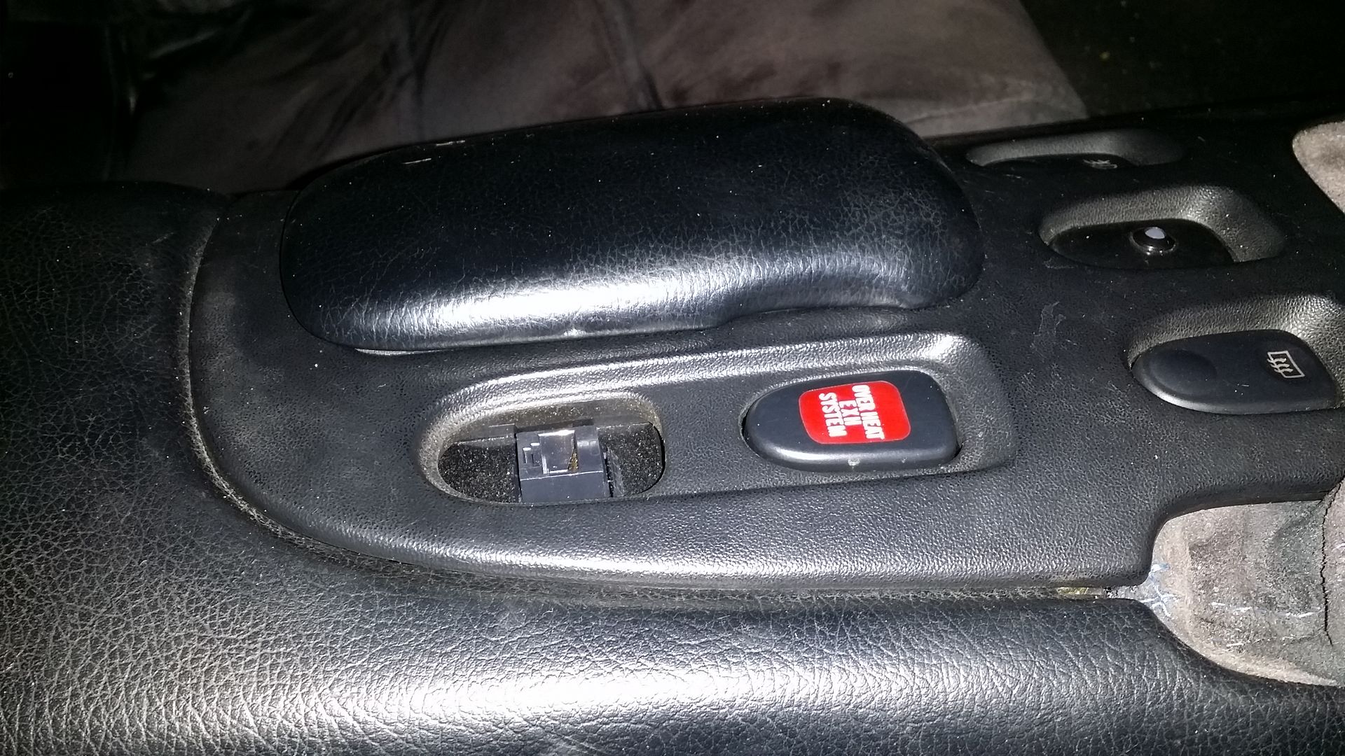

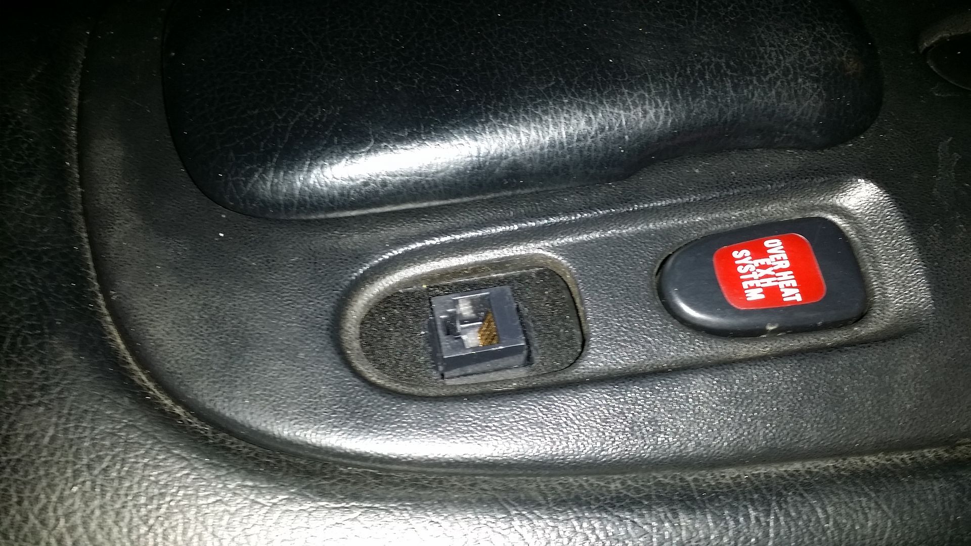

I got a CAT5 coupler from a buddy at work and installed it in place of the security system light. Actually because the cable was hitting the mount for the tranny tunnel cover, I moved the exhaust overheat light up and put the coupler in place of the overheat light. The security light wasn't working and it turned out to just be a burnt bulb which is tiny and I'll probably have to get from Mazda. I would have removed the exhaust overheat light but Chris hooked wires up to it so it would indicate a fault in the ECU. I'm still thinking about removing it though because it goes off almost every single time I drive the car and it just flashes annoyingly. Usually I think it's due to the turbospeed sensor which faults pretty much every time I rev I think. I still want to figure that out someday too. I'd think about leaving the security light out because all it tells me is if the security system is armed, but I've pretty much figured out when it's armed anyway. ANYWAY, I'll figure out which light I'm going to keep, or I'll put them both back and mount the coupler somewhere else. But I really like where it is now.

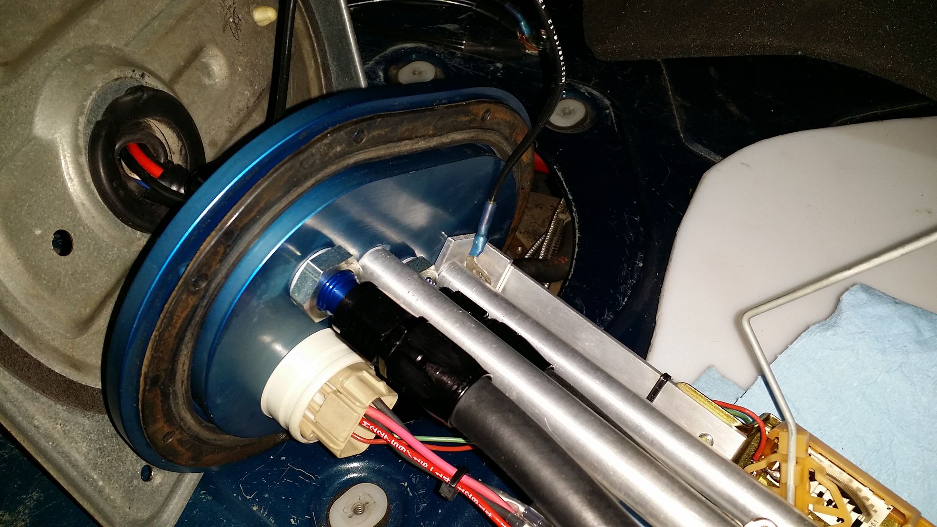

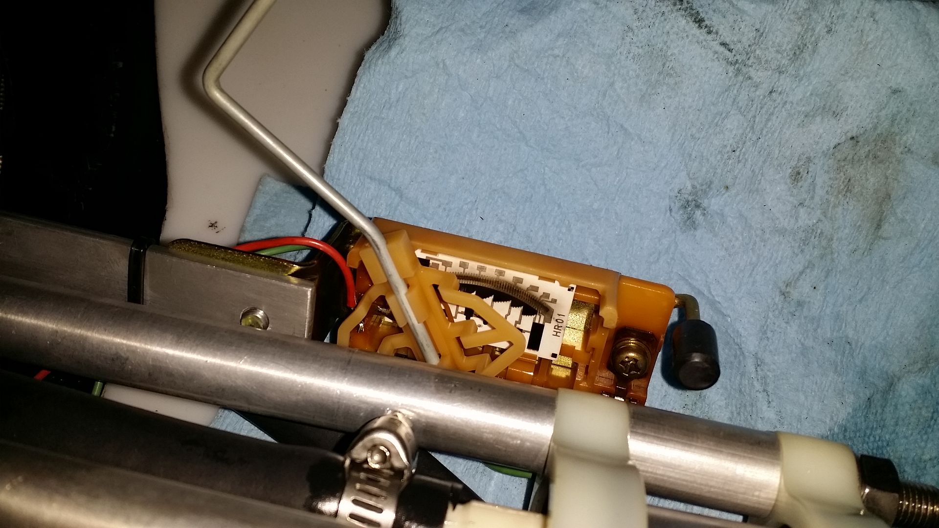

And tonight I decided to finally look into the fuel level float sensor. I tested it and it showed 6 ohms full and 82.6 ohms empty, but in between it would go erratic sometimes. So I thought maybe it was the sensor but I decided to change where I put the ground cable for the hanger and see if that changed anything. It certainly did.
I rested the ground wire against the hanger that the sensor was bolted/grounded to. When I removed the wire the gauge would fall back to empty after a second or two. Now it's calibrated at full for full and empty for empty, and although I'd rather have it calibrated with a couple gallons left at empty, I decided not to try my luck for now and just go with it lol. Depending on how much they cost I believe I'll still get a new sensor. This one is over 20 years old and fairly worn. Hard telling when it'll go out, although after 20 years it still operates alright for the most part, so I guess they don't fail that often. Knock on wood.
