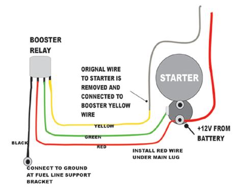

Re: Build thread
I did the starter booster mod on mine and the click click starting issue went away.
- Attachments
- StarterBooster.JPG (19.07 KiB) Viewed 6614 times

I had that installed when I still had the battery in the engine bay, but since I hooked the battery cable straight from the battery to the starter, I got rid of it since it was redundant. I also have the battery ground going straight to the transmission, and I'm using 0 gauge on both of them. That starter booster did get rid of the issue when I had it years ago, but this is a newer issue.

Cody told me yesterday that he did a fix to his starting click issue and it cleared up the problem. Basically ran a wire directly from the starter cutout relay connector to the starter, which I think Chris basically eluded to before haha, except I think Chris was talking about running it from the ignition switch all the way down. Either way, I did that today and I'm hoping it fixed the problem. So far it's working but I won't know for sure until I try it a few hundred times haha. It seems to creep up after the car has been driven for a while.
