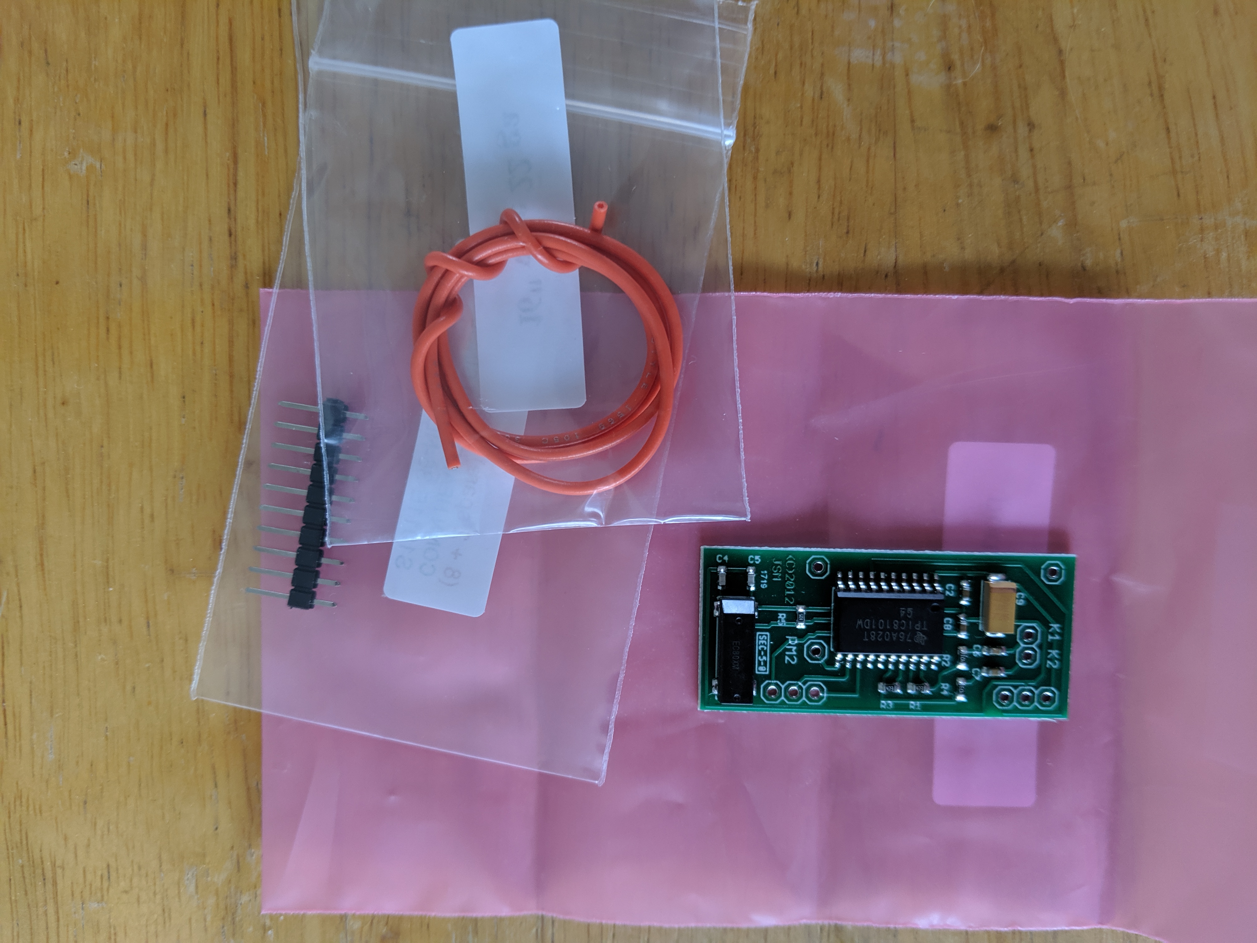

I'm running the MS3X kit from DIYAutotune. The OMP board I'm building is based on an arduino with a homemade stepper driver. It will compare engine load to OMP position and drive the OMP.

Ok I figured it was a Megasquirt. Damn, sounds like a lot of work, but it'll be exactly how you want it.

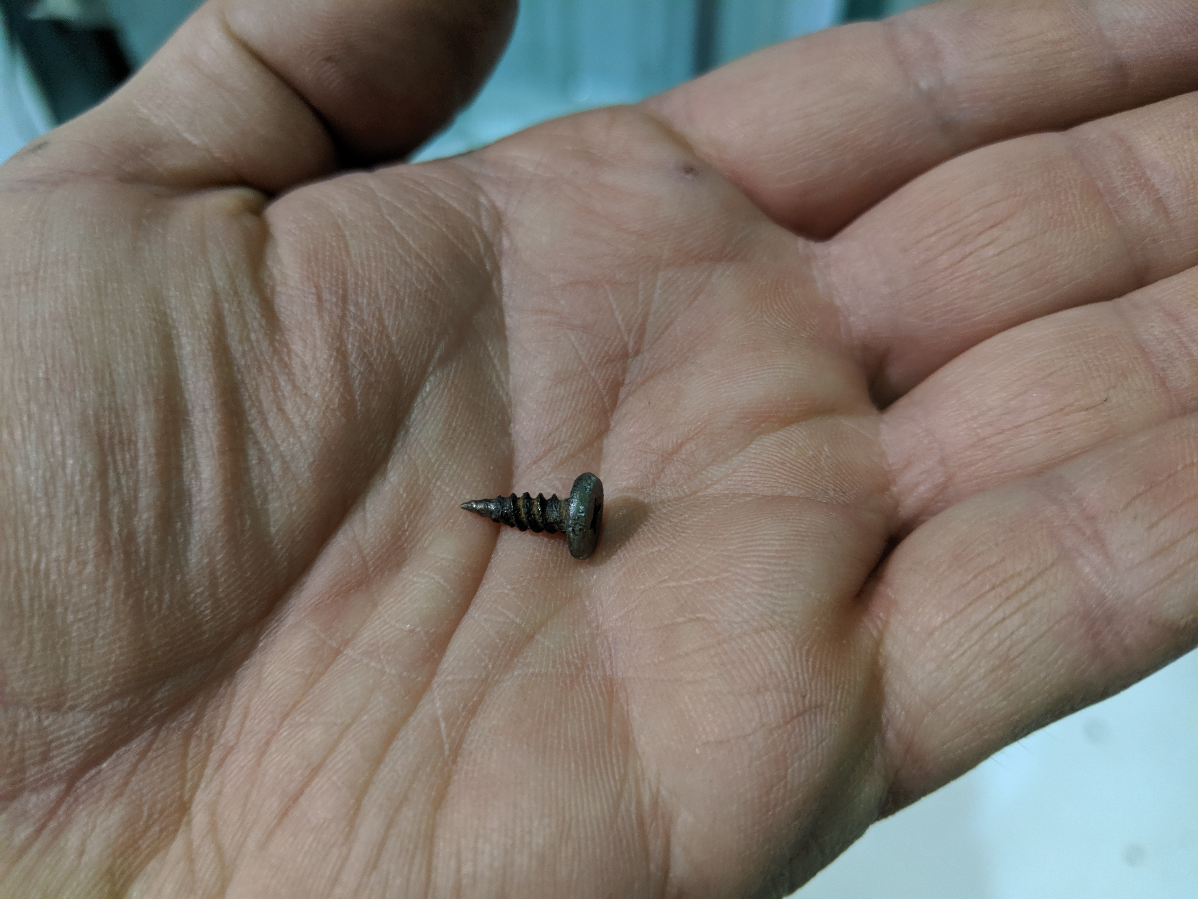

Found a screw in the passenger rear!! got out the plug kit and pulled the tire and I won the lottery! It didn't puncture!! the head was fairly large like a drywall screw but it was super short and didn't make it all the way in.
