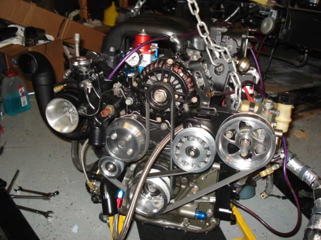

Anyway, here are some pics of the engine...

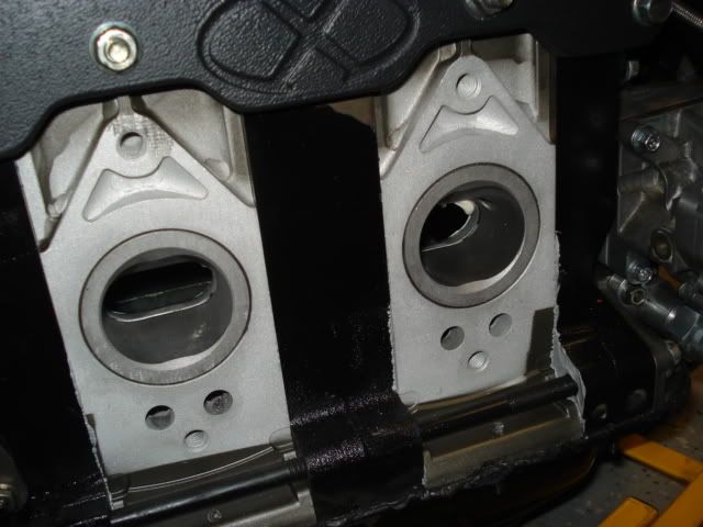

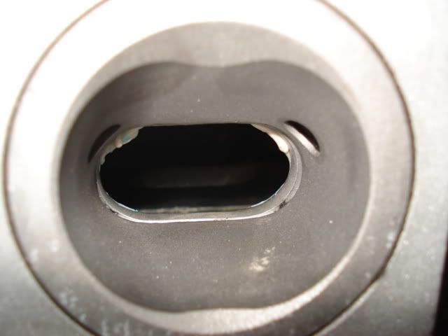

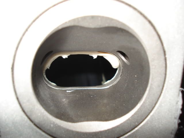

Here are the exhaust ports, the white stuff inside is the petroleum jelly...

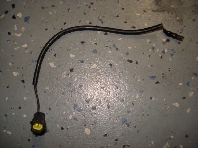

And unfortunately I broke the wire that goes to the power steering pump, so if someone local has deleted their power steering I'd like your wire please haha. Simon deleted his but I'm not sure if he still has the wire and he's in bed already.
Postby chickenwafer » Sat Apr 02, 2011 9:14
I'm going to junk my power steering but not yet so I don't have the wire available haha. Later this summer I will tho!
Man that's a lot of "assembly lube" (aka jelly) in that motor! It's gonna smoke like a son-of-a-bitch when it fires up!
Postby speedjunkie » Sat Apr 02, 2011 9:14
I think I'll look for someone down here that has a car that isn't running so I can borrow the wire until I get a new one haha.
Yeah I wiped out the jelly but I could still see some down in there too. I don't care if it smokes, as long as it starts haha.

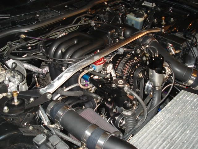

We got the engine in, and I already have a lot of stuff connected. I need to install the downpipe, connect the engine wiring harness, install the radiator and IC and piping, put some fluids in, connect the battery wire (I have to put a terminal on the end since I rerouted it to the starter), put new spark plug wires on (when I get them), mount the coil pack, connect ground wires (and shorten them), and that should be it. Oh, I have to bolt down the engine mounts but I need bolts that are about 5mm longer. I still have to test fit the strut bar too to see if the mounts are the right height haha.
This was by far the easiest install I've done on an FD. It was ridiculous really. Zico and Simon helped out and I only suffered some gouges on the back of the turbo housing, so the powder coat is scratched up in a couple spots there. But that's it. Everything went so smoothly. The only thing driving me crazy now is the fact that I forgot to put lube into the pilot bearing before stabbing the engine and tranny together. Oh well. I'll get in there and pull the tranny to do that sometime later on, and at the same time I'll put a new rear seal in the tranny too.

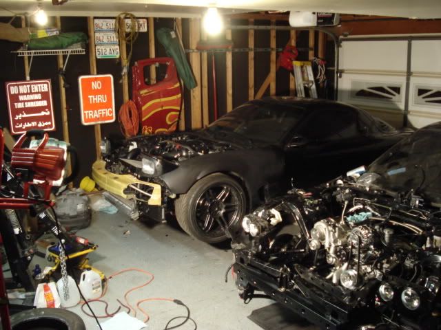

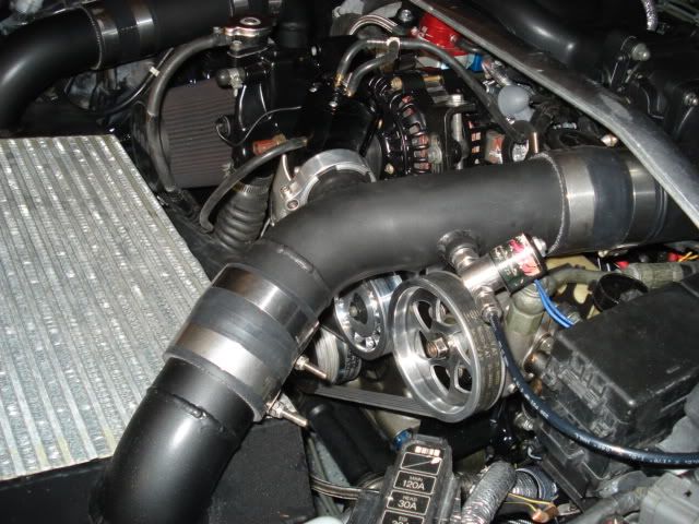

Here are some pics. It is still sans bumper, fenders and hood because I'm trying to decide if I want to put the flared stock fenders on and modify them or if I want to just put the FRP ones back on so I can drive it.
