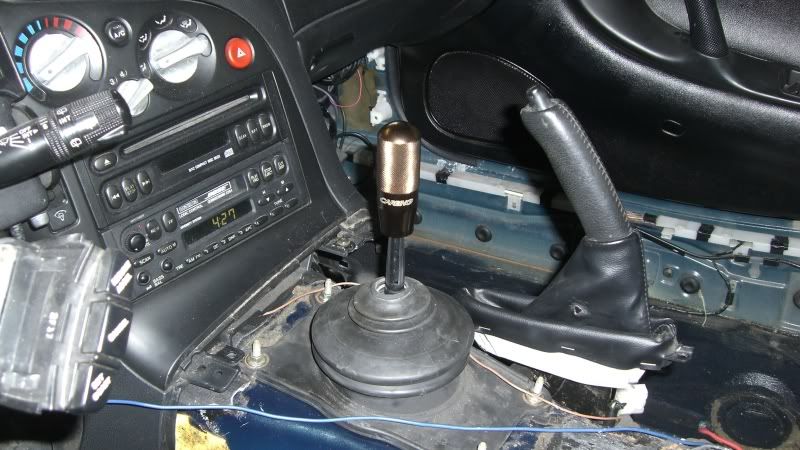

Snagged a short shifter and it came in the mail today so I got busy installing it. Real simple install save for the bolt on the top passenger side of the shifter mount that is blocked by the chassis...holy shit that's a stupid design haha. Took a lot of persuasion but I eventually got the bolt in there and threaded.
I had planned on taking some pictures of the install but really, it was just so short and uneventful I didn't. My old stock shifter had a lot of slop and play in it, the new one is much, much tighter. Throws aren't as short as I had hoped, but the effort is minimally more, so a fair trade-off.
Installed picture, although there is nothing to really look at:

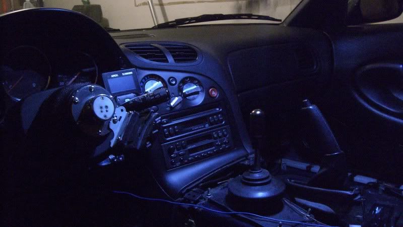

Also did the best $6 mod I've ever done to any car:
Replaced the map lights with some circular SMD panel LED's. For some reason beyond my knowledge my camera captures the light as blue but they are a "hyper white", similar to an HID headlight, with a very gradual blue tint to them. I'm more than happy with the LED's though, they bask the entire interior in a bright, white light and take a very minimal voltage draw (especially when compared to the stock lights) and they don't put out any heat- very impressive. And when you factor in the fact the pair was $6 bucks, can't beat that.

Is that a Carbing short shifter? Looks like what it says anyway.
Postby chickenwafer » Fri May 11, 2012 9:14
It's a Carbing High Grip shift knob which is fantastic. The short shifter itself is just a Ralco eBay shifter. I saw no need to spend 4x the money on a "name brand" shifter that accomplishes the same exact thing haha.
