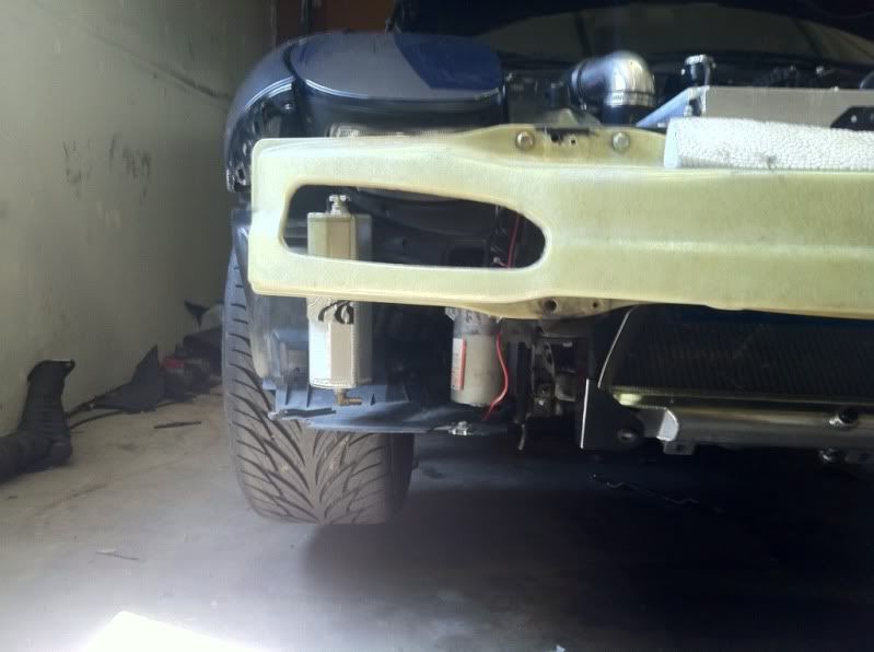

So I realized I need a coolant expansion/overflow tank after all. Every time on shut down, the hot coolant expands past the pressure cap and leaks. So I ordered an expansion tank from Summit last week and it arrived yesterday.
I made up a quick bracket from aluminum and mount it in the passenger side of the engine bay, just in front of the turbo. It will work fine in that location but I'm not thrilled with the look, with this big aluminum tank in the engine bay. So I'm thinking I'll move it next to my water/meth pump which is down in front of the passenger front tire, near the tow hook. That way it would be hidden, but I wouldn't be able to add a second oil cooler in that location later down the road if I wanted to.

I then moved the coolant expansion tank to in front of the passenger wheel. I like it a lot better there, it's no longer visible and will work just fine, seeing its where the OEM tank is. I just had to flip the bracket I made and drill a new hole and it bolted up fine to an OEM mounting point.

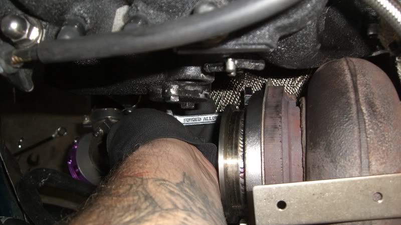

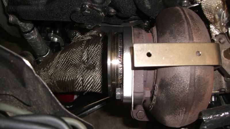

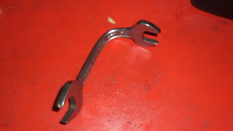

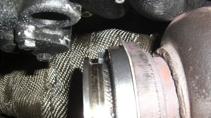

Got my downpipe back and test fitted it. What a bitch. I thought getting the little v-band adapter on the turbo would be a piece of cake. Wrong! The problem is the v-band edge blocks part of the bolt, so I can't get a socket on it. And the bottom bolt is in such a location I can hardly get a wrench on it.
So I go to Ace to try and find some bolts with an allen head in them so I can torque the bolt in. The size is M10x1.25, which is apparently the rarest bolt in the world, since all they had was M10x1.50. I only found a smaller head bolt in M10x1.25 so I got those since they have a 14mm head as opposed to the bolts I previously had with a 17mm head.
Still was a major bitch, the entire v-band adapter took me over an hour to install. I ended up slotting the bolt heads with a portable band saw so I could use a flat head screwdriver until they got too tight to do by screwdriver anymore.
Anyways, Finally got the damn v-band adapter on, then came the real fun part, the downpipe itself. I couldn't hold the bottom and align the top flanges at the same time so I had a friend come over and after about 30 minutes I finally got it aligned up and the clamp installed. The clamp is also a crazy tight fit due to the EGR block off plate.
I left a small relief cut at the bottom flange that bolts to the midpipe so the downpipe would have play in-case it didn't fit correctly. Since I have it fitting correctly now, I removed the downpipe and will get the rear flange welded up. Then I can heat wrap it and install for, hopefully, the last time.

The v-band adapter piece, I think my welder is pretty good:
Trying to get a picture of the rear bolt to show how impossible it is to tighten:
I had to end up bending a 14mm wrench to get it on the bolt head, and then hook another wrench on the end of it to torque the bolt. What a bitch:
