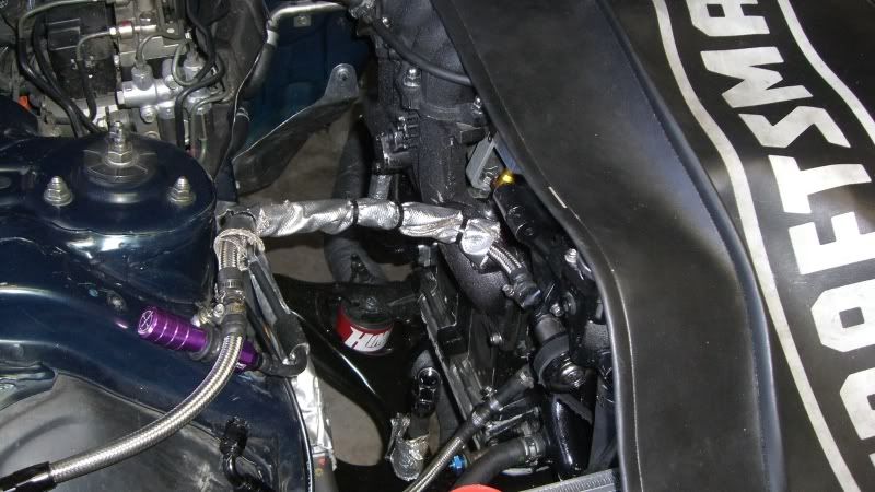

Got the downpipe back yesterday afternoon, heat wrapped it, and then installed it. The stupid vband adapter piece still leaks at the turbo from the 2 bolt flange. I'm going to have to try and remove it (it was a major bitch to install, so removing it should be real fun) and try doubling up on the gaskets on it I guess.

I removed the downpipe adapter and it was easier than anticipated. Two gaskets in and it looks like it won't leak. I shined a super bright led flashlight on the inside and I couldn't see any light, also my 0.002" feeler wouldn't even try to go through it. I will know for sure once I have a friend come over to help me get my downpipe installed.

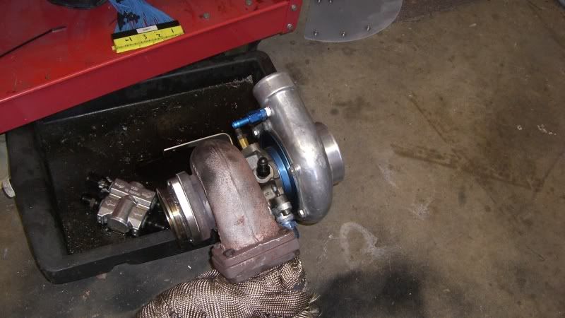

Sooooo, not that anyone cares, but I removed the turbo/manifold/wastegate because I just can't get this downpipe to work. The v-band adapter won't create a leak-free seal on the turbine, so I either need to get the turbine flange and the v-band adapter flange both machined flat and try again, or, the better option, just the get the v-band adapter welded straight to the turbine housing.
The problem is, even if I get the flange surfaces both decked flat, the bolts that are used to secure the v-band adapter to the turbo interfere with the v-band clamp on the downpipe, pushing on the clamp so it can't fully clamp around the v-band flanges/rings. Because of this, it will never create a good seal. So, if I go the route of getting the surfaces decked, I would need a new v-band adapter that would be about 0.5-0.75" longer, so the bolts would clear the v-band clamp.
Welding is the best option, since it would eliminate the bolts holding the adapter piece to the turbine housing, and it would obviously eliminate the gasket, a potential weak point, since exhaust gas temperature and pressure is high right outside the turbine. Of course, there is a problem with this, since my adapter is stainless steel and the turbine housing is ductile cast iron. I've research on-line ways to weld the two vastly different materials together, but it isn't easy. I talked to my welder/fabricator and he said it can be done, but he usually never recommends it in a high-heat/stress area because it's likely to fail. Great.
So my last option would be a whole new downpipe, which is just what I was considering. I would have to tow the car to a shop that I trust (which is a very short, essentially non-existent list) so have them fabricate a new 304SS downpipe with the turbo integrated 2-bolt flange and give up on the v-band system. I figure the cost for this would be around $300-$400 bucks plus towing fees.
I then starting thinking (crap!) and this is the perfect excuse to upgrade to a billet turbo..what I've always wanted to get anyways. The cost differential between having a new downpipe made ($3-$400 bucks) or selling my current turbo and buying a billet turbo is about the same ($4-$600 dollars) but I get an upgraded turbo, so I figure it's the perfect excuse to upgrade.
I'm still going to see if I can get the v-band adapter welded, but if not, I'll probably look into a Precision billet turbo and sell my current one. It's still a GREAT turbo, really the perfect street driven 2-rotor turbo. Spools great, has plenty of power potential and range, in perfect condition, but what can I say, I'm always after more haha.

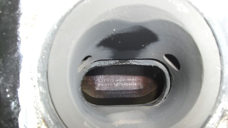

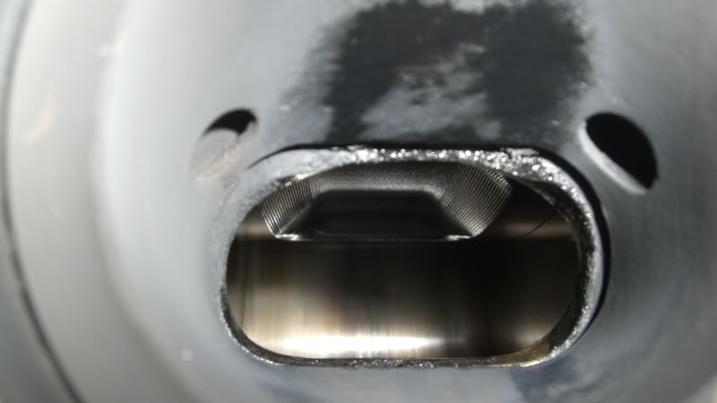

Lastly, you can't pull the manifold without checking out the inside of the engine through the exhaust ports. Everything looks great, almost no carbon!
Front rotor:
Rear rotor:
Front rotor:
Rear rotor:
