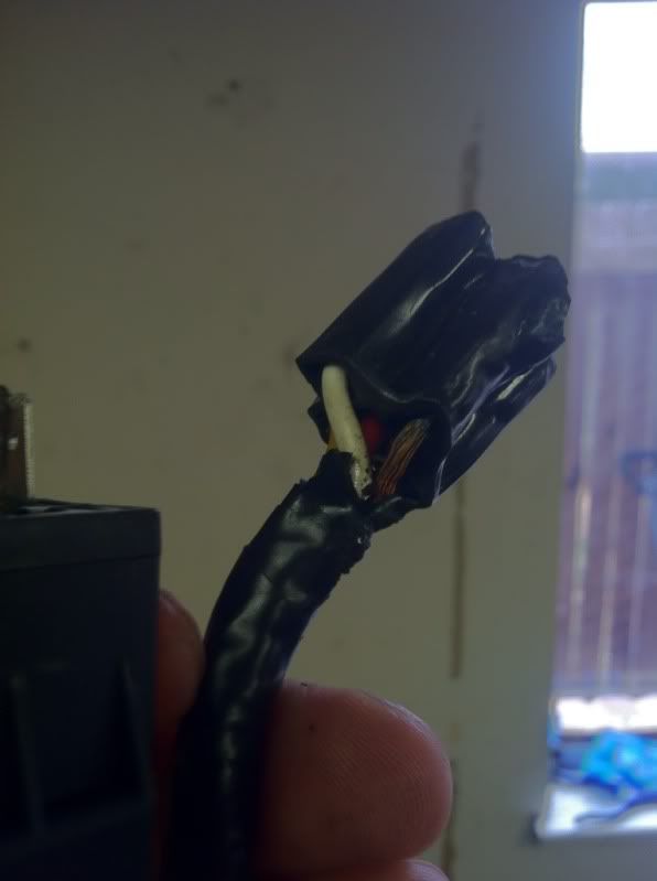

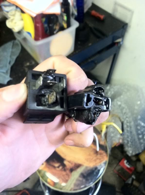

Although I feel like a true FD owner after today, I broke down in the middle of the road for the first time haha. I drove to Matt's to show him the car and hang out, I went to go leave and she wouldn't start...didn't even sound like it wanted to fire up. Fuel pressure gauge on the AEM FPR is reading 0...so I check the fuel pump fuse, all good. Jump the fuel pump to ground in the diagnostic port, nothing. Hmmm
So we removed the fuel pump access cover to check the wiring and relay. Holy shit it's basically melted!!!! Wtf? I wiggle the connector and push it back on, seems to work for now. So I fire her up and get on the road for home, I figured it would hold since its only a 15 minute drive.
Nope! On 287 I'm cruising 60mph and I feel it cut out. No power. Luckily I was going 60 and very little traffic so I could coast for a while, made it to a side road and pulled off into the shoulder. I pulled the fuel pump access cover and this time the relay and it's connector is too hot to even touch and just a melted molten plastic mess. Luckily I had my roadside tool bag with me with some spare wire. So I ran it from the battery breaker directly into the electrical bulkhead pass thru in the fuel pump hanger. Pumps would always be on but it was a temporary solution to get me home and it worked haha.
So before the Rist Canyon cruise in 2 weeks I'll have to re wire this and replace the relay. I'm doing it super overkill this time, at least 8g or 4g cables from the battery straight to the fuel pumps and relay, no dinky wire.
What's crazy is the wire obviously got hot enough to completely melt the relay and it's connector, but the wire looked fine, and the 30 amp fuse didn't blow either. Odd. Oh well, the next irritation of the fuel pump re wire will be massively over engineered.
