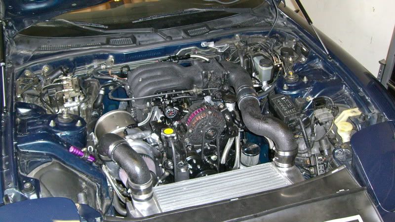

I'm guessing it is in the thread already, but since I can't see pictures at work, do you have a nice shot of your engine compartment> IF so, I'll check it out on the home computer.
I'm getting attracted to the idea of a shave and tuck. I'm not sure how serious I am as it would require loads of work and put the car down for a while. I don't think I would be able to take it as far as the picture below, but I find it very desireable.

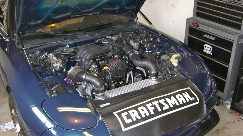

Shadow, here is a current pic of my engine bay:
It's not tucked by any means, it's something I'd really like to eventually do though. I'm also getting a little more adventours and deleting things I deem "unnecessary" such as the old school, 3-channel ABS module, hard lines for the ABS, etc. I think that will clean up the engine bay much more.

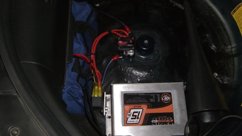

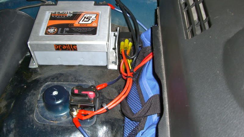

So last night I wanted to finish the car so I removed the fuel pump hanger assembly and re-did all the wiring in there with the high quality 10g wire and crimp connectors I sourced for the relay system. I also drilled a hole in the hanger top and ran a bolt through with PLENTY of sealant as a grounding stud for the pumps. The grounding stud is then grounded with a 4g cable to the chassis on a clean ground (verified with the trusty multimeter).
I ran everything through the grommet in the fuel pump access cover and connected it all, put the cover on then tested the system. Key on, I could hear the pumps prime and saw pressure, so I knew it was functional! I decided to ground the fuel pump circuit in the diagnostic plug under the hood to double check- all good! My fuel pumps even sound a little different now...like they're getting full voltage and amps for once! I let them run on full blast for a minute or so, the new wiring and relays didn't even warm up!
Anyways, like I mentioned earlier, I had planned on taking pictures of everything, but I spaced it and just wanted to work through, so I didn't. But here are some installed pictures:
Overview of the battery in the spare tire well (soon to be copied by Eric) with the relays mounted on the battery brace:

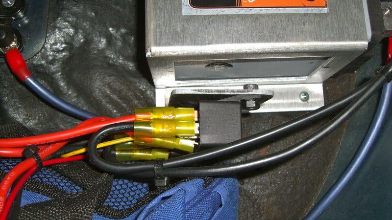

Close up of the relays, bracket, and wiring:
