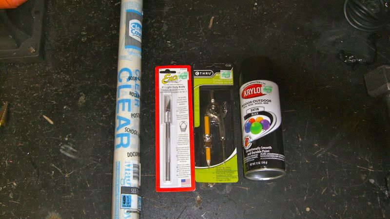

So I finally got around to doing something I've always wanted to do- convert the tail lights to 99 Spec. It's fairly simple to do- I followed the write-up Rotary Addicts which was really good.
I did do a few things differently than the write up; I didn't use Contact Paper brand adhesive paper because the only roll I could find was huge and $10 bucks, so I got the off brand roll for $4 bucks at Hobby Lobby.
Also had a HELL of a time cutting out the circles with the compass! First compass I bought was the cheapest one and broke basically immediately. So I went back and got a slightly better compass only to find out it wouldn't fit the hobby knife I bought...FML. I found an old roll of tape that had the diameter I needed and I STILL couldn't cut perfect circles.
I had all but given up until my wife was able to draw the circles with the compass and then cut them out by hand...wife to the rescue!! I then got to work removing the lights and taking them apart.
First, the supplies (don't EVER buy that compass pictures, it's HORRIBLE):

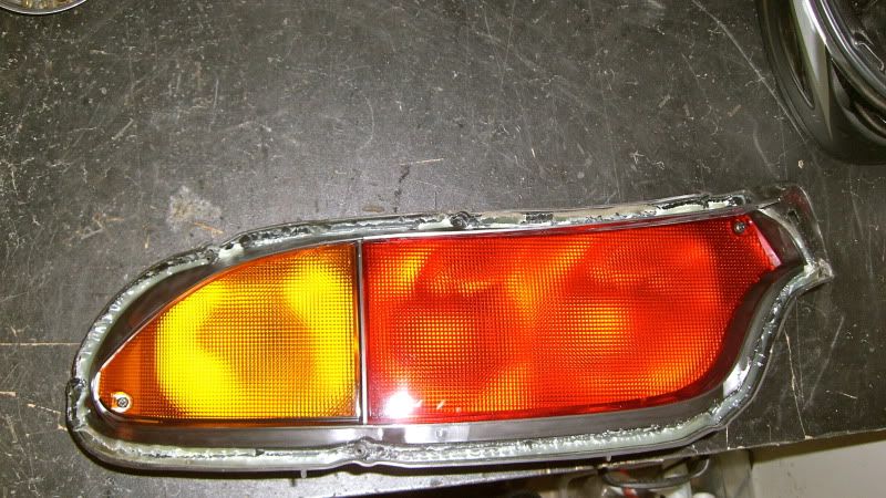

And my stock tails on the car:
I used a heat gun to soften up the glue and pulled the lights apart, took about 3-5 minutes. They pulled apart pretty easily, and this is the result:

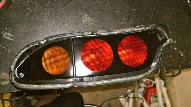

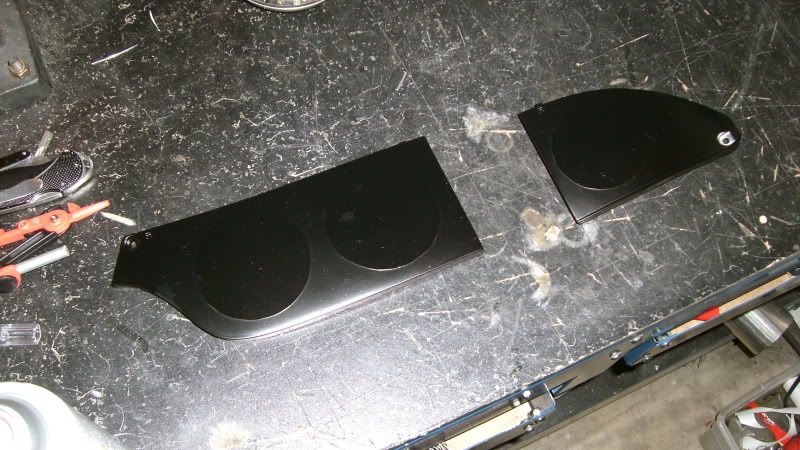

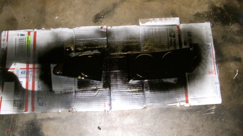

You then remove the lenses with two corner screws and pry them out. I applied the circles my wife had cut out and placed them as accurately as I could. Then hit the lenses (front only!) with multiple layers of satin black paint:
And dried:
I let the lenses dry in front of my shop lights for an hour or so and then carefully removed the adhesive papers. The lenses got placed and screwed back in their respective housings:

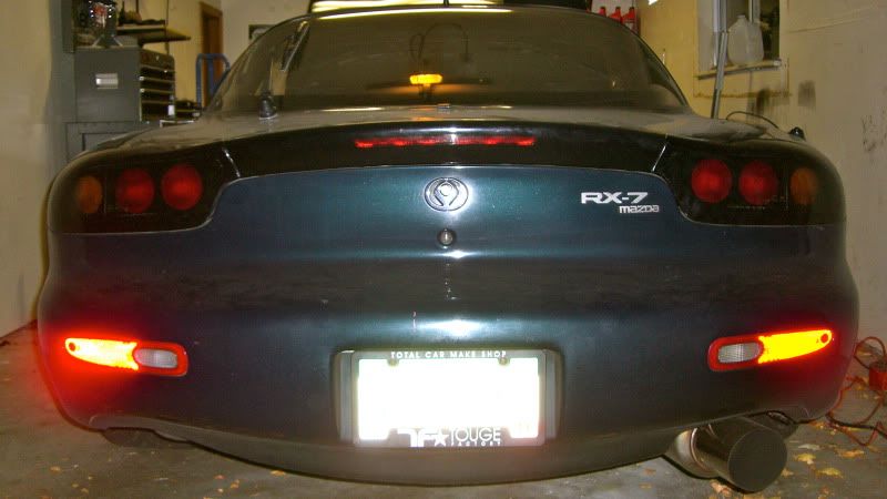

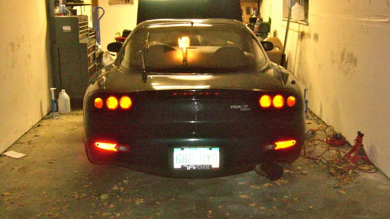

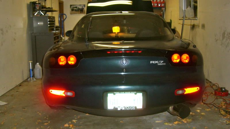

And on the car:
It's dark outside so I'll get some better pics tomorrow, but this gives you a good idea:
Lights off:
Running lights:
Running lights and hazards:
And dried:
