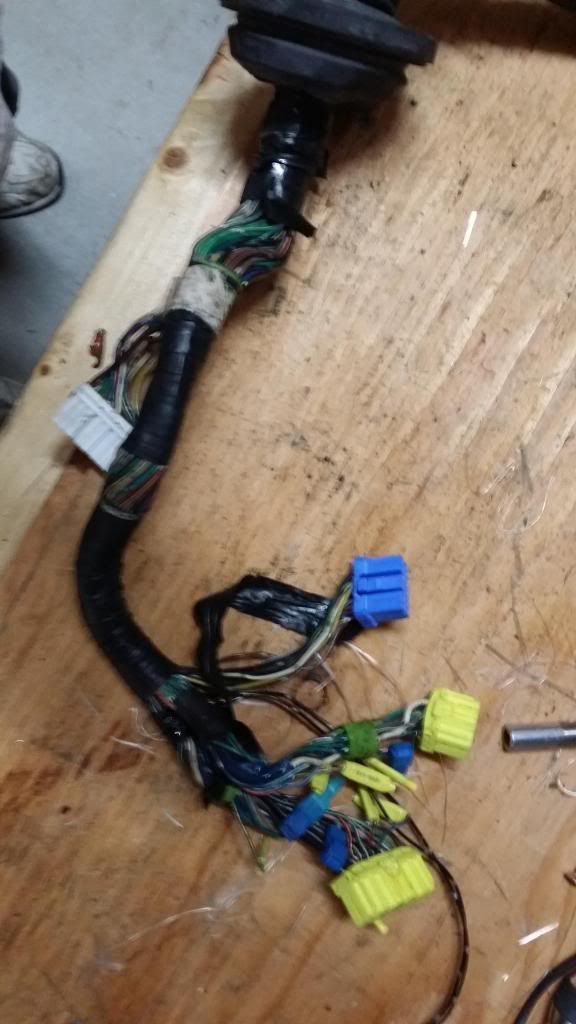

Take a look at the connectors on this one that just came out of my car compared to the other one up above. This one doesn't have that giant blue connector, just the ones that go to the ECU and that white one up above...
Postby speedjunkie » Tue May 06, 2014 9:14
Yeah that's definitely different. I guess you can hook it up and see what happens lol. Have you looked online or on 7club or RCC to see if anyone else knows the difference?

Nah. It doesn't really matter right now since I have 2 of them hahaha. At some point I'll post on the other forums though to see what's up.
Postby speedjunkie » Wed May 07, 2014 9:14
Which one is in better shape? I'd use whichever one that is as long as it works with the car.
Postby speedjunkie » Wed May 14, 2014 9:14
I saw a thread on RCC.com about the differences between auto and manual harnesses. You can use an auto on a manual car but there is some work involved. Talk to theorie on that forum, his name is Tom.

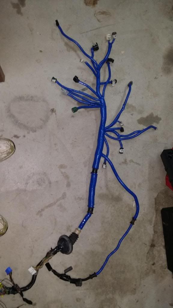

Hmmm... Well, I ended up just using the one that was in the car instead of the extra. I know I'll be able to plug this one back in once I'm done slimming it down and making it pretty. I might re-wrap that oddball harness and just try to sell it when I have a fire sale on all my stock parts.
So far I've removed all the split loom and electrical tape from the harness I'm using. Now I have to remove the the wires and connectors I won't be using, put the new injector plugs on, and wrap it all back up.

Well I've pretty much finished the wiring harness. The only thing left to do is snake my boost controller wires through it and wrap that part up. Hopefully I didn't take out any wires/connectors I am going to need...

Looks good!
Mazda definitely didn't make it easy on us with those OEM connectors. Some are difficult to disconnect (without potentially breaking them) and a few even look alike.
Too bad they couldn't utilize GM-style connectors...those are soooo much easier to work on and are dummy-proof.

Thanks man. I'm pretty happy with how it turned out. Much better than the brittle burnt crap that it was before.
I agree... Mazda did not make it easy. Not only do many of the connectors look alike and are relatively close to each other in the harness, trying to figure them out by the wire colors is pretty annoying. It seems like about half of my wire colors were the ones documented... The others were WAY off of any information I could find. So... Like I said... hopefully I didn't cut out something I need!!! hahaha
