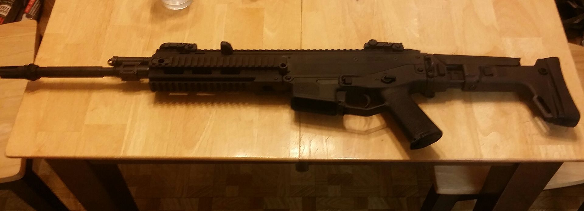

Here's the ACR.

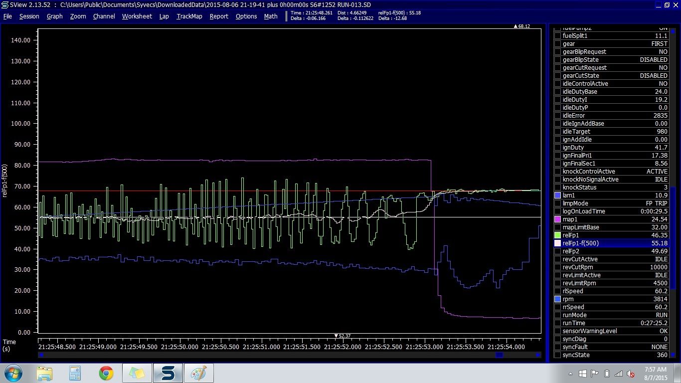

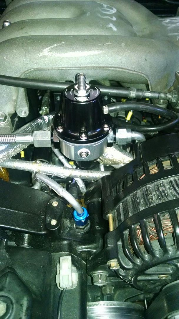

And Chris emailed today and said I may want to get a new FPR sooner rather than later. He is still having problems with the turbo speed sensor at cruising speeds so he took a log and sent it to Syvecs and they emailed him asking if he'd seen the fuel pressure haha. In the pic below you can see the green line is the fuel pressure at 10psi of boost, and it SHOULD be a fairly flat line. So he ordered a Turbosmart FPR for me and I'll worry about mounting it when I get the car back.

Chris texted today and said the new FPR is installed and it's working well but he's going to do more testing, but for now the log looks good from regular driving. I'll have to hard-mount it still (unless he rigged up a mount) and install the pressure gauge.

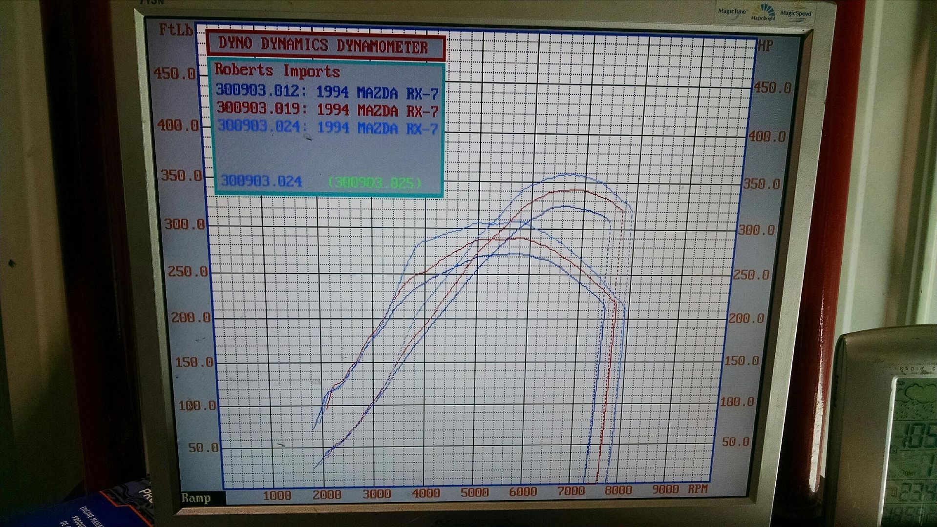

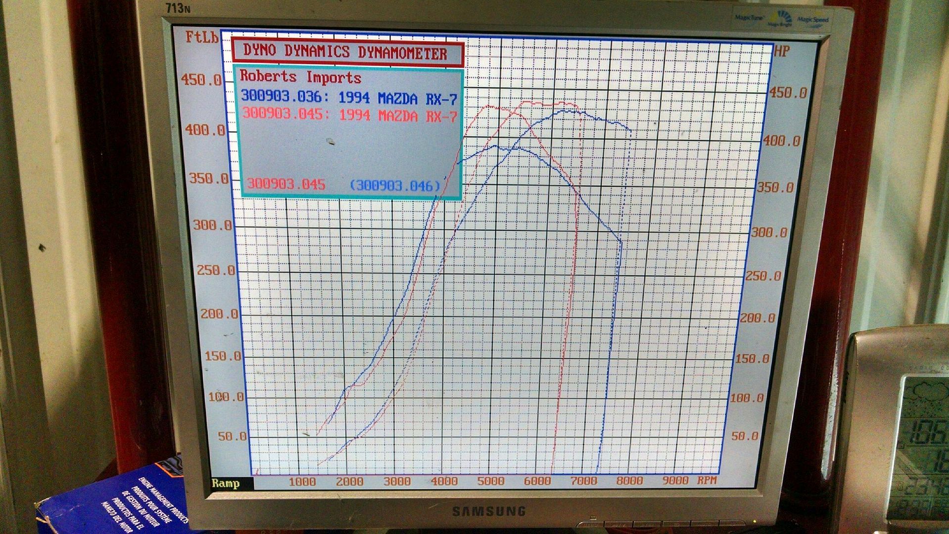

Alright, now onto the big news. Chris texted today with the dyno results, from a heartbreaker Dyno Dynamics dyno. Sure, I could cry about low numbers, but I'd rather they be more realistic than inflated like Dynojet. Although I'm not really sure which ones are more realistic to be honest lol, but at least if you say it was on a heart breaker there is a chance they could be even better and people won't say you're being too optimistic. One note though, these pics show numbers lower than what he told me, but I'm just saying what he told me. Maybe it reads 10hp lower or something.
On pump gas it made 370whp at 16psi. I figure that's not too bad considering it's pump gas and I was running 24psi previously lol. He said it would be about 415 on a Dynojet. These three pulls are at 12, 14, and 16psi.
On E85 it made 450whp at 20psi, and when he turned it up to 24psi it had ignition breakup. I asked him how I could fix that and he hasn't responded yet. I don't know if he's going to look into it or let it go as is. He said this would be 500+ on a Dynojet. These two pulls are at 20 and 24psi. He accidentally erased the 16psi plot.
All in all, I kinda wish the numbers were higher but I'm not really displeased either. Those boost levels are lower than what I was planning on running, but he told me he has it set at 14psi for an every day pump gas tune and he believes that's a good idea to stay there. What I'm REALLY happy about is the curve, until it hits about 7k anyway and drops off. He said that's due to the stock ports. I told him the street ports were the same way before and I thought it was the turbo running out of breath, but he said the turbo still has more to go and said it's definitely the stock ports. Either way, the numbers are only one part of the equation, and even then they aren't that bad.
