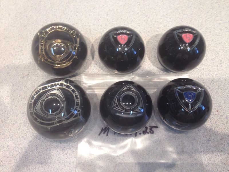

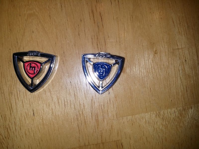

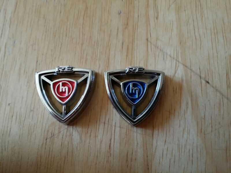

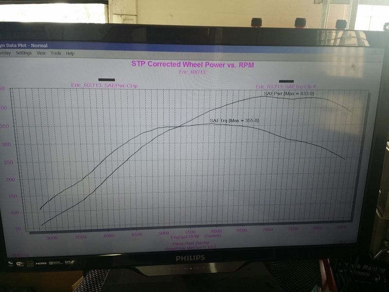

I got the last two keychains yesterday, modified them last night, and shipped them off this morning. I was able to change the color on one of them to what I feel is kinda close to Mazda blue. It's a flourescent blue model paint and it's darker until light shines on it. It turned out pretty well.
And I keep forgetting to post this pic of the dyno run from last week. I like the power delivery.
I was finally able to pull a vacuum on the AC system today. Last night I hooked up the hoses and air started coming out at the connections for the dryer, so I got two fatter o-rings today. I hooked up the gauges today and didn't hear any leaking, so I started pulling a vacuum. The high side pegged out on vacuum, but the low side only got to about 20hg (30 is max), and it dropped a little from there. I let it go for about 3 hours and it was around 16hg when I closed the valves and turned off the pump. I left the remaining vacuum on the system and over the last few hours it's dropped slowly to about 14hg. I fully expect it to level off overnight. So I'm wondering if it really shouldn't be dropping at all or if there is an allowable amount, but I'm leaning towards the first one, if only because that's my luck lol. I'm afraid to charge the system if it's just going to leak.

The knobs are finished and waiting for payment to be shipped back. I have to find a new buyer for one of them because the original buyer has an S4 and they have a different thread pitch. I had thought about it momentarily before, but I forgot to ask everyone what their thread pitch was and just got them all done in the FD size. Oh well.
