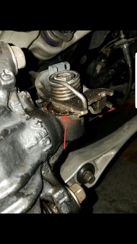

Zico pumped the brakes while I discovered the source of my leak. It's coming out of the ebrake actuator. Ugh. I guess I'll have to rebuild that now too. I'm thinking that will be after the events this Saturday though.

Looks like I might have to wait until Sunday and rebuild the rear calipers again. I can't get the ebrake linkage out past the retaining pin, it only turns so far. And I think that's due to the piston being installed still.

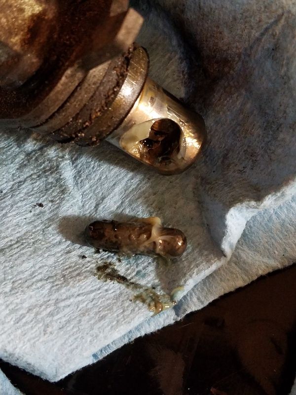

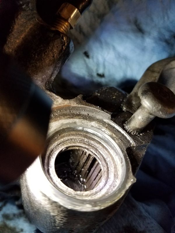

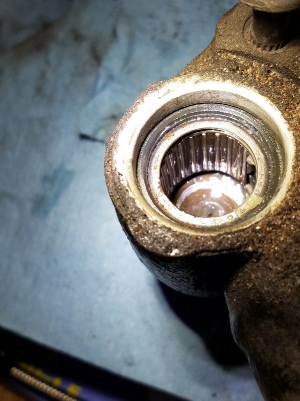

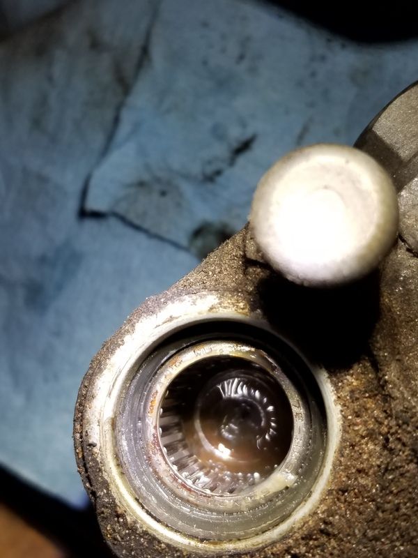

I pulled the driver's rear caliper off on Sunday and started tearing it down. I was checking a thread on 7club that I didn't know about that had just been written when I rebuilt my calipers earlier this year.
http://www.rx7club.com/3rd-generation-s ... d-1099583/
I had to get the special snap ring pliers he mentioned in order to get the threaded rod for the piston out of the bore. I got the pliers in the mail today and started tearing down the caliper the rest of the way. The parts in the driver's side look decent, but not near as good as in the passenger side. And the bearing on the driver's side is trashed too, along with there being a lot of black good in there, it was just nasty in general.
The passenger side parts and bearing look way better. There was still some grease in there too, although it was discolored.
So I'm looking for the replacement bearings, and/or another caliper for parts. If someone local has a spare driver's side rear caliper, I'm interested.
