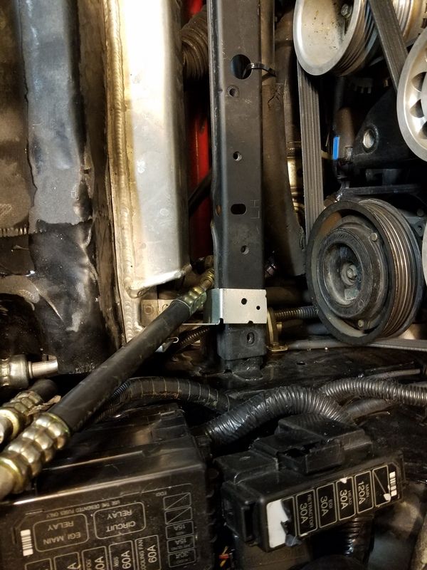

Last night I made some new mounts for the rear of the radiator, only because I found a bracket used in home building while I was at ACE Hardware that would be perfect haha. The only problem is they might be a little too thin. Anyway, I chopped it in half and modified them to work. I might paint them at some point but the one on the driver's side was kind of a PITA to put on, so they'll probably stay this way for a while lol.

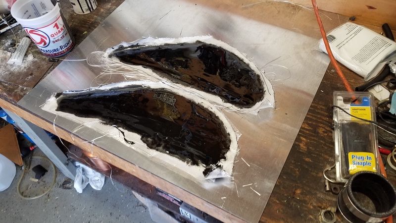

Today I started making the sides for the IC part of the ducting. Here are the two sides for the IC, waiting for them to cure. They don't look like much just yet haha.

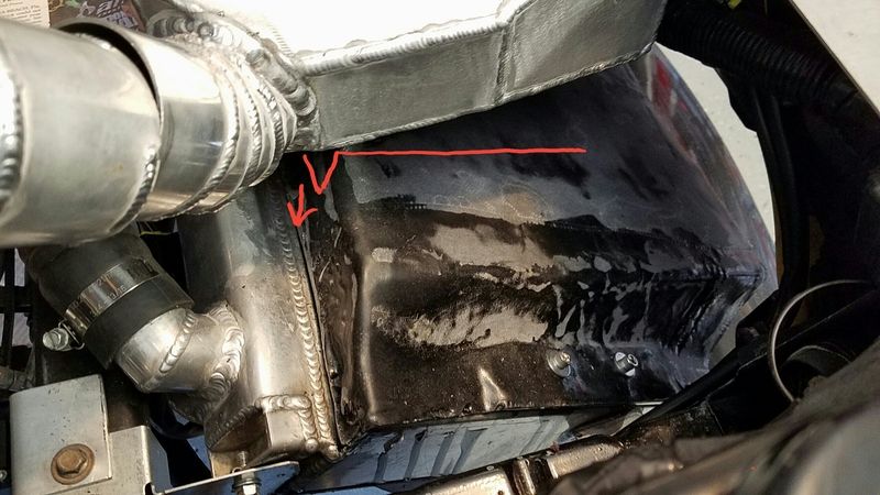

I might be cutting the radiator piece to drop down the middle of it to give more air to the IC. At the rear of that piece it's about 1/4" above the condenser and I was thinking about cutting the back and dropping it down until it's just about sitting on the condenser which would make a trough directed right at the IC. My only concern is if it will push the air for the condenser to the sides since air follows the path of least resistance and the sides will still have more space. I might just leave the radiator part the way it is and block off the back part of it so air doesn't slip past but is caught and pushed up through instead. This is what I mean.

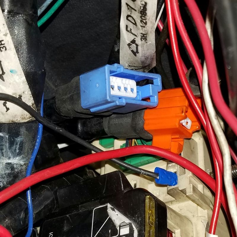

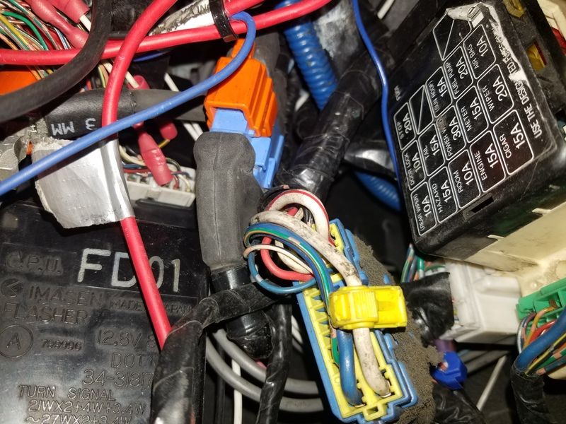

After some more research I discovered why my horns aren't working, X09 is disconnected. I thought what I was looking at went to the crash sensors but those have 3 pins in the blue connector and X09 has 4. So now I'm wondering if I disconnected it for some reason and didn't need to.
Re: Build thread
Postby speedjunkie » Wed Oct 26, 2016 9:14
Horns are working again, WOOHOO!!! I found the connector for those two X09 to plug into and all is good again. Now I just need to fix the water injection, which I'll work on while I have everything torn apart. I'm hoping to take the car out again this weekend though so I need to hurry. I'm also going to pull out the wire I ran from the steering column directly to the two horns while I'm at it.
I'm still waiting on the fiberglass to cure. I put a lot of hardener in and applied it to the fiberglass sheets around 230 today, it's ridiculous. I also had another thought about getting air to the rear 2" of the IC. Instead of making the cut I was talking about earlier and dropping the whole panel down, maybe I'll just cut a hole in the back of the radiator ducting the length of the IC and then duct that up. The air might be warmer since it's going over the radiator or condenser first, but I'm thinking if I'm moving at speed it shouldn't be that bad and maybe any air would be better than none.
