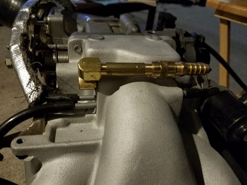

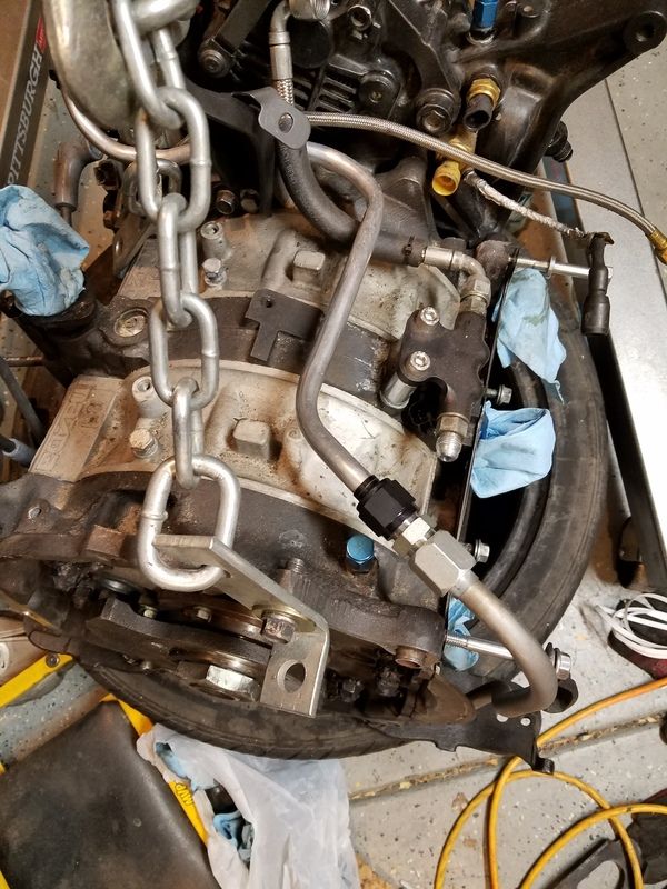

The other day I tackled the oil catch can hard line. I had a small piece of rubber hose on it before but now it's flared and using AN fittings. I stopped by Beauchamp Racing to sand blast my clutch discs (they have enough material left to reuse) and asked Tom about how to flare the hard line since there wasn't a lot of room to get the flare tool on it, and he ended up flaring it for me haha. He does that a lot. So I flared the aluminum line and put a fitting on it. I sand blasted the whole hard line while I was at Tom's and I'd like to get it powder coated again but I don't feel like taking it back off haha. So I guess it's staying on there in raw stainless steel for now.

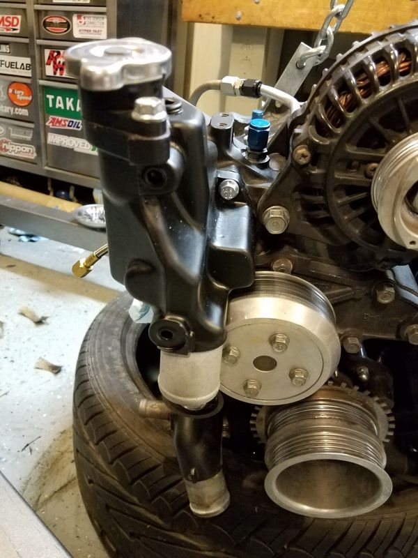

David Motley finished the powder coating on the filler neck the other day right away too so I picked that up and got it installed. I thought about swapping the thermostat since I was in there but I'm always afraid of taking out a perfectly good thermostat and replacing it with a new but faulty one, and this one isn't that old. I may go ahead and order one through Mazda anyway and just replace it.

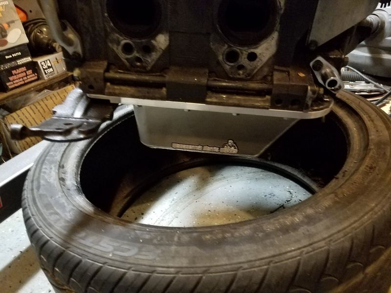

Ok, here is the saga of the oil pan. I got it installed last night, but it was a hassle, which seems to happen more times than not. I cleaned up the oil pan studs and installed them, then I test fit the oil pan onto the studs and it was great. However, I didn't think to install the oil pickup tube and the adapter that came with it before I test fit the pan. I installed the pickup tube and adapter, put sealant on the flange of the oil pan for added leak protection, and attempted to install the pan. Something was hitting and I thought I wasn't going to be able to use the studs because I thought I had to turn the pan to get it around the pickup tube and then align it and bolt it on. So I removed the studs and tried again...something was still hitting. Come to find out the opening in the top of the pan wasn't wide enough and it was hitting the pickup tube bolts. So I wiped off the sealant because it would have dried before I went to install it, and then cut the top of the pan to make room. I contacted Len and told him about the issue and he said they had that issue with some previous pans but thought they had sent out only the fixed versions. He said he'd pay for shipping both ways if I wanted to send it back and get a different one or just have him machine it properly, but I'd rather not because it's not visible anyway and that's just more time I'd be waiting, and it doesn't change functionality any so it's just not worth it.
I test fit the pan and it worked. At that point I didn't feel like putting the studs back in and putting sealant on the pan, mostly because it was already past 1am. So I put the pan on with the supplied bolts and then started installing the engine mounts...fail. I tightened the pan down without making sure the engine mount bolt holes were lined up, which normally isn't a requirement but apparently now it is. So I loosened the oil pan bolts and put the engine mount bolts part of the way in to make sure they'd thread in and tightened the pan bolts back down, and then installed the oil pan. I finally finished at 2am lol.

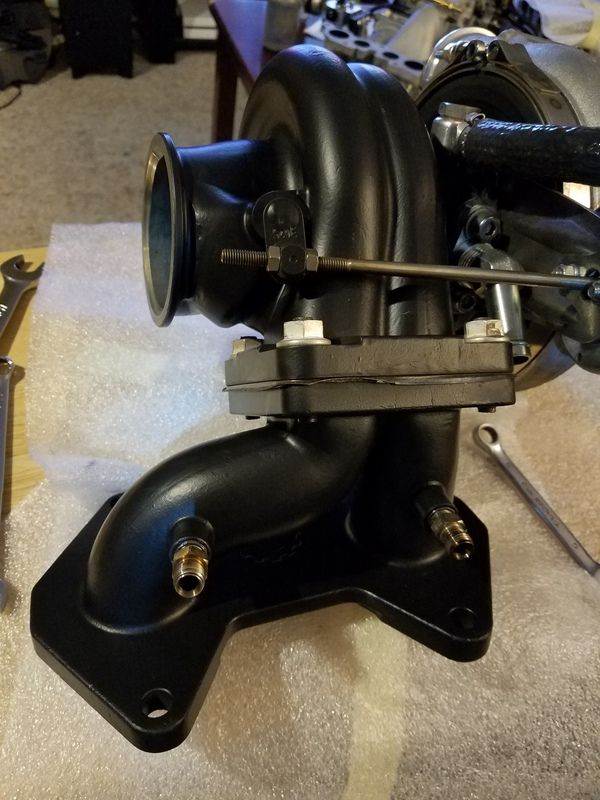

So all the times I put the turbo stuff together in the past I used anti-seize. The problem is I didn't realize there were different temp ratings for anti-seize and I was using the minimum one that uses aluminum and the aluminum was melting and basically welding the pieces together, the exact opposite of what I wanted lol. So I spent the day yesterday driving around looking for high temp anti-seize, and I finally found some at Ford, it's called XL2, it uses nickel and it's good to 2400F. Unfortunately I had already used aluminum anti-seize so I had to remove all that first. I removed as much as possible and used the nickel stuff and put the turbo stuff back together tonight. I also found replacement bolts at ACE Hardware to bolt the turbine manifold to the CHRA, made of the same material although they were either 2mm too long or 2mm too short, so I bought them both and ended up using the longer ones.
While putting the turbo stuff back together I noticed the gasket is cracked in the middle. Oh well, I'm not buying another one unless the middle is missing lol. Actually come to think of it, I really don't want that because it's gonna go through the turbo lol. I may have to look at getting another one real quick.

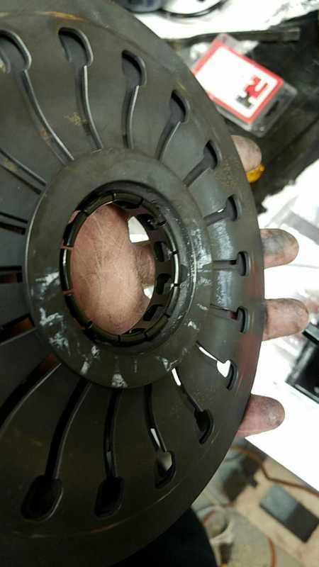

When I took the clutch discs to Tom's to sand blast he measured the mid plate and pressure plate and the pressure plate is warped, so I guess I'll be using the new stuff anyway, and the new clutch parts get here on Monday. At least the current mid plate and discs are still good and I can have them for spares.

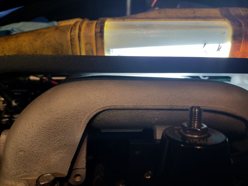

Zico and I got the engine back in tonight and I got pretty far on it. I forgot to check the apex seals while the engine was out but I might go back and do that still. I'm going to order a new turbo flange gasket, thermostat, and a brake booster hose.

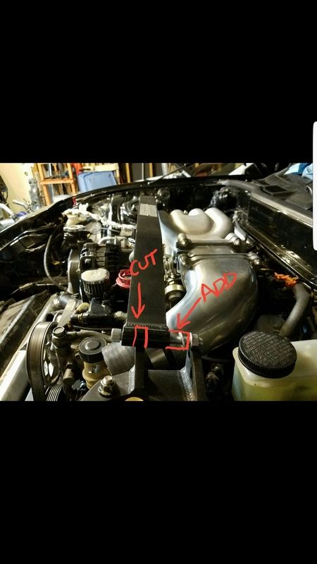

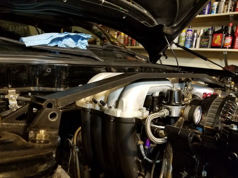

When we first got the engine in I checked to see how much room I'd have for the strut bar, if any. The only problem is the engine was tilted forward so I had to jack it up and guess at where it usually is. I think there will still be room, but not a lot. This is just a guess right here.

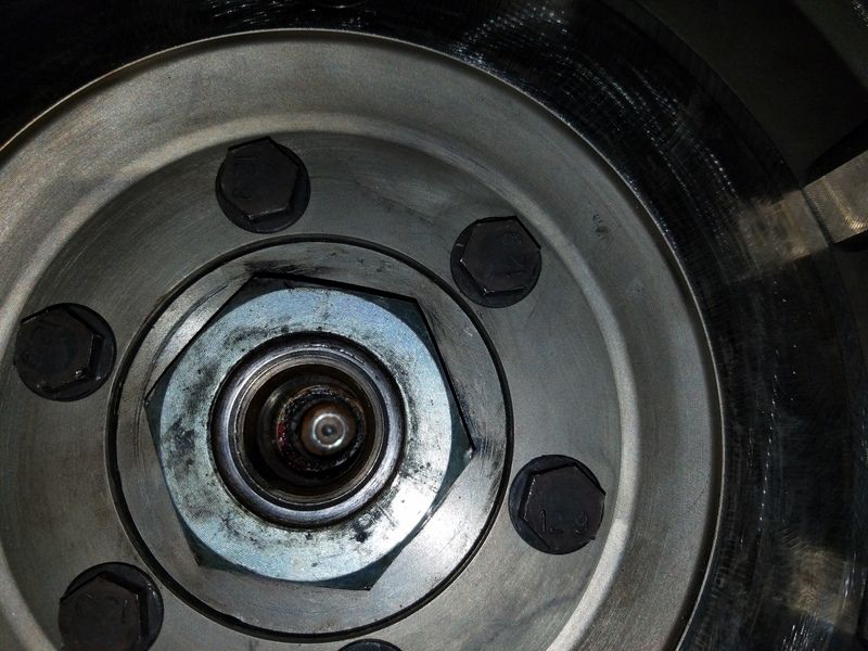

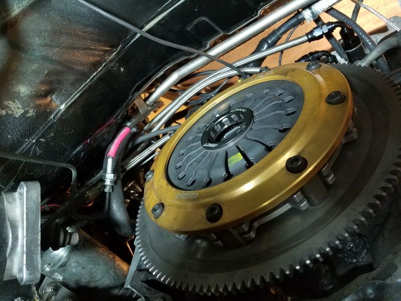

I finished installing the UIM tonight and then installed the flywheel and clutch. And of course I forgot to measure the thickness of a new clutch disc. It's not a must, but I'm curious and would like to have that info. I might take the clutch cover back off and measure one but I really don't want to lol. It wouldn't be too difficult though. I chose not to change the pilot bearing because I was afraid I might mess it up and not be able to get it out or get the new one in correctly. Also because the current one is still in pretty good shape.

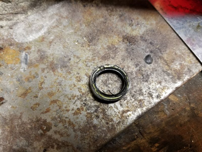

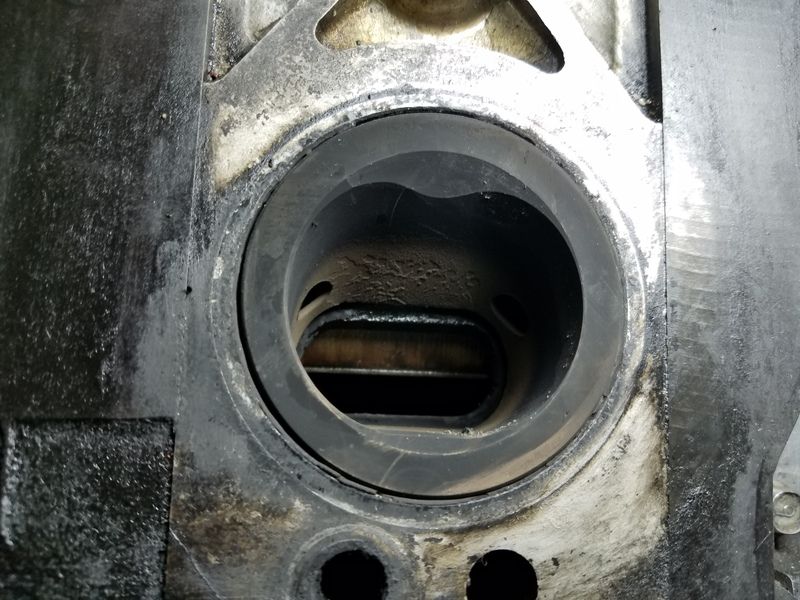

I found something tonight that I find a bit concerning, but maybe it's nothing. I was turning the engine over and checking the apex seals and noticed quite a bit more oil in the rear housing than in the front. I'm wondering if that's a sign of a bad oil control ring or if it's ok and the oil came from somewhere else. I didn't tilt the engine while it was out (other than the little bit of tilt while removing and installing) because I didn't want oil and coolant making a mess everywhere, so I doubt it ran into the rear housing from somewhere else while it's been out.
This is the front housing.
This is the rear housing.

Could that just be caused by excessive premix?
- Posts: 5365
Re: Build thread
Premix is blue and I doubt it because it gets burned right away. Plus I should have it in the front housing too. Jesse said it was probably due to the oil filter passages. I'm also not losing any oil, none that I've noticed anyway. So as of right now I have no reason to think anything is wrong. Other than excessive smoke lol, but that is probably due to all the premix.

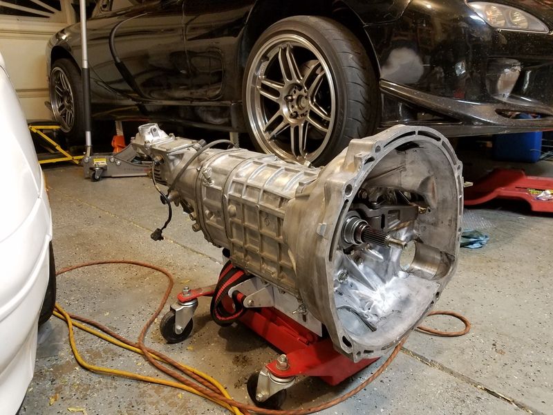

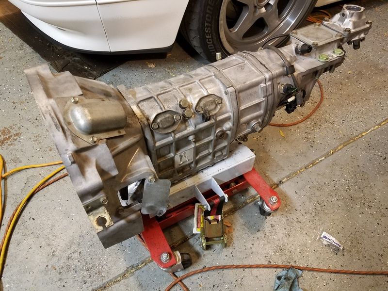

I got the USDM tranny ready to install. I drove around looking for 9/16-12 set screws to replace two sensors on the tranny that I don't use anymore, but it turns out that's a really odd size. I ordered a couple from Fastenal but they won't get here until Wednesday next week. And now I'm not even sure they'll work because I got a couple bolts in that thread pitch from ACE and they won't thread in. One of the sensors had broken wires so I cut them off and I'm using it as a plug. I might just try to find another bad sensor and do the same for the other hole instead of using the set screws.

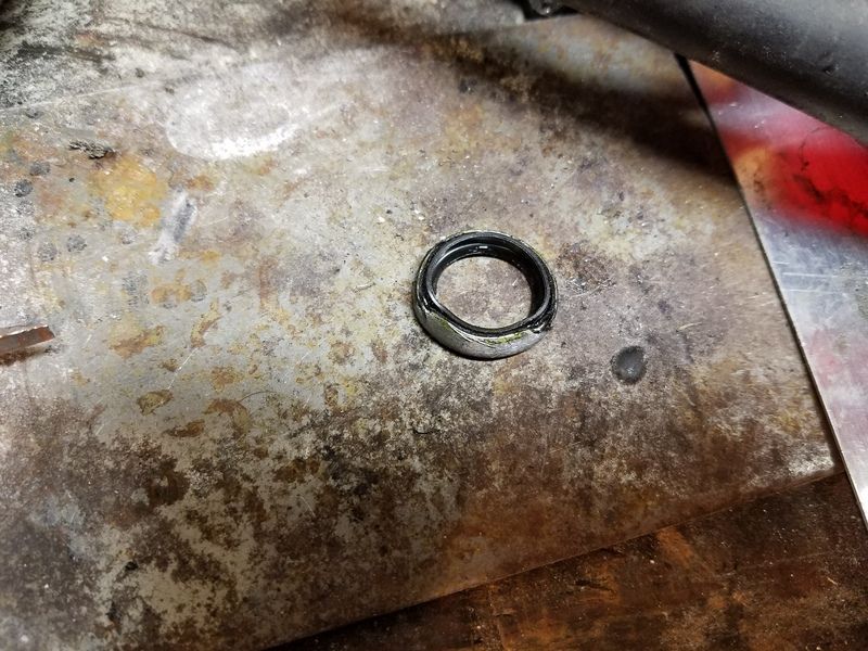

Well I THOUGHT I was going to install the tranny tonight. I started pulling the pilot bearing, or trying to, with my blind hole puller. It's crap so I rented one from Autozone and got it pulled eventually. As it turns out I was pushing the puller in too far and getting back to where the hole narrows down. Once I figured that out I was able to get it out. This pic isn't great but it kinda shows what I'm talking about.
Then I started installing the bearing and seal. In the past I always installed the bearing first and then the seal separately. I didn't know until tonight how great an idea that was lol. I tried installing them together at first and then decided to do them the way I used to. The bearing was still sticking out about 1mm when I started using the seal again. Bad idea. The Advance Auto on Pikes Peak has one so I'm gonna pick that up tomorrow morning.
I also measured the clutch disc and it came out to .185", and the used discs were .145" and .150". I've looked for installation instructions since none came with the overhaul kit, but haven't found anything yet. I think it's pretty straightforward aside from a couple small things but I'd like to get rid of the noise I get while the clutch pedal is pressed. I know you have to offset the discs but I'm not sure if you're supposed to install them facing a certain way, and they're numbered but I'm not sure which sequence they go in, so I installed the number 1 first and the number 2 second lol. Hopefully that's right.

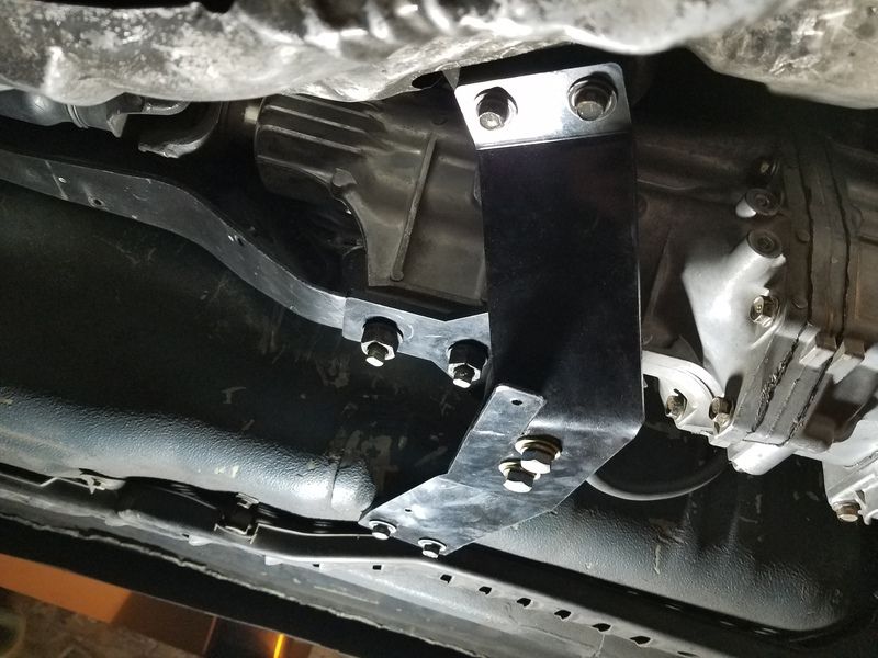

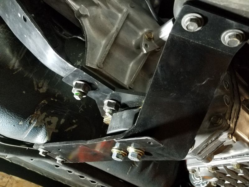

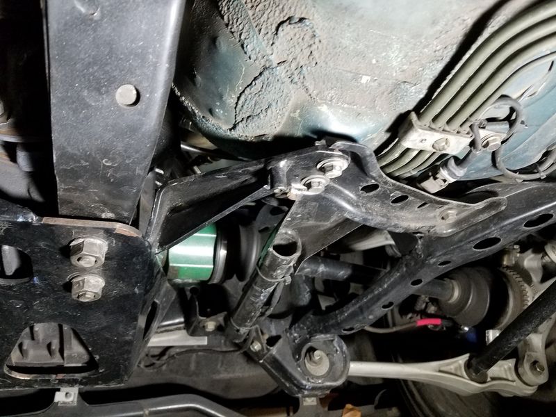

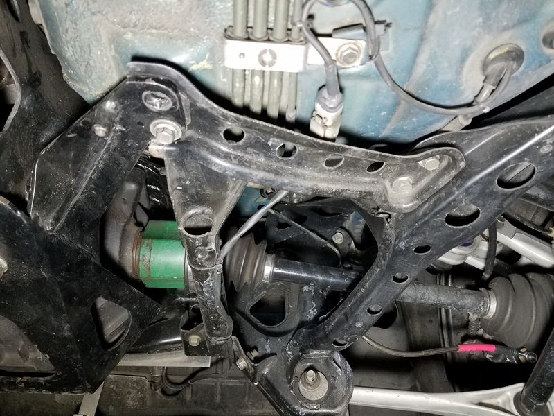

I started installing the tranny and had some issues getting it to pop in all the way. I was tightening the bolts on the bottom and it looked alright, then I saw that the top was still apart about 3/4". YIKES. I eventually got all that in though too. And then it was a PITA to snap the throwout bearing into the ACT Monoloc, but it eventually snapped in. As I was bolting the diff brace to the bottom of the car, one of the bolts stripped in the hole. I tapped the hole and cleaned up the bolt with a die, and after that it just slopped around in the hole and wouldn't tighten down at all. I even tried a completely different bolt and that didn't work either. Fuuuuuuuuuu
Here you can see it on the upper left side of the pic.
In this pic you can see how much I had to open the hole on the diff brace a few years ago when I installed it, and also the bad threads.
One up side is the tranny brace fits pretty well, even though I still shimmed the diff brace.
Unfortunately, the strut bar isn't even close to fitting.
I'm thinking about having it modified to fit like this. Cut out the part up front and add to the rear part. Or just cut the mounting spacer off and shift it back, and then add another one to the front. And just use longer bolts.

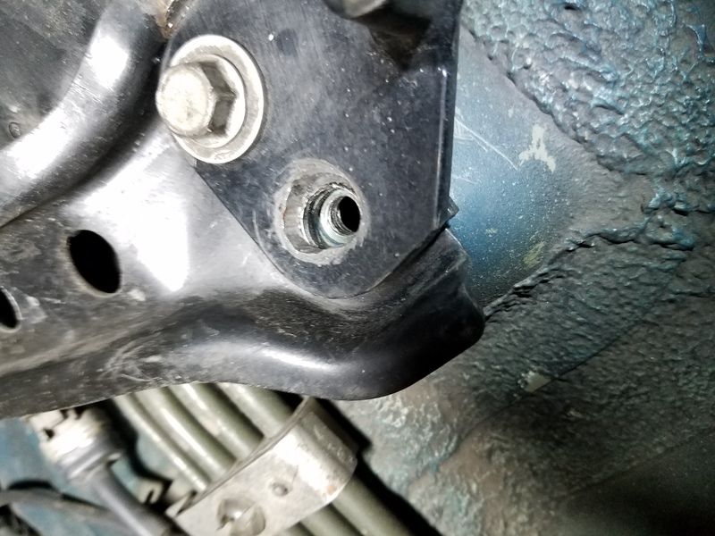

As I was finishing bolting the bracing to the bottom of the car, I found another bolt and tried it in the stripped hole, and only by the grace of God, it worked! I didn't tighten it down as tight as the others just in case, but it's still pretty tight. So I'm super happy about that.
I got the turbo gasket today and swapped that, so the turbo is ready to install also. That will be tomorrow night I suppose, along with filling the engine and tranny with oils. I have to wait with coolant because I still don't have the thermostat.
