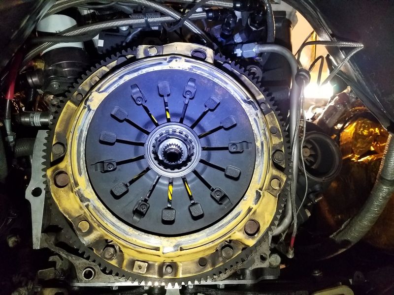

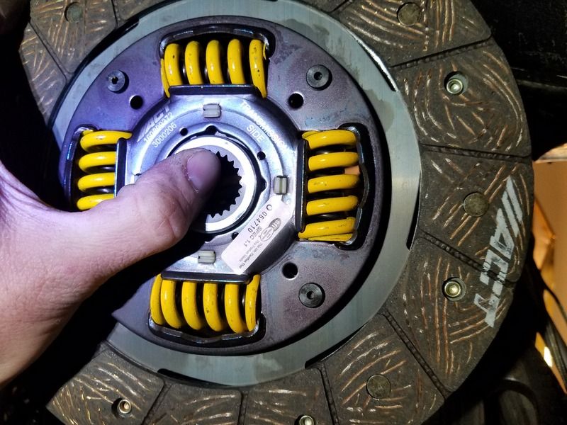

I started pulling the tranny yesterday but didn't get very far. Before I pulled too much out I decided to see first if I could separate the throwout bearing from the clutch, since it was such a pain to engage it. Well, that didn't turn out so great. Zico pressed on the clutch pedal while I pressed the Monoloc forward. No deal. So I cut excess length off an allen wrench so I could fit it through the inspection port and into the bolts and removed the 9 bolts holding the clutch together, and as I did it, pieces of the Monoloc that had broken off were falling out and hitting my glasses. So it looks like that's $60 down the drain, definitely going back to a stock assembly. Up to that point I had thought about just pushing it all back together and just dealing with the harsh engagement, but I'm glad I decided against that. Separating the clutch was as far as I got last night, and I was going to work on it today but I've been sick the last couple days and I'm sore today. Hopefully I will get over this and get back to wrenching soon. I can't stand letting this good weather go to waste.

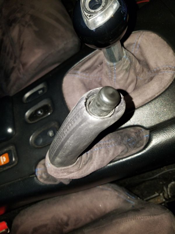

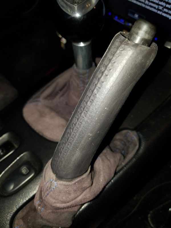

As for another small project, I've been looking again about doing something with the ebrake handle. A couple of the libraries here in town have 3D printers but that might be too involved. I'm thinking about making a mold to make it out of resin like the shift knob, but I'll have to cut off the back half of it because it curves down on the back half and I can't slide the whole thing down in one piece, and the back half I'll probably have to cut into two pieces as well and glue them together or something. I'd like to customize the ebrake handle as well, maybe with my screenname or something, but I'm not sure on that yet.

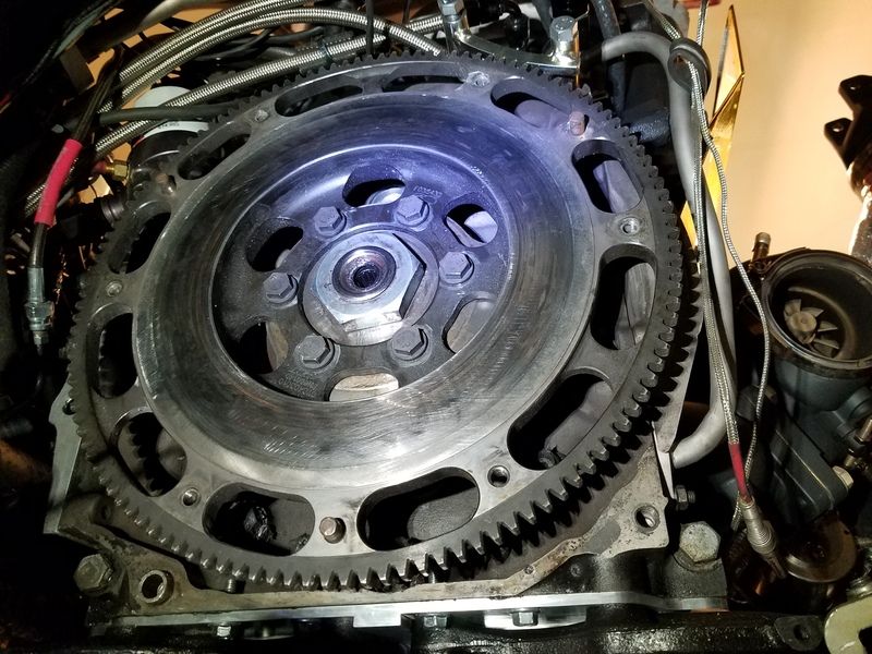

I finished swapping the clutch today. The only thing I didn't do is install the shifter, that's tomorrow.

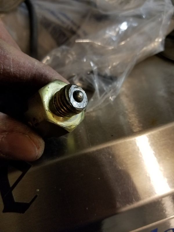

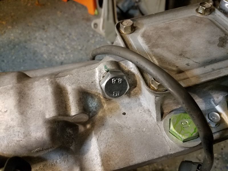

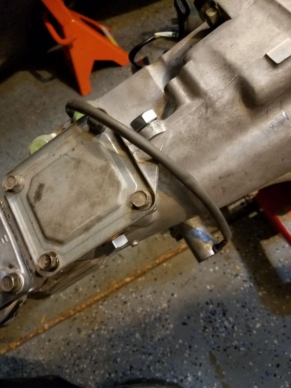

I discovered why the set screws I ordered from Fastenal won't work to plug the sensor holes on the tranny. It's because they're the wrong thread pitch lol. I was wondering why a Japanese transmission would have standard thread pitch. They're actually M14x2.00 instead of 9/16-1/2. So I bought a couple bolts from ACE and cut off the excess length.
I thought I had found the issue with why my tranny was shifting so rough, but then I remembered I pulled it out of the last tranny I had installed. So apparently this happened at some point.
I also discovered that I don't need the piece to push the exhaust down. I rotated the downpipe and now I have room so it doesn't hit the diff brace but also doesn't hit the crossmember that runs across the tranny tunnel. I'm hopeful that I won't hear the knocking sound anymore, but we'll see.

speedjunkie wrote:As for another small project, I've been looking again about doing something with the ebrake handle. A couple of the libraries here in town have 3D printers but that might be too involved. I'm thinking about making a mold to make it out of resin like the shift knob, but I'll have to cut off the back half of it because it curves down on the back half and I can't slide the whole thing down in one piece, and the back half I'll probably have to cut into two pieces as well and glue them together or something. I'd like to customize the ebrake handle as well, maybe with my screenname or something, but I'm not sure on that yet.
I read an article that said that the handle could be separated without damage using a heat gun and some man strength. I don't recall which forum (rx7club I think though). That same thread said that aftermarket ebrake handles were available from mazdaspeed. I didn't look too hard for a replacement handle for you. Seems like something custom machined would be the ticket.

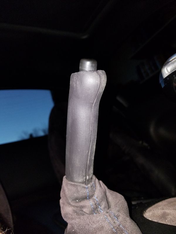

I've had an aftermarket handle for a while but I'm not crazy about it. It's made for a Miata but fits ours as well. To get the stock handle off I slit the length on the bottom and peeled it off like that, after removing the "leather" cover of course. I put it back on today just the way it is and it isn't bad even without a cover, but it's just temporary until I figure out how to make one. I have thought about just having it etched with a design and put it back in lol. I may still do that.
Whether I make a handle from a mold or just use this piece, I'll need to figure out a way to fill in the area around the button.
I've seen that Mazdaspeed makes some but if I remember right they're kinda rare and I'm not really crazy about them anyway. Other than Voodoo, who makes the Miata handle I have, I believe Mazdaspeed is the only company that makes any, and the Voodoo ones are easily attainable.
I drove the car a bit today, and oh my goodness I love this clutch compared to the twin plate. So much easier to drive. There's nothing I don't love about driving it now, except maybe that I still don't have AC for the summer lol.

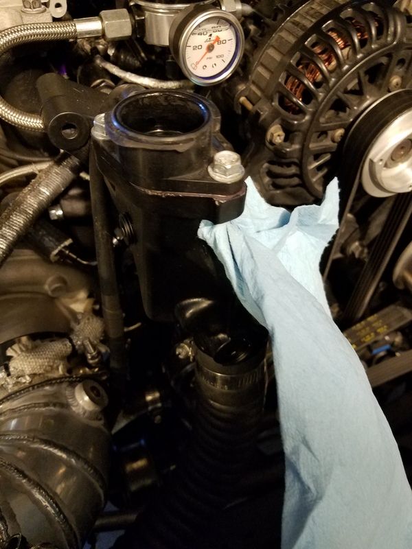

Before taking the car out I remembered the coolant seeping from the front of the thermostat housing. I removed the set screw and used a shop vac to suck out excess coolant, dried it, and resealed the threads using Right Stuff black RTV. It's supposed to set in one minute so I let it dry for about an hour before topping off the coolant and starting the car. STILL LEAKS. So I cranked down on it and it still seeped out a bit. I'm going to run it again and see how bad it is and let it cool down again and fix it if I need to. Ugh.

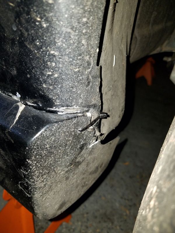

I also used a ziptie to keep the sideskirt from flopping around until I can replace it. Classy! Lol
