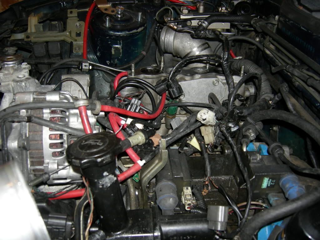

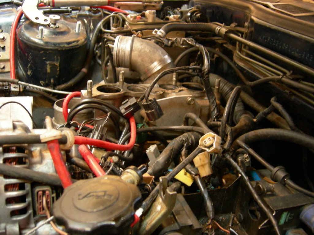

Sooo my car is more messed up than I thought, haha...I've said it before and I'll say it again, Precision doesn't know what they're doing when it comes to FDs, that's for sure. I am continually amazed, that they let this car out of their shop in the condition it's in. Nothing is mounted where it should be...wires and vacuum lines just all over the place. I can't wait to get it hooked up right, probably tomorrow or Sunday. But it's still going to be a mess. It looks like this now...note that the only things I disconnected were the throttle cable and a few sensors. The rest were just like they are.
Most of the crap that is disconnected is emissions related. But, this crap is SUPPOSED to be mounted onto a rat's nest. Instead it's just kind of hanging. I don't know if it was like that before Precision got their hands on it, but my guess is no. Those definitely aren't the vacuum lines I had on there before, because they were blue, not red. Hey Eric, didn't you said you had a spare rat's nest somewhere? If so, I'll buy it off you. I don't want to leave this like it is. Oh and I STILL can't find where that coolant level sensor wire is going. It just disappears under the alternator.

Anyway...I'm finally going through this mess. Basically, most of the wiring harness is not in terrible shape, unlike what I thought...just a few things that need to be re-soldered. Coolant level sensor and several coolant temp sensor lines being part of that (go figure). The big problem, the one that made it look like utter crap, was in the ignition circuit. This is my understanding of it...the car had an FC coil for the leading ignition, which was spliced into the FD harness (they don't work together at al) and ziptied to a fuel line (whoops). This FC coil was being powered by a separate ignition box, since the FC coil doesn't have one / isn't compatible with the FD ignitor. BUT both coils for the trailing ignition were still being powered by the stock FD ignitor, which is still in place and working great. I have no idea why this was done, but it's all going back to stock soon, because right now it's ugly and a fire hazard. I have to get the ignition coil for the leading plugs and replace that part of the harness, which is beyond repair.
The turbos should also be fixed now. Obviously haven't been able to test them yet, but they are hooked up right. The guy who is helping me has an FD with a non-sequential mod like what is now done to mine...I rode in it yesterday, so much better than my car when it was sequential. I can't wait to see the difference...though it'll probably be laggy / have a surge in power, given that my intercooler is way too big for the stock turbos. Is anyone interested in buying a big Greddy FMIC / trading for a smaller one that will fit an FD?
