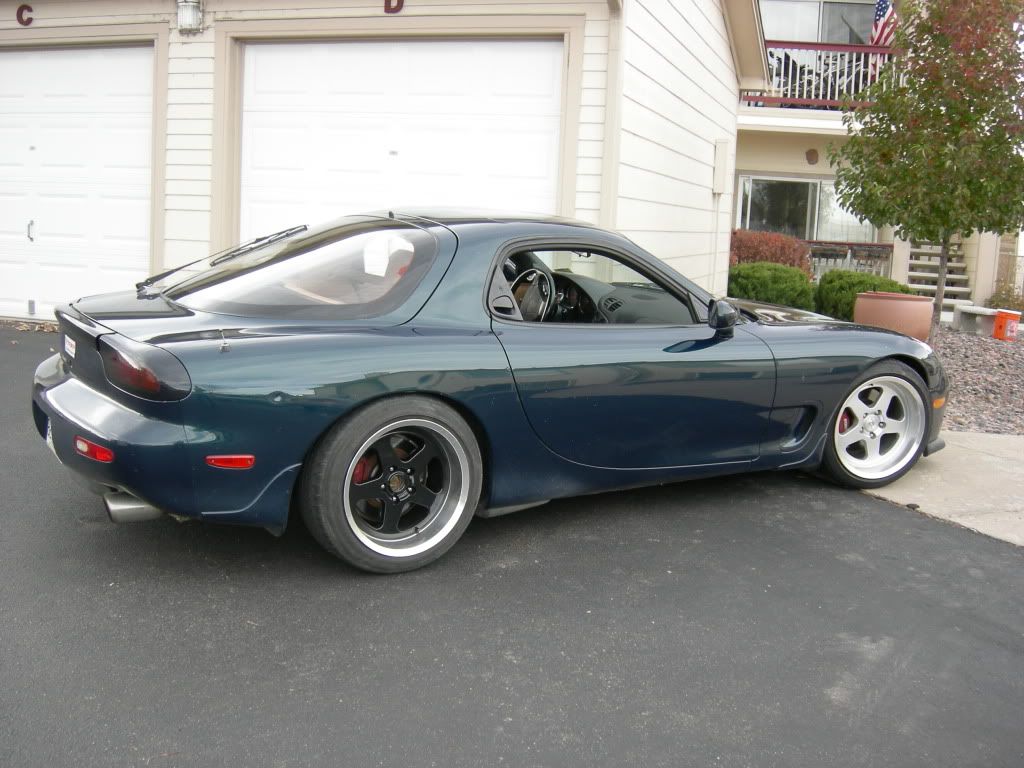

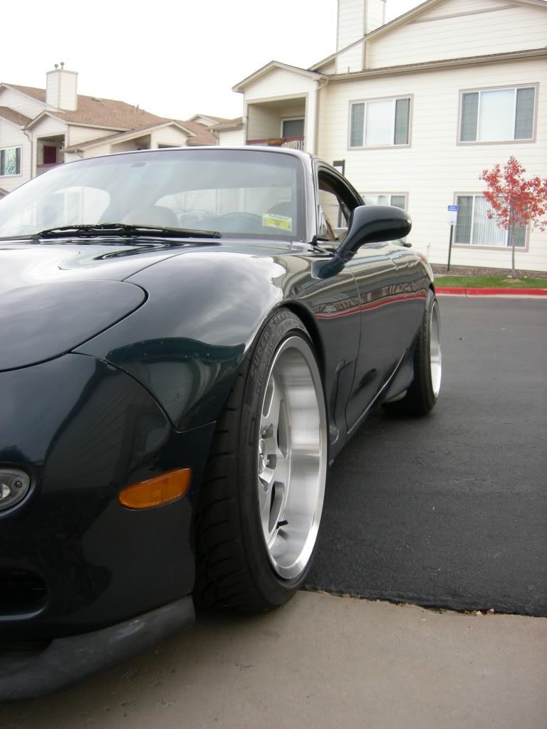

As for pics...
I had planned to get another pair of the silver colored rims as I like those a lot better than the black on this car. I really want to lower it more in the rear too, but I was going to wait until I did the bushings, since I will have to take the whole shock out. (I need to remove some of the adjustment collars in order to go lower.) I don't know if I'll even bother now...

Well damn man that sucks! I like those wheels! Are those 17s or 18s? What brand? I'm about to pick up a set of Work Meisters...18X11 +30 and 18X10 +29, for street wheels. That and I've always wanted wheels with a big lip haha.
Sorry to hear about the 240, too bad you have to get rid of the FD too. If you have any control over it, please make sure it goes to someone that will take care of it.
For what it's worth, I think the stance looks pretty good.

They're 17x10 +20 front and rear, I got them from here:
http://www.cruizinconceptswholesale.com/proddetail.asp?prod=SCSILVER17X105LUG
They are knockoffs of an old Saleen design. Do you have stock fenders? If so, on the front, an 18x10 +29 might work, for these though I had to roll the fender lip and relocate a couple of the bumper mounting points. Anyway I fully intend on buying another FD some day...it's my dream car after all...just not the right time for me to own one haha.
