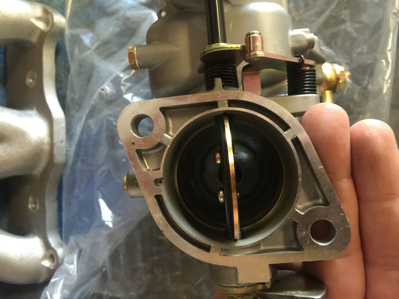

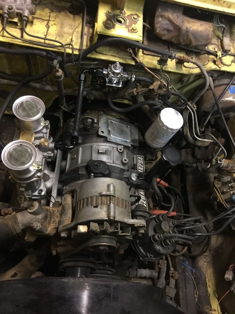

Here's the EMPI (Weber knock off) IDA 51.2mm carb, modified with 3rd progression hole and enlarged float bowl:
I added some mesh screens to the trumpets in favor of air filters. This isn't a daily so I think it will be fine. Under that gold screen in the center is the jets; SUPER easy to change out everything, you don't have to get into the fuel bowl:
Look at all that airflow!
In this I tried to best show how I modified the stock carb throttle linkage bellcrank to the IDA carb. The throttle stop on the stock linkage was facing the wrong direction, so I kept the stock linkage on the carb and put the old linkage overtop. I have to use my hacksaw to cut off part of the stock linkage to allow the throttle cable to slip in and also cut off part of the stock linkage that was hitting the throttle stop screw. Saved me $30 bucks from having to order a new linkage:

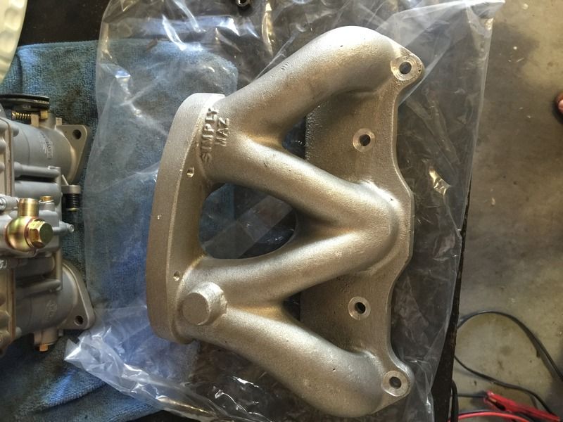

The Australian-made Weber IDA intake manifold:

Got a BLOX billet vacuum manifold so I only have to drill and tap a single fitting on the intake manifold and not run a bunch of tacky T fittings. Mounted it tucked up against the firewall and connected the brake booster and misc hoses, still have more plumbing to do:

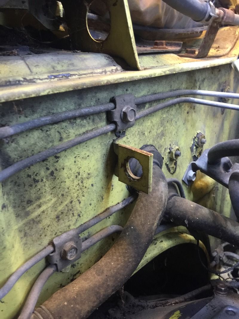

Needed to mounted the FPR...where to mount it? I searched around for a while as aesthetics and proper planning are important to me...so this looks like a good spot, but has a pesky bracket (for the brake booster hardline) in the way:
Well, just remove it:
Screwed the FPR on with the included bracket and some self-tappers. It isn't fully tightened here because I still need to add the hose barb fittings (which haven't shown up yet) to connect the OE fuel hoses:
Overall, despite the fuel tank, I felt like good progress today. Can't wait to get all the fittings in I need so I can slap this carb on try to get it to run!

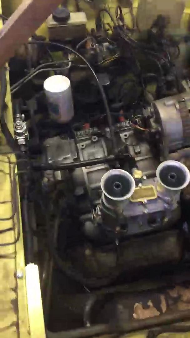

So with the fuel pump disconnected, i hit the starter and this thing wants to run! It stumbles and coughs and fires up after omly a few revolutions. I quickly jump out and reconnect the fuel pump, the FPR says 5psi, and it's running on it's own! Idle is high so I back out the throttle screw and get it down to about 1k rpm.
It's ALIVE!
The best part is it runs pretty good. Obviously needs some fine tuning and has some stumbles, but good. It restarts perfectly and I was able to get it up to operating temperature and it appears everything is good. I'm super pumped and can't wait to drive this thing!

So yesterday I get home from work, throw in the battery and the thing fires right up! Seriously this thing starts goooood. Like little to zero effort. Just one pump of throttle and boom, it's alive.
With it idling I did notice a lot more smoke than before. The owner I bought it from said he had origjnally parked it because it smoked. I also added a lot of 2stroke premix to the fuel, too much, to a ratio of 40:1, so I don't think that helped things lol. Lots of carbon still blows out of the exhaust so I haven't ruled out the exhaust being part of the smoking issue, either.
I realized before when it was running I also had a big vacuum leak, so I fixed that and now it idles even better. I also was able to "drive" it, actually pulled into the street amd drove it around the block for the first time! Holy crap the big wheels rub like crazy! It made a horrible noise when turning so I'll be trimming the fenders to gain the additional clearance. At first I was worried about hacking up the fenders, but honestly they are pretty dented abd banged up as is and I will try to clearance them as best possible.

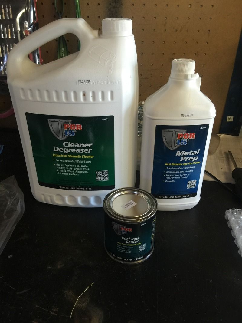

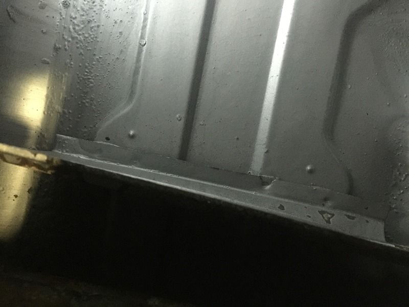

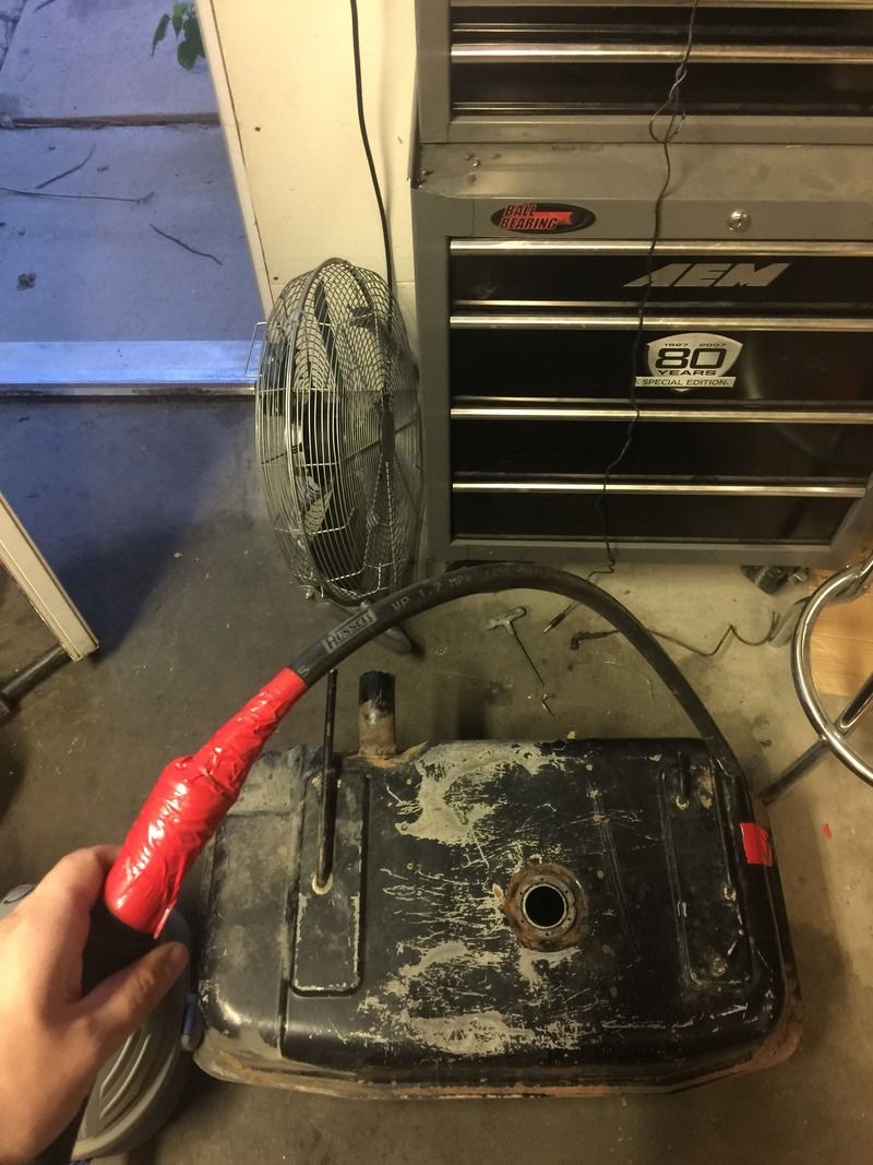

Lastly, I finally decided to go for broke and just do the POR15 process on this fuel tank. I used the cleaner/degreaser which helped a lot; bunch of rusty water and loosen up a bunch scale. After a good rinsing, I did the POR15 Metal prep and that worked real good removing rust. Then rinsed with hot water and got ready for the tank sealer.
Biggest issue I had was getting rust chunks and debris out of the tank, no mater how much I rinsed these stubborn chunks just wouldn't flush out. I tried to stick my shop vac in the fuel sender hole but it was too large (obviously that's what she said), so I got the bright idea to duct tape a piece of 6AN fuel hose to the shop vac hose, which fit perfectly into the tank and let me vac up the rust scale inside the tank. I did this for about 30 minutes, shaking the tank, vacuuming, and repeating. But finally got it cleaned out.
So, remember how I patted myself on the back for "cheating the system" and piecing together my own POR15 fuel tank restoration kit buy purchasing everything individually off Amazon Prime? Well...I did maths wrong. I got less fuel tank sealer because in the video reviews I've found most car tanks only use about 1/2 to 1/3rd of the included quart. So I got an 8oz container, which is significantly less than a quart. So the sealer I got wasn't enough to fully coat the tank, about 2/3rds. Most of the top and some of the internal baffles were left uncoated. So I'll be ordered another 8oz container to finish off the tank.
That's about it, sorry for the long post LOL
Heating up the tank to dry the Metal prep:
My shop vac hose mod LOL
Best shot of inside of the tank AFTER the Metal Prep and PRIOR to the sealer. You can see the tiny rust peddles in there prior to finishing vacuuming

Anyways, I finished the fuel tank a couple days ago. I got more POR15 fuel tank sealant and coated the ENTIRE interior of the tank nicely with new sealant. I snapped a few pics and I think it came out pretty good. I also sprayed some black paint on the surface to keep it looking (hopefully) nice. I plan to get it back into the truck this week and get it filled up so it can finally run on it's own tank.

Here's a pic of inside the fuel tank after doing the POR15 sealant,
There is some slight bubbling but overall pretty happy with the results. Time will tell if it doesn't gum up tho.
