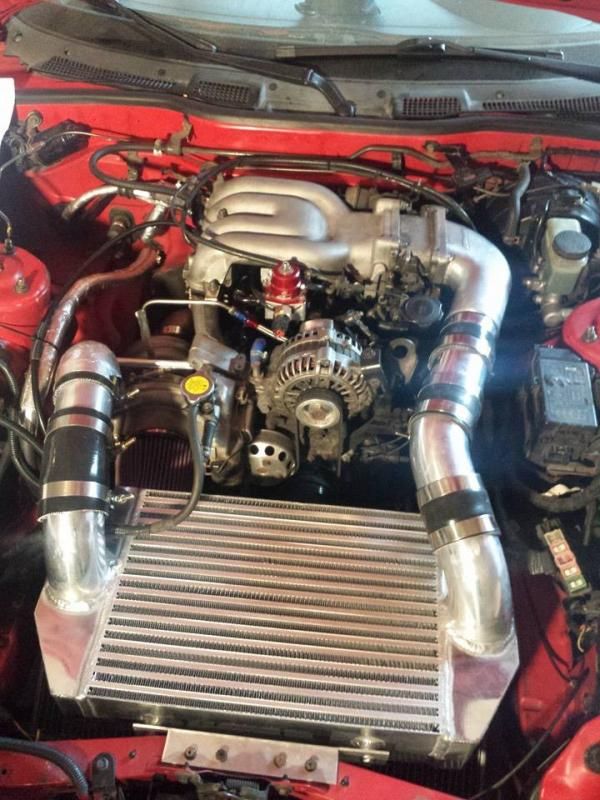

Postby JTurton7 » Tue Sep 02, 2014 9:14
Intercooler pipes almost done, just need to go get the bov hole welded shut. I ran out of cool tape :(

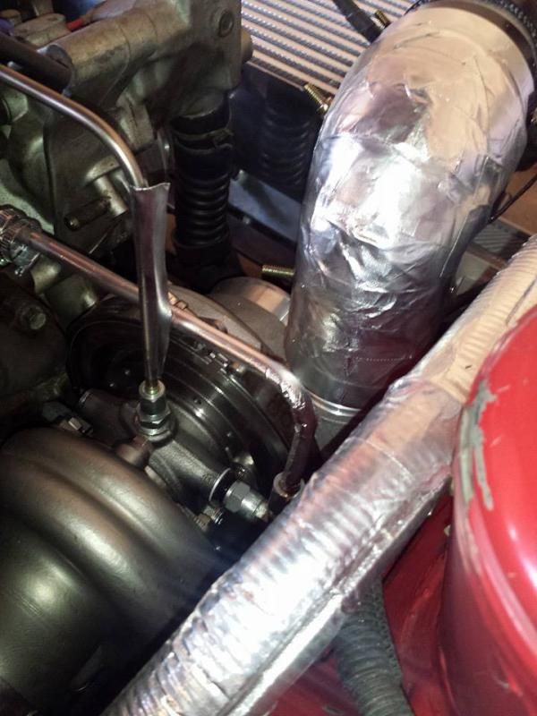

Posts: 5361
Postby speedjunkie » Tue Sep 02, 2014 9:14
Ooh I like the hardlines to the turbo. This is something I've wanted to do as well. Did that come with the kit?

Posts: 5361
Wait, looking at those hardlines again, where is that coolant line going? lol
Also, on the K&N website, did it show that length includes the mounting portion or just the filter? There is usually a guide on their site that shows the dimensions of a, b, c, etc.

Postby JTurton7 » Wed Sep 03, 2014 9:14
it goes to the upper port usually used for the throttle body thermowax thing.

Posts: 5361
Postby speedjunkie » Wed Sep 03, 2014 9:14
Hmmm, I wonder why they chose to draw coolant from there instead of a cooler place, unless that's where it's dumping into.
You do know on the EFR to hook up the feed coolant line on the bottom port and the exit on the top port, right?

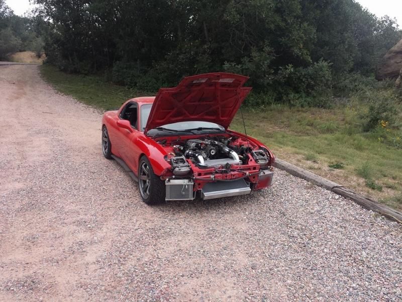

Postby JTurton7 » Fri Sep 12, 2014 9:14
All together and running!
Proof!

Postby FDEEZ » Fri Sep 12, 2014 9:14
Congrats! Another FD back on the road :-)
Posts: 5361
Postby speedjunkie » Fri Sep 12, 2014 9:14
Sweet! Congrats!
