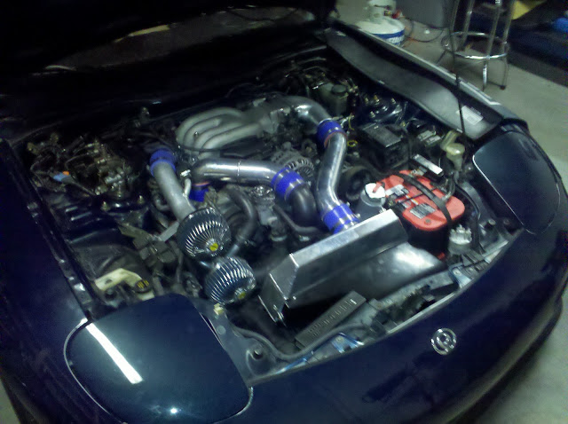

Finally got the missing couplers required for an install finished up the Pettit Charge Cool II SMIC install.
Overall a very easy install, if you have all the required parts it should only take you about 2 hours max, if you know how to get the stock failcooler out quickly. I didn't so it took me a little longer.
Went on a test drive after wrapping up the install. I cruised for a few miles to make sure everything was good, then got on it. Did a 3rd gear pull, the primary ran up to about 8psi (normally hits 10) then at 4500rpm the secondary hit, but not nearly as hard as before, boost only rose to about 10-11psi. The BANG! No boost. I clutched in the engine settled back to a smooth idle so I knew the motor wasn't toast. Plus, I was running 11:1 AFR and spraying roughly 380cc/min of water/meth according to the AEM flow gauge, so I didn't think it was blown.
I got the car back home, with no boost, so I know how slow the FD would feel if it was NA haha. Popped the hood and the top pipe coupler had popped off...I slid the coupler too far onto the intercooler side pipe, so there was literally only .75" of coupler on the top pipe going to the TB elbow. Opps. It was a bitch to get it back on properly, the pipe is just a little too long so there isn't much of a gap. Now it's late and dark so I'll test drive it again tomorrow.

Postby RX-7 Chris » Thu Dec 09, 2010 9:14
you could always trim the pipe a little bit.
Postby erod550 » Thu Dec 09, 2010 9:14
At least it was an obvious and easy fix.
Postby chickenwafer » Thu Dec 09, 2010 9:14
RX-7 Chris wrote:you could always trim the pipe a little bit.
My hacksaw is broken so the only cutting tool I have is my air-powered cut-off wheel but it's too easy to cut the pipe not straight, for me at least haha.
Plus, the pipe is beaded, so if I cut it I will loose the beading (or have to get it re-beaded). It works now, just difficult and time consuming to install.
That's like the hotside of my TMIC. The pipe is at a weird angle so the coupler doesn't fit well and takes some finagling to get it on there, but it works.

Postby Dange » Thu Dec 09, 2010 9:14
same thing happened to me the day i installed my injectors... didnt tighten down a clamp, and my pipe going to the throttleboddy blew off under full boost, and made a hell of a whistle nose and then revlimit was at like 4k. as soon as i pulled over and let off the car sputtered and died. (maf reading no airflow)
Scared me half to death. i thought it blew up
