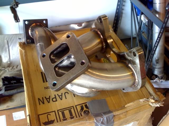

Here is what I want
Postby speedjunkie » Wed Dec 28, 2011 9:14
Except I want dual WG. This would be awesome!
However, I was thinking oil drainage might be a problem with the runners being short, and with the turbo being pushed back. Right now it's pretty much directly above the drain port and higher up. If I push it back and down, it'll be at much more of an angle and not very long. Hmmm...

I think you're going to have clearance problems dropping the turbo much more than it already is, Eric. And yes, that could lead to oil drainage issues. Luckily the EFR turbos take a small amount of oil (like most ball bearing turbos) but you may have to step up to a -12AN drainage hose to make sure it can flow freely.

Isn't that a the same design of the ebay manifold??

I'm going to look some more, but isn't this the HKS manifold? I'm wondering if whoever ran this manifold had any issues with oil draining. Rice Racing has an HKS T04Z manifold and I doubt he has oil draining issues. I can't see his pics though so I don't know if that's the same manifold haha. But this one came up with a search for the HKS manifold. I'm mainly concerned about there not being enough angle for gravity draining. I'm already running -10AN I think, I'm not sure running another size up would really be much benefit.
VRx8 wrote:Isn't that a the same design of the ebay manifold??
It's basically the same, but I think this one has shorter runners. And they look fatter too, which I would also be fine with. I had heard that long runners provide the best response, but after talking to Rice Racing, I want to go with the shortest, most direct runners possible. It makes sense to me that shorter, more direct runners would provide better response than long runners with lots of bends.

So I was looking at different manifolds and I have to say I found the one!! I want my manifold to use the same piping as the manifold shown in picture :D

To be fair, that's actually pretty crafty... I'd never show it to anyone, but..
