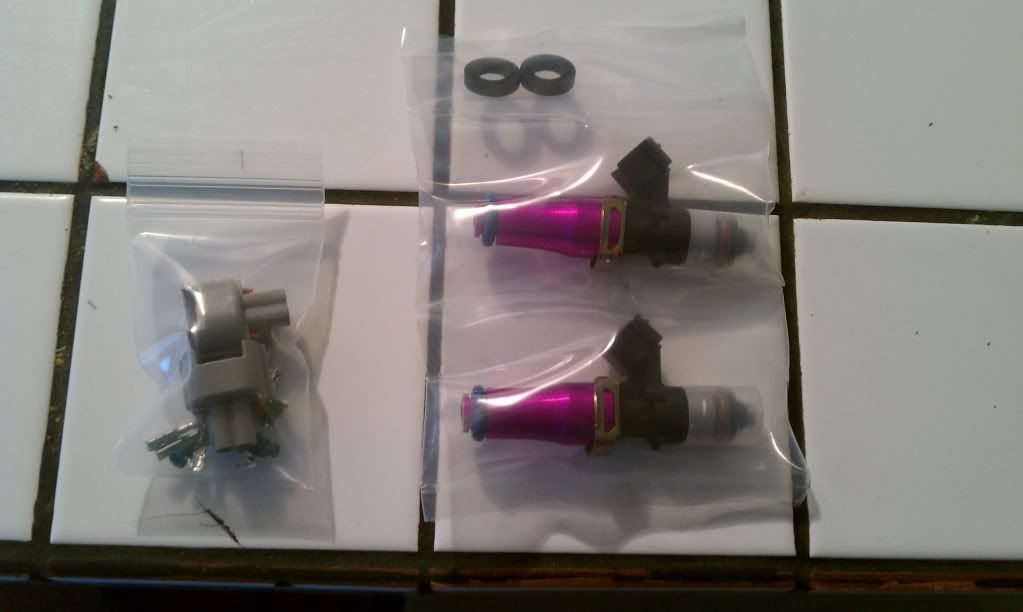

Postby VRx8 » Sun Mar 06, 2011 9:14
Got my injectors!
Postby chickenwafer » Sun Mar 06, 2011 9:14
Prudy! What size did you end up getting for primaries?
Postby VRx8 » Tue Mar 08, 2011 9:14
I'm going with 725
