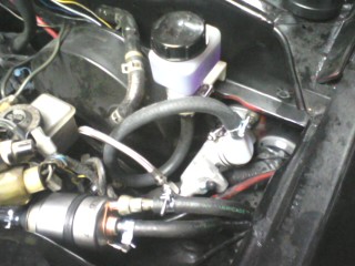

All the clutch parts are in and work great! BTW I dont know how much room is in the transmission tunnel of an F-body but when a t-56 is crammed into the chassis of an FC there isnt much room to bleed the slave cylinder... not much room for anything else either.
The master & res. fit nicely in the corner. It dose however have a MUCH stiffer pedal now.
Wilwood 7/8 master w/ DOT5
