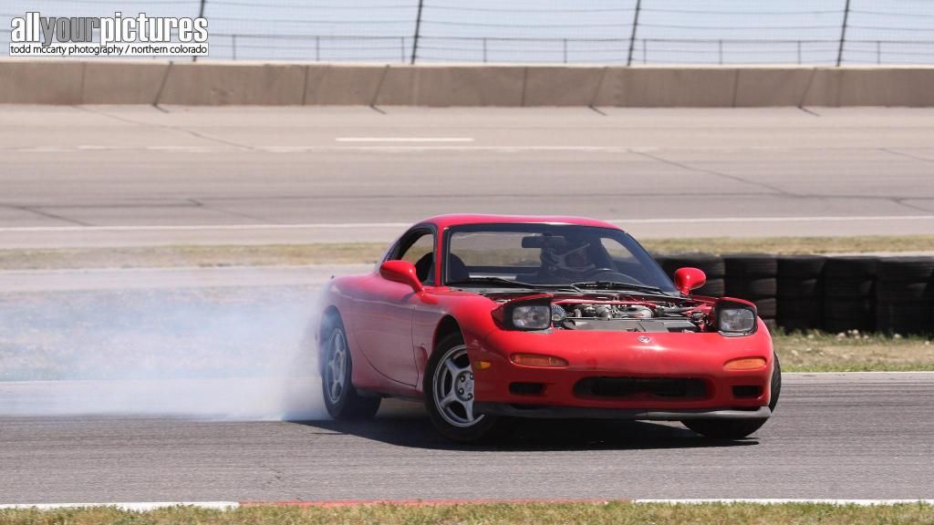

Postby 4g63<13b » Mon Jun 04, 2012 9:14
a photo from the event
Postby chickenwafer » Mon Jun 04, 2012 9:14
Legit man!
Postby RX-7 Chris » Mon Jun 04, 2012 9:14
it's so fast the hood fell off.
Postby VRx8 » Mon Jun 04, 2012 9:14
RX-7 Chris wrote:it's so fast the hood fell off.
Lol
looking good
haha thanks guys! i think i did prettty good for only driving the car for a few weeks, it was my first event ever i loved it! I took my hood off to try and keep temps down, after that event i realize i defiently need suspension and more steering angle haha but it was a great time! car didnt give me a single problem all day im really prowd of it!
