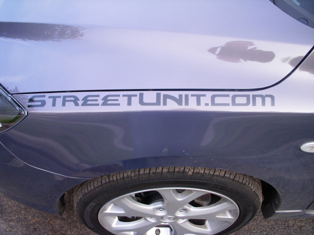

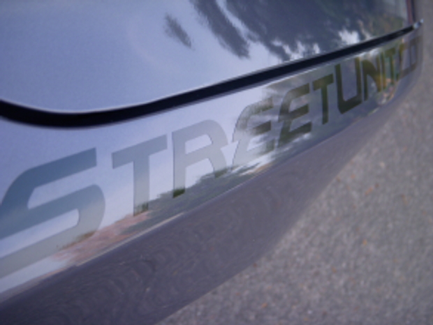

Since i now have to have these on my car to keep a sponsorship with SU.com, figured id write up a "howto" (unfortunately my camera was dead while putting these on, so no pics of process...only finished product.)
~~~This is DRY application~~~
1. Find where you want to place decal(s)
***Id suggest using masking tape to temporarily place so you can stand back and look***
2. Using Liquid Dish soap and very warm water, decontaminate entire area. Wipe clean with lint free cloth.
3. Swab whole area again with Rubbing alcohol (70% iso).
4. Wipe in one direction (to prevent re contamination) dry with lint free cloth or microfiber cloth.
5. SLOWLY apply decal, rubbing firmly with fingers, inch by inch removing the film. SLOW SLOW SLOW. Dry apps do not allow for mess ups!
6. After vynal has been applied, rub over entirety with fingers or card.
7. Alow to set for 10-15min.
8. Slowly pull at a 180 degree angle and remove the film covering the vynal decal.
