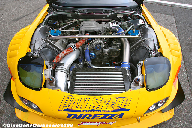

as far as flow best one i can think of is re amemiya. they use almost the same setup with the touge monster(baby blue fd) and their JGTC race car. this guy i know in texas his name is nick and has the exact setup as the touge monster on his fd. no lag whatsoever.
or you can get the same design they have on fcs. http://www.tecarts.com/photo/p02/img/03.jpg
its from the sexy knights drift car. the end tanks have a straight through and what looks like a very efficient flow. almost like the efficiency if a top mount but without the downsides of a top mount ie. heat soak

Ian, I've actually thought about the one in the link because it seems to be probably the most efficient one, but I'm not sure I'll be able to pull off the straight-out-the-back-design. I'll have more of an angle to how the IC is mounted, like it is now, and because of that I need it to come out at more of an angle going up. I'll have to do a search for the RE Amemiya one, but I'm gonna go ahead and say that it's probably UNGODLY expensive and therefore out of my range of options haha.

you need some custom intercooler piping (obviously) and youre right, the intercooler does have to be angled higher but it looks like it can be done easily. cause ive seen it done in fcs with a 13bre with the same greddy compression tube. so i would think it would work just fine.
the amemiya will cost only about $3500 for the kit. or you can go all out and build a panspeed one which is a TRUE cold air intake setup with crazy flow.
