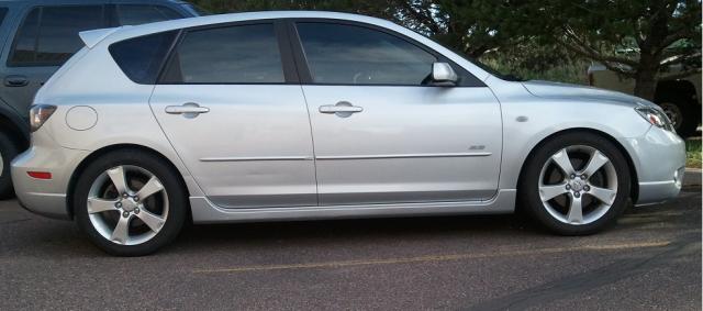

I read through a thread on the Mazda3forums site, and came away with the following settings for my Mz3 hatchback, that will be lowered on Eibach Pro Kits and have SPC camber arms (adjustable). The car is my daily driver and sees 60+ miles a day, so tire wear is imortant withplenty of spirited driving on the ramps :)
These are the settings I was thinking of asking for:
Front
Toe=1/16" total out
Camber=unadjustable, but will ask for as much as they can give me?
Cross Camber=0
Caster/Cross Caster=what is this and what does it do? Seems like it should be 0 for cross caster so both tires are even
Rear
Toe=0
Camber = Front or 2/3 of front
Cross Camber= 0
Caster/Cross Caster ?
Not sure all of those are even appllicable. What about thrust angle?
Help is appreciated. Had new tires installed a few weeks ago and the springs and arms are going on in a couple days, followed immediately by an alignement.
Thanks,
Ryan

Just heard from the shop. Saifd the car is driving nice and straight, but still getting road noise and say it is the axles being at a different angle in the front. I agree they are at a different angle to the car, but it seems like they would always be at different angles.
Said they will either wear in or break. Total toe out is 1/10" Seems excessive to me, but they say it is within spec....of course that was yesterday and I said soemthing to them about it, so maybe they brought it in a touch.
Erod, I don't know about your miata looking mean...more like a knocked kneed girl :D
